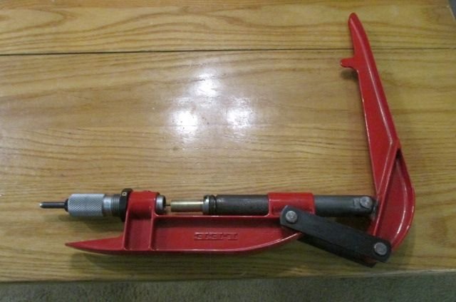

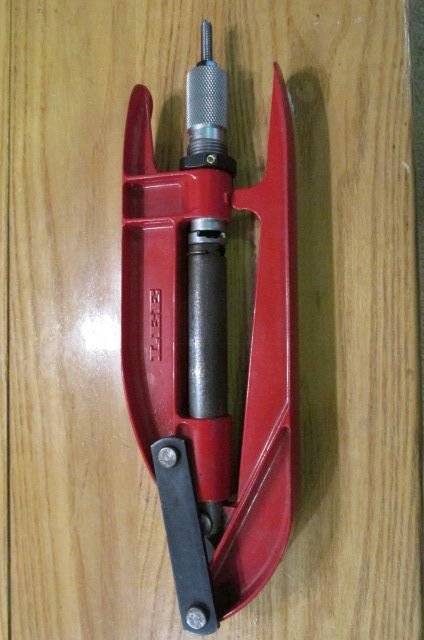

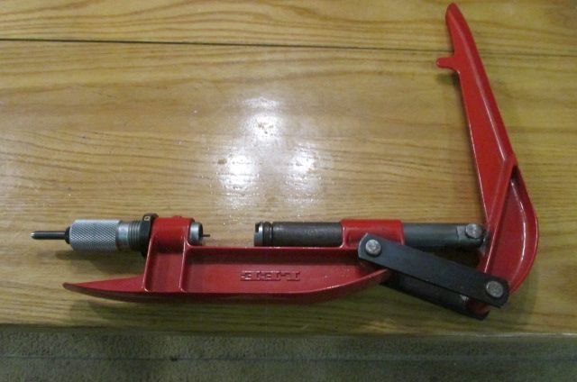

a few pictures of our RCBS Universal Depriming Die mounted in a Lee Hand Press ... while adjusting it, I used it to deprime 4 44 Mag cases .... it works and works well
200613 001 universal deprimer 002.jpg (58.71 KiB) Viewed 2705 times
200613 001 universal deprimer 004.jpg (58.83 KiB) Viewed 2705 times
200613 001 universal deprimer 001.jpg (63.41 KiB) Viewed 2705 times

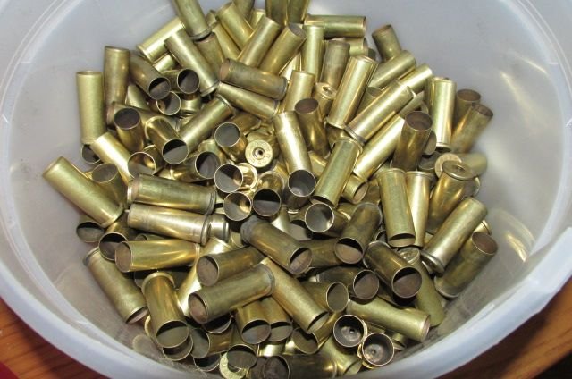

just got through depriming and cleaning the primer pockets of a bucket of 44 Mags .... once I got the Lee Hand Press and RCBS Universal Depriming Die adjusted, the process went smoothly .... as a tip for anyone thinking about using a Lee Hand Press for depriming, it works much better with Hornady shell holders than it does with RCBS shell holders .... Hornady puts a larger diameter hole in theirs .... that comes in handy with dumping old primers collected in the piston of the Lee Press
200614 001 first deprimed 001.jpg (78.52 KiB) Viewed 2689 times
