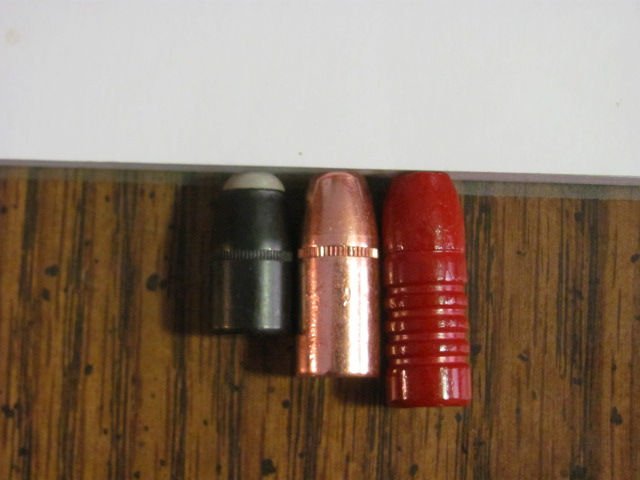

first, welcome to our forum .... delighted to have you onboard .... we load for our 45-70 .... below is a picture showing (left to right) a 300 gr Nosler Ballistic Silvertip, a 400 g Barns Buster solid, and a 500 g Acme coated cast bullet .... they are lined up to show that the length from the crimp ring to the end of bullets is the same .... we have loaded bunches of each .... they all load, fire and eject as they should .... hope this helps .... be sure to follow the link below to where you can add your Henry to our community's total
