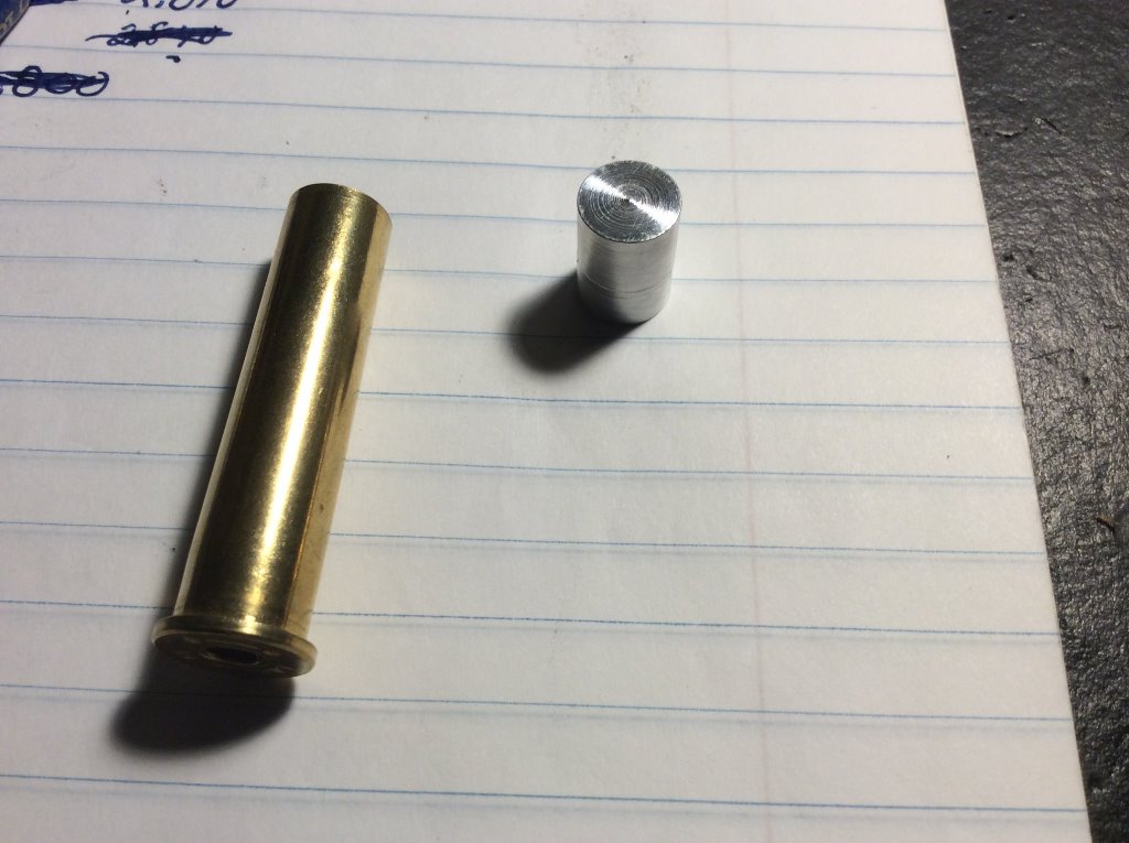

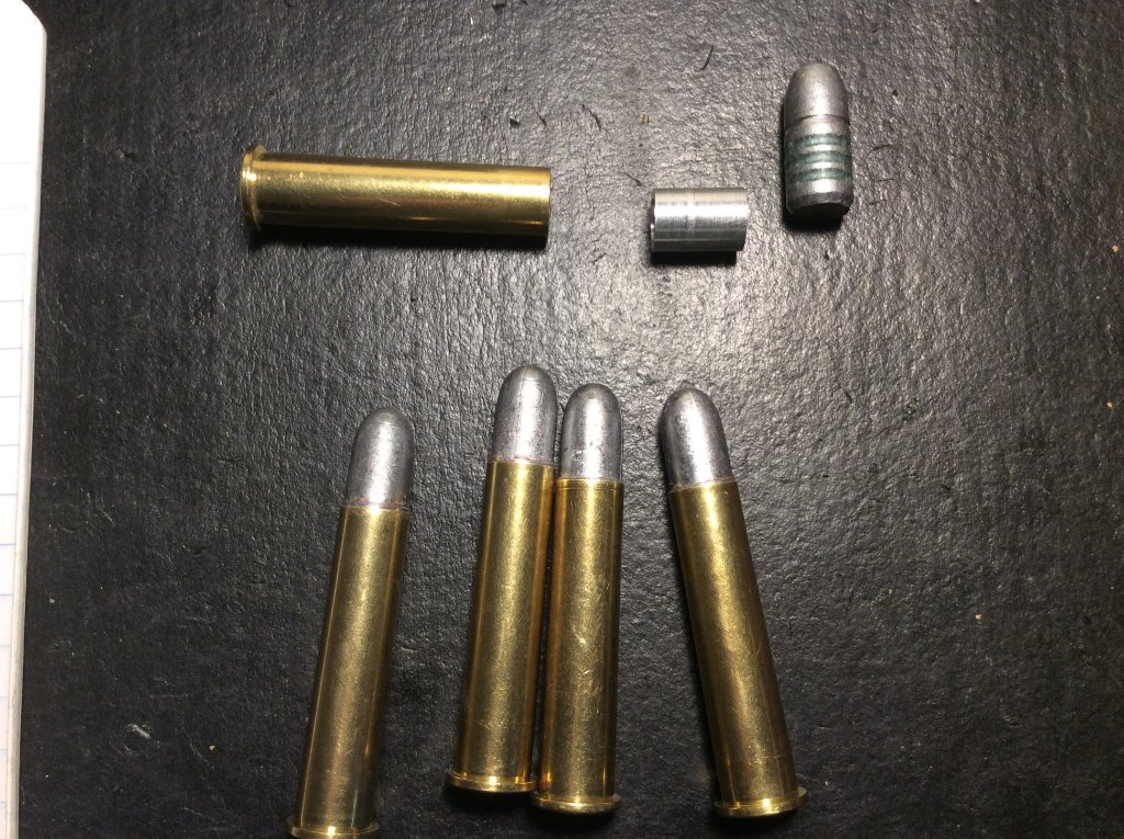

With no load data on this I had to do my homework on it as far as bullet seating depth and powder load.
Now this 500 gr. bullet has about .035 less bullet in the .45-70 case than the lighter 405 gr. bullets I load.
With Alliant Black MZ you want the bullet to be seated touching powder with maybe a slight bit of compression.

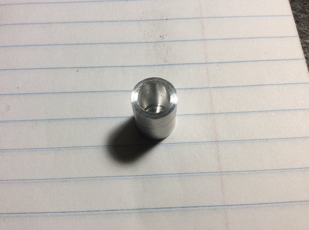

So I machined up a light weight aluminum plug gauge that just slides inside the case and will rest on top of powder.
I added a 5/16ths hole in top about .500 deep to lighten it up so as to get minimum compression....just want it so sit on top of powder.
I then get a measure of how much of gauge is sticking above case and subtract from plug's length and that gives me a seating depth with the powder charge I want to use being 50 grs.
Alliant list 49 gr. for a 405 gr. bullet like what I use so 50 gr. should work well with where this bullet needs to be seated.
Made up 20 with rest of those bullets I had and will try them out in the .45-70 High Wall.
45-70 500 gr loaded with 50 gr. Black MZ.jpg (228.34 KiB) Viewed 2339 times
top view of pliug gauge..jpg (80.08 KiB) Viewed 2340 times
aluminum plug gauge .jpg (104.25 KiB) Viewed 2341 times
