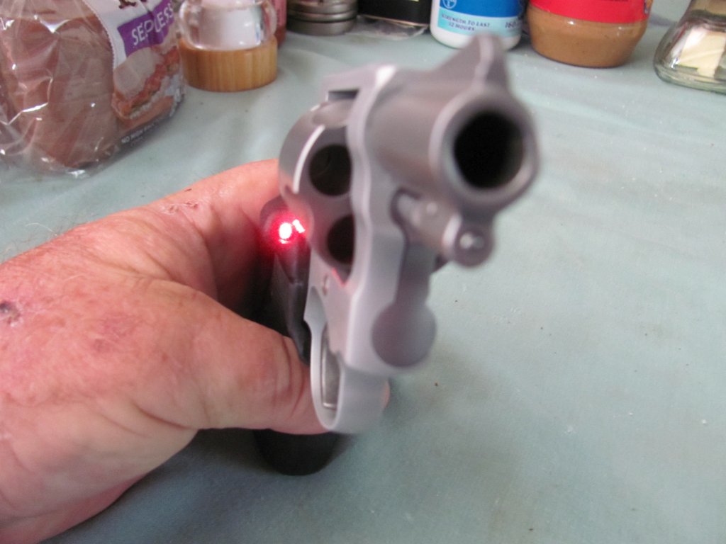

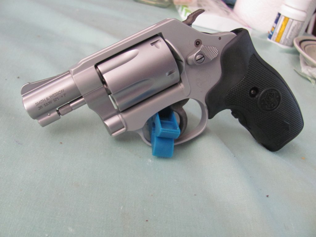

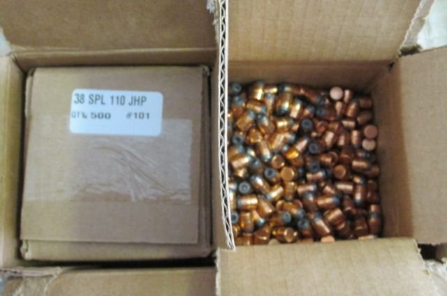

I'm in the process of trying to come up with an ultralight 38 special load for my wife's S&W J-frame .... for her, arthritis in her hands requires a round with minimal recoil .... my hope is to prefect the load this summer while in South Dakota .... it will be built using around 3 gr of Unique or Bullseye pushing a 110 gr Zero Turn JHP
160407 001 Maureen's J-Frame 002.jpg (105 KiB) Viewed 3728 times
160407 002 Crimson Trace Lazer 001.jpg (93.06 KiB) Viewed 3728 times
160407 002 Crimson Trace Lazer 002.jpg (54.36 KiB) Viewed 3728 times
190829 001 Zero Turn 110 003.jpg (56.67 KiB) Viewed 3728 times
