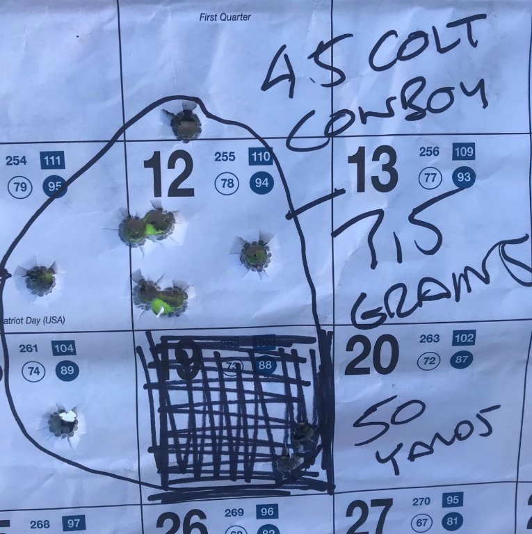

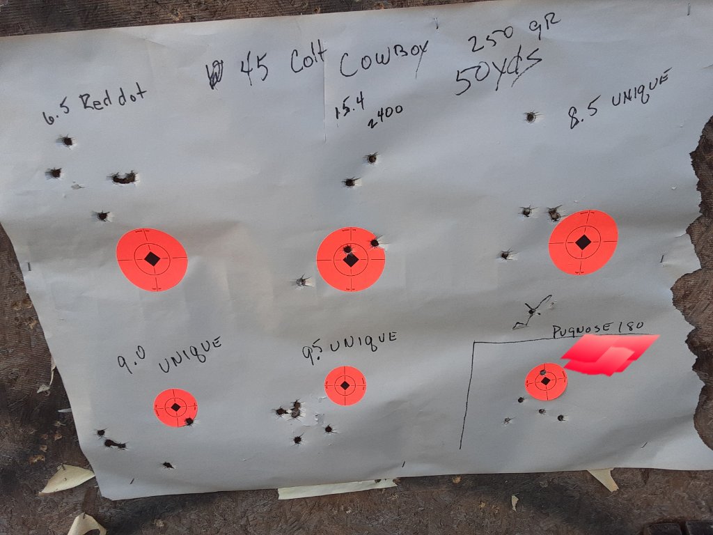

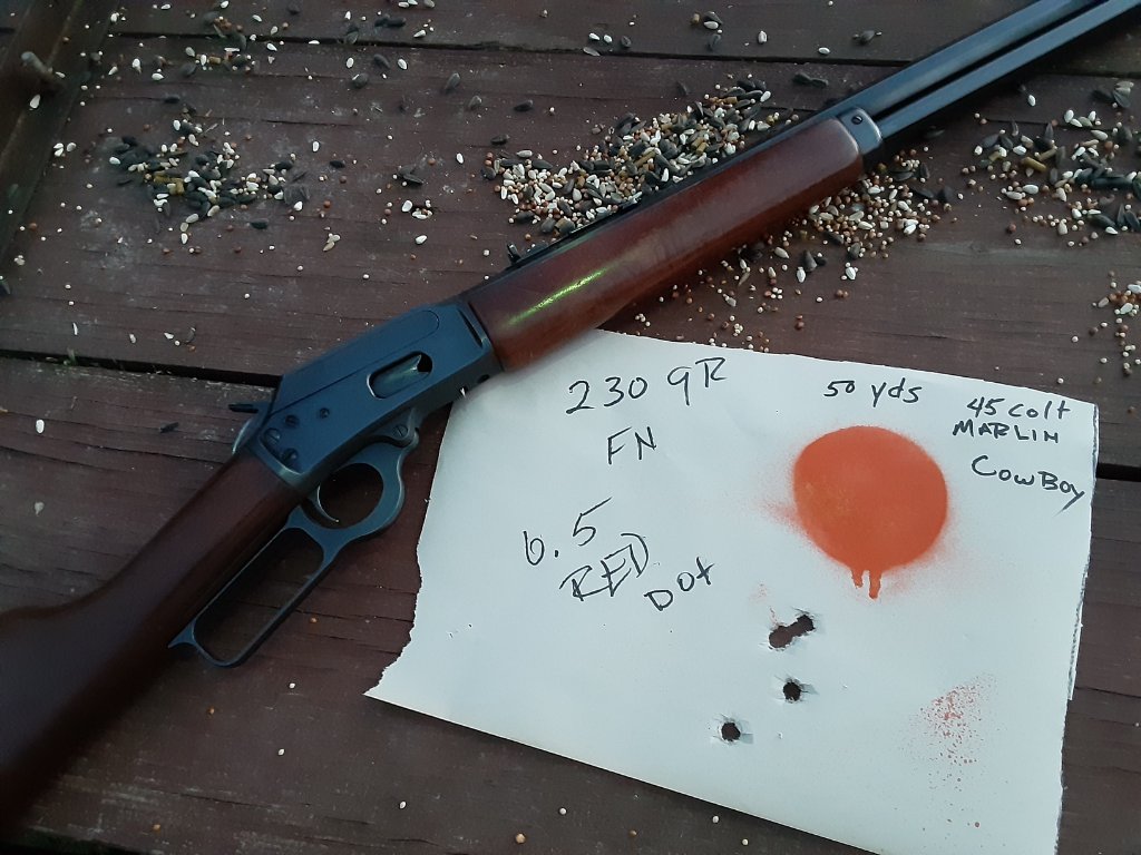

Grey hawk I tried some 2400 but never really sent a lot of time with it, I may have a pic. I will look.
I've had good results with Unique around 9.4, 9.5.
I did have a little surprise the other afternoon, I had loaded 5 rounds with 6.5 grs of Red dot and a 230 gr bullet I cast.
I do want to try some of that with these 250's.
Posts: 12159
Re: Missouri Bullets 250 grain cowboy load anyone?
Post by Vaquero » Tue Mar 31, 2020 8:27 am
Here.

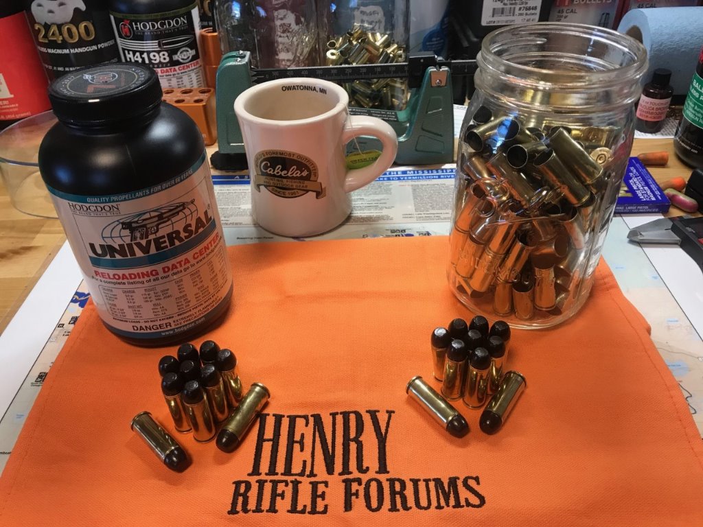

Hey, thanks everybody! I think since I have a bunch of Universal I will try that in the 7-7.5 range to start with and we will see how it goes.
Greyhawk
Posts: 422
Location: Northern Minnesota
Post by Greyhawk » Tue Mar 31, 2020 5:39 pm
After seeing these rounds I might have to git me a pair of boots and a cowboy hat!!!
On the left 7.0 grains of Universal... On the right 7.5.... Might even make it out tonight and see how they do.

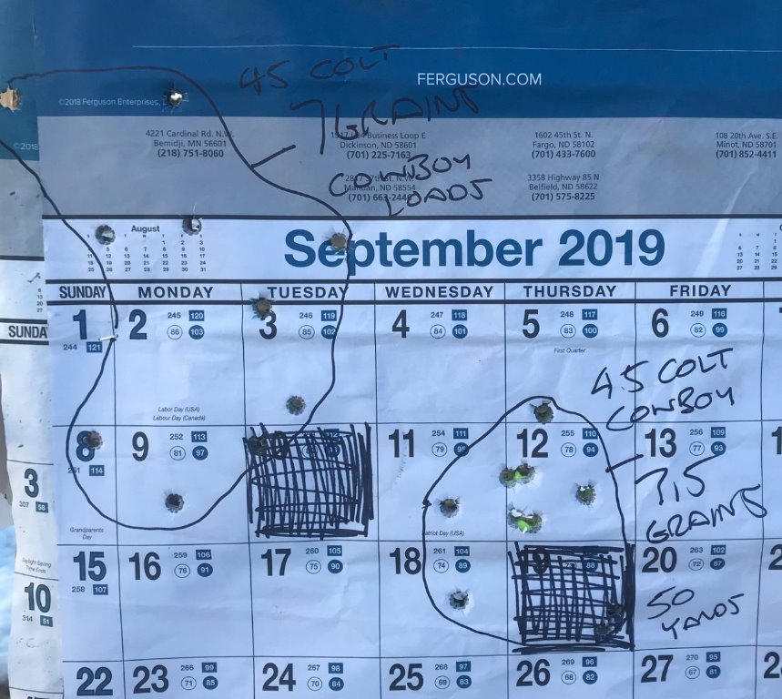

Tom, I'm not sure what the exact published load is off the top of my head, but
I do believe it is 9.0 for the max.
In my case I worked up to my load, but the last outing I had better results with 9.4.
As a side note I have a buddy that shoots a Henry BBS, and swears by a 10.0 load.
That load was confirmed by an even closer friend from FLA., that agreed with him.
Jim owned a BBS carbine, God Rest his soul.
But there are members here that have had good results with similar bullets,
and lighter loads of Unique.
They are all a little different, and to me what makes it fun and sometimes a little frustrating search'n for the right combo. ;) :lol:

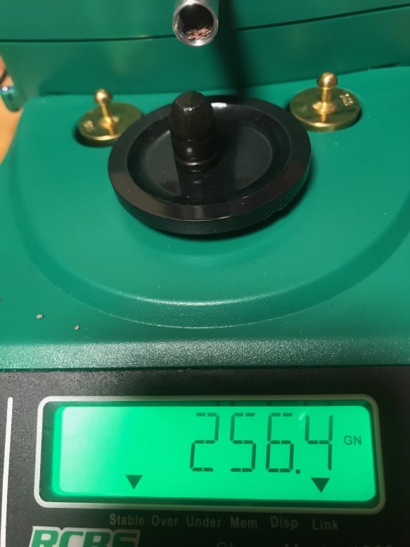

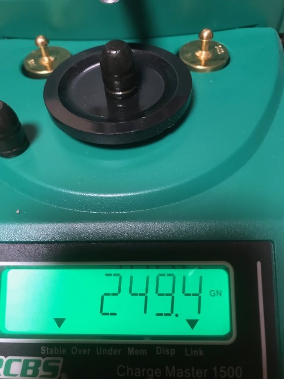

I would like to pick your guy's brains about one thing that I noticed.. While loading these twenty rounds I wondered if I had double charged a round. (I didn't) But to try to find out I first weighed each completed round... The weights were all over the map. The only thing that I could conclude is that the bullet weights are all over the map.. So I just grabbed 20 random bullets out of the box of 500 and weighed each bullet. The lightest out of the 20 was 249.4 grains and the heaviest was 256.4. That is quite a bit more of a spread than I am used to. But, hey these are just plinking loads.
But, my thought is, if I am trying to develop a good load, I should grab 10 bullets of very close to the same weight for my test loads. What if that 7 grain load just had some bullet weights that were on the far ends of the spread? What do you guys think? Or maybe at 50 yards it just wouldn't make that much of a difference.
Post by BigAl52 » Tue Mar 31, 2020 10:54 pm
One way to find out is load that load again and weight the bullets. Ive never been that concerned about it. Look at the 7.5 grain load. You really dont know what the spread was there.
Posts: 20441
Post by JEBar » Tue Mar 31, 2020 11:01 pm
7 g variation in a 250 g bullet is just under 3% .... for plinking loads and ranges, I'd say my normal wobble would have more impact
Posts: 12159
Post by Vaquero » Tue Mar 31, 2020 11:09 pm
Jim, that last statement says it all. ;)
