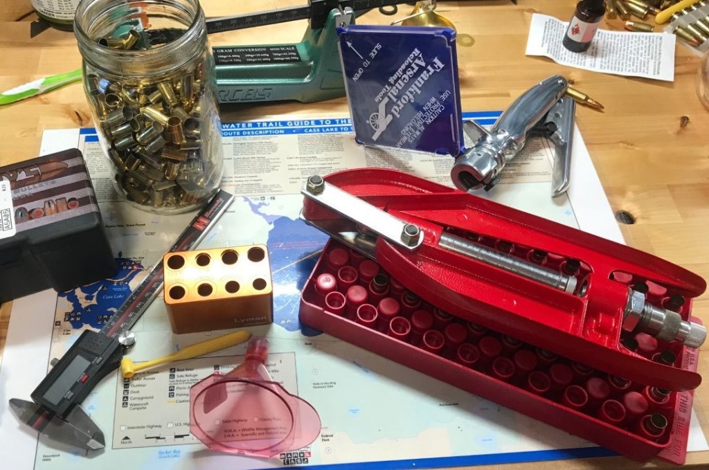

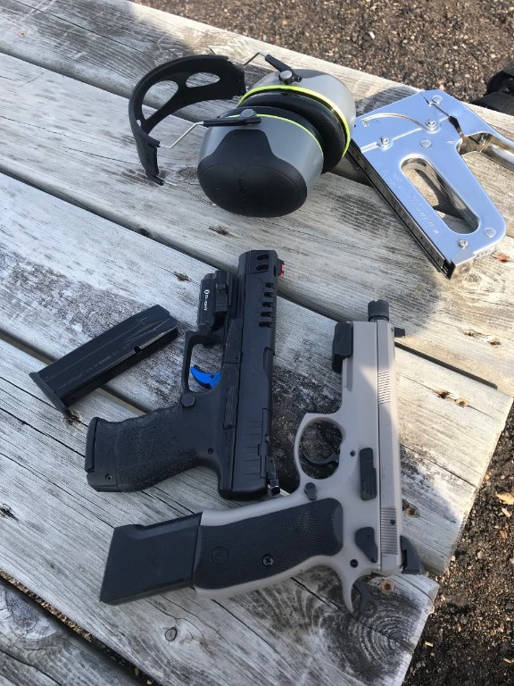

During the virus lockdown my wife and girls and I have been watching a movie each night. They are always busy with making some craft stuff, gifts, etc. So, I decided to keep myself busy too and have moved the reloading process to the living room with a portable LEE hand press set up for 9MM. It has worked out really well. The load that I have started with is Berry's flat base round nose 124 grain bullet over 4.2 grains of 231 with a COL of 1.15. I made up 20 rounds last night and took them to the range today and here are the results. 10 rounds in my CZ and 10 in my Walther from 7 yards. All cycled without a hitch. I have about 200 rounds resized and primed and ready for powder and bullets. I think that this is the load I will be sticking with.
portable setup 1.jpg (183.44 KiB) Viewed 2300 times
CZ and Walther.jpg (135.95 KiB) Viewed 2300 times
