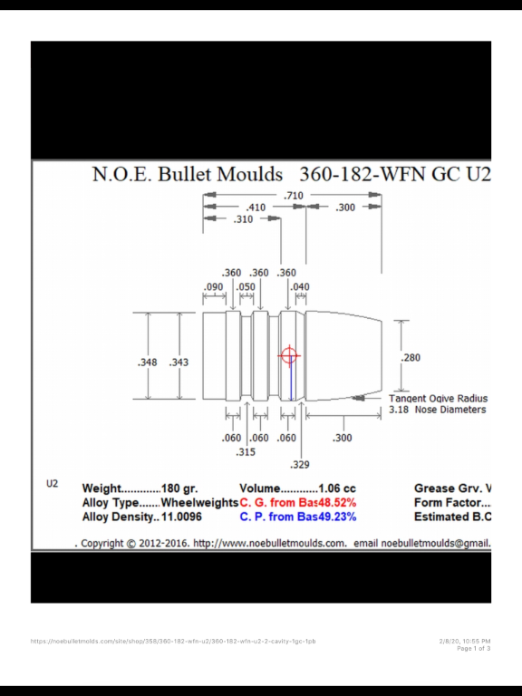

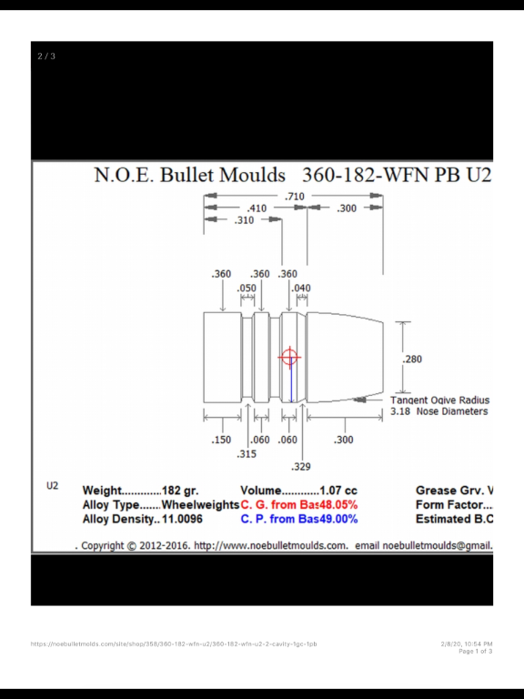

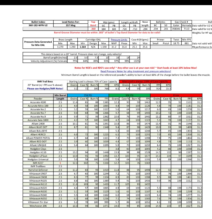

This may help some of you loading 188 grain for .357 mag. I got the mold and load card from NOE. Molds.

180 not 188 grain.
