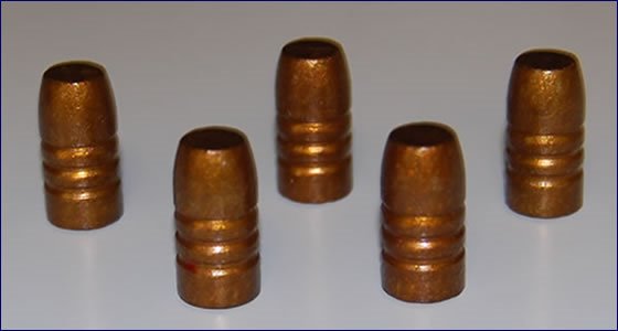

These bullets should be here Tuesday and had a thought... I have a bunch of 38 Special brass and only about 70 .357 Mag cases available to load right now since the others are loaded with 125 gr. bullets.
My thought is to seat the 180 gr. bullets to the vacant lube groove right under the crimp groove in the 38 Special cases.
This would extend the COL to close to .357 Mag length. I don't how close yet until I get the bullets.
Also this would give more volume in case for possibly the same load I will use in Mag case...if not I could back off the load a bit.
Just would like to use the 5 lb. coffee can of 38 Special cases and get similar load performance. I'm sure the new Henry BB will like to cycle those
too being close to same length as the Magnum.
What do you think?
NOTE...I don't own any .38 Special only revolvers to mix them up with and they will be labeled .357 Mag rifle only.

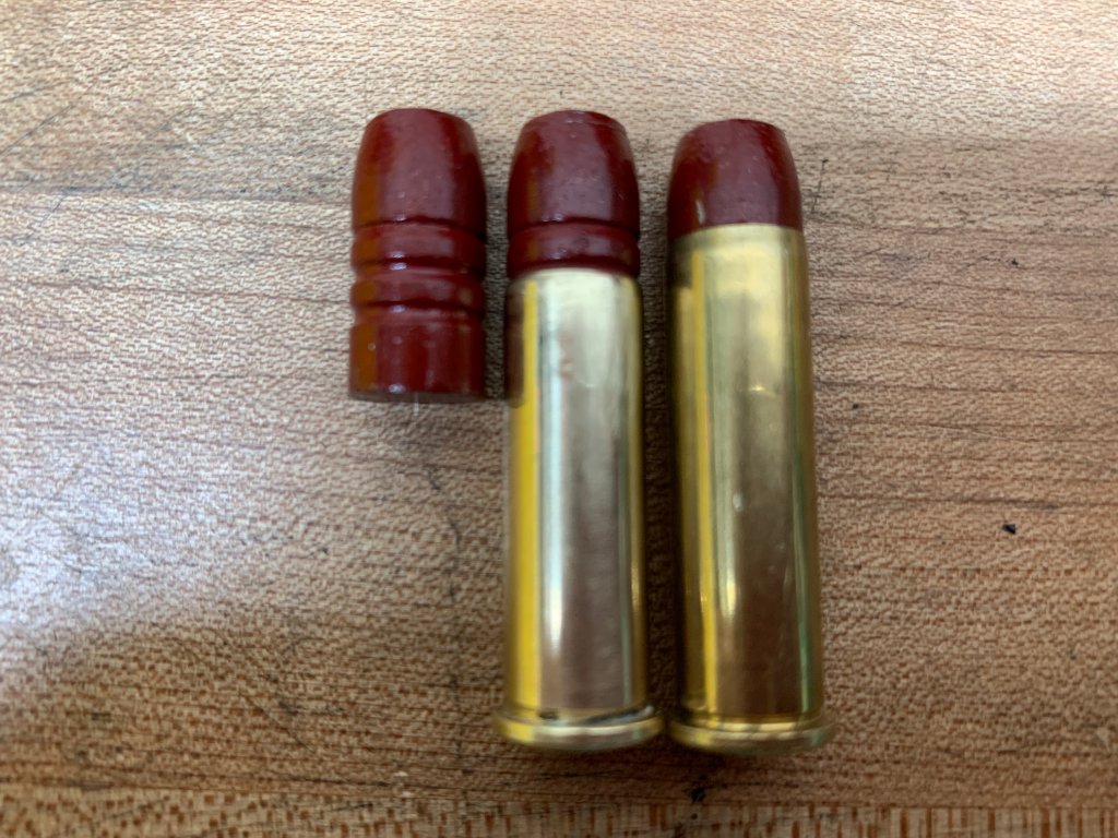

Hey Forty I made this up just for you 38 special dummy round with the Rifletom 180 here ya go. 357 on the right 38 special in the middle just to clarify things. Oh and 1.575 OAlfortyshooter wrote: ↑Sun Jan 19, 2020 8:24 pmGreat info there! Put it in my favorites. Thanks!BigAl52 wrote: ↑Sun Jan 19, 2020 11:54 amhttp://www.darkcanyon.net/MyFriend_The357.htm........

Hey now look at that and you can get a nice crimp in there too! Thanks! We have to give it a name like the .38 HR Mag
