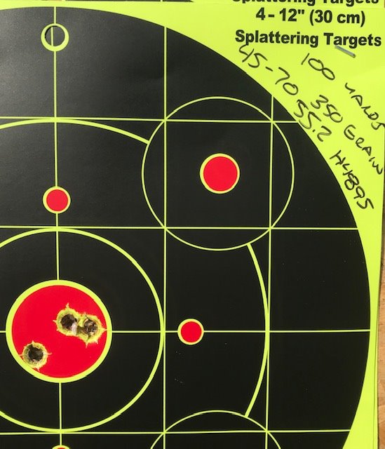

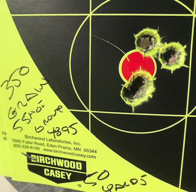

Well I'm gearing up for deer (rifle) season and I'm going to try Hornady FP 350 grain. So I went to the range yesterday with my Henry and these are the results: Starline brass, Federal primers, 350 grain Hornady flat point interlock (Item #4503) and 55.2 grains of H4895.
Nice stout, but not harsh, load to shoot. The first group is a 3 shot group at 100 yards and the second is a 5 shot group at 50.
I think the load is a keeper for my Henry.
Happy Fall!!!!

impressive results .... that should put a deer on the ground in hurry .... looking forward to your post hunt reports

If thats with iron sights Greyhawk thats great shooting for sure.

Nice, Scoped or not?
Either way, sweet, and should put meat in the freezer.

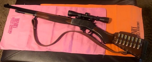

I topped it with a Leopold 2x7 scope

Good choice.
