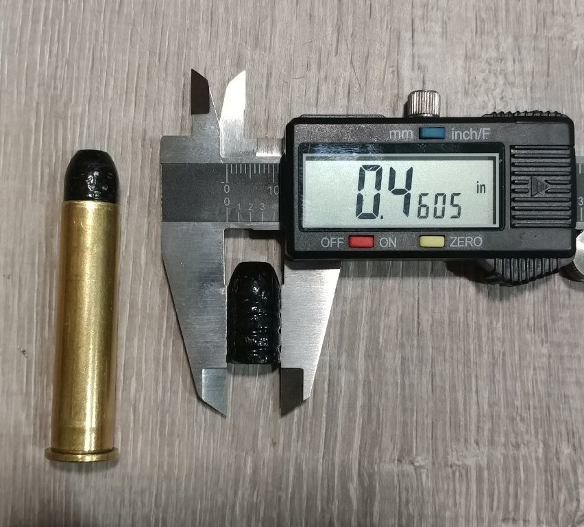

Re: hollow point version mold , main use and why not in 405gr ?
Posted: Thu Oct 03, 2019 3:01 pm
by BruniX
@garyfan
very nice mold !
.460 , it is 11,6078 mm....
is it for the 45-70 :?:
45-70 is often .457...
Posted: Thu Oct 03, 2019 5:37 pm
by GaHenryFan
@garyfan
very nice mold !
.460 cast is all I shoot in my Marlin 1895g. It's very accurate with them too.
Posted: Fri Oct 04, 2019 4:14 am
by 220
I have a NOE 405 WFP it throws 370gr as a HP. my marlin loves them, works well on game as well.
Posted: Fri Oct 04, 2019 11:24 am
by GaHenryFan
BruniX wrote:
Thu Oct 03, 2019 11:48 pm
ok !
do you use a sizing die ? from Noe h or other ?
I have not found sizing to be necessarily. My Lee mold drops them around 458 and they are 460 after powder coating. They chamber and shoot great for me.
Posted: Fri Oct 04, 2019 2:30 pm
by BruniX
interesting !
do you have take mesure of barrel before ?, is it necessary, or direct test chamber ?
the mold (C460-429-RF-BA2-106) seems to be very cool...
do you think that the gas check is important, in 45-70, allows it to gain in velocity ?
I know that on 357 magnum for example, it's essential, but on the 45-70, I do not know...
thanks, gahenryfan !
Posted: Fri Oct 04, 2019 5:16 pm
by GaHenryFan
interesting !
My barrel slugs exactly .458, but the .460 bullets work fine. I cast with fairly soft lead (cowboy action range scrap) and powder coat everything, so I don't use gas checks. I rarely load anything over 1200fps.
