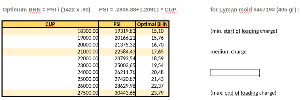

After reading article on this site, i had made some calculation
MBC Formula is : Optimum BHN = PSI / (1422 x .90)

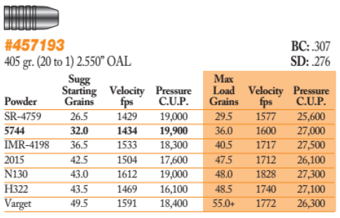

As I use 405 Gr (45-70 gvt) bullet from Lyman mold 457193, and powered by IMR 4198 powder,
we have this in reloading table:
lyman 457193.png (82.89 KiB) Viewed 921 times
Lyman give pressure value in CUP; but correlation whith brinell hardness is in PSI/
Lot of people say that there is no correlation between this to method of hardness test , but there is one :
excellent document about this, from denton bramwell:
https://www.shootingsoftware.com/ftp/psicuparticle2.pdf

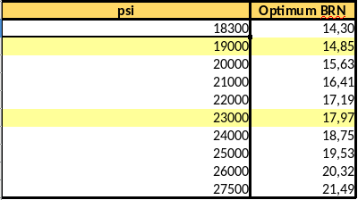

So, from 18300 PSI to 27500 PSI with MBC Formula :
brn from psi from cup.png (95.82 KiB) Viewed 913 times
It is the reason why i had make some cast bullet in brn 15, and i will make the more of them in brn 18, to use a medium charge of powder, because i don't need max power to make holes in paper :lol:
brn for psi.png (21.22 KiB) Viewed 921 times
