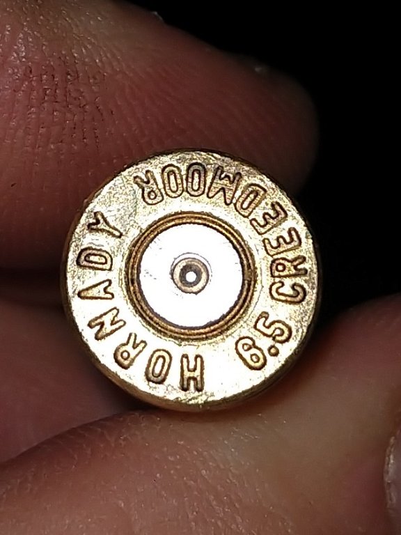

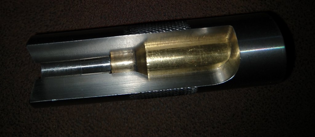

Spent a few minutes shooting today
Did some at 41.5 gr of h4350 and 41.8 gr of h4350 with the 143 gr eldx bullets.
Notice some very faint pressure signs with the 41.8gr load on the extractor mark on the butt of the case.
Have a picture but i cant upload now due to the site changes.
Not worried about the pressure signs but i dont think i will bother going above 41.5gr.
Cases are reliably stretching to 1.92+- .002 from 1.912

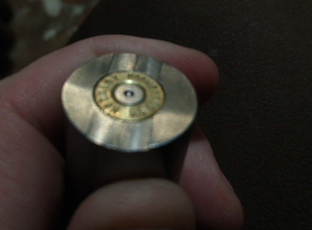

Me78569
Posts: 42
Joined: Fri Apr 12, 2019 6:08 pm
Re: Reloading 6.5 long ranger
Post by Me78569 » Wed May 08, 2019 10:55 pm
Here are the images of the post fire cases.
Ejector mark
Case gauge

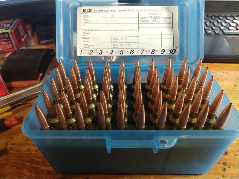

Post by Me78569 » Fri May 17, 2019 1:40 pm

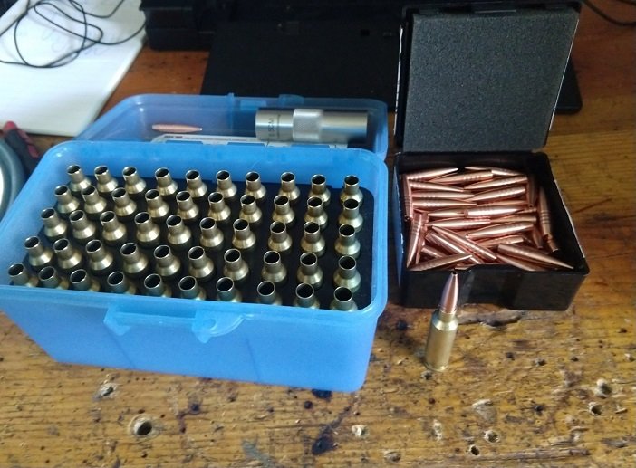

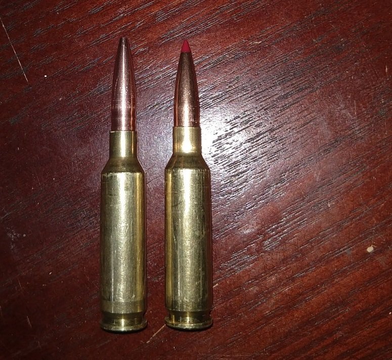

I got a little bored so I decided to try out some new bullets. I wanted to look at some all Copper rounds for hunting rather than the ELDX. I could have tried some of the GMX bullets or Barnes ttsx but I really liked the name of "hammer bullets" :lol: Dumb I know, but my wife just rolls her eyes and says " whatever you want honey". At least the guy that makes the bullets is a good dude so I don't feel bad supporting him.
Anyways the ballastics on the 124gr Hammer hunters at 2900-3000ftp is pretty much on par with the ELDX 2600-2700 fps out to 500yds then tapers slowly from there. The Damage the Hammer bullets do without peppering the animal with lead is pretty awesome.

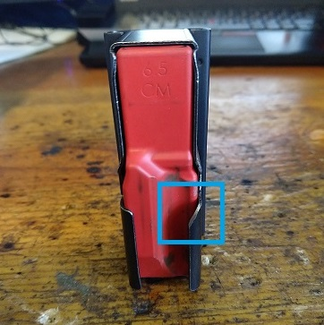

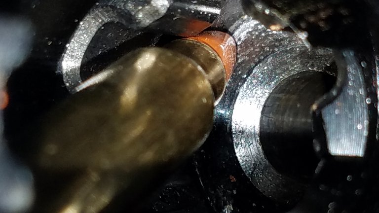

I took some time last night to figure out the max COAL until I hit the lands with some Hammer Hunter 124gr's. Looks like I could in theory load out to 2.8900" before hitting the lands. However I was having feeding issues above ~2.825" on only the last bullet in the mag. After looking closer I found that the nose of the bullet was not able to move foward enough to pop up before jamming into the reciever lug.
Easy Solution was to file off the corner of the right side of the mag. This allowed the bullet to pup up easier and it feeds like butter now all the way out to 2.89"
Ended up giving .030" with a COAL of 2.86"
Got my loads setup in .3 gr increments from 41.5 to 45 of h4350. I am guessing I will be pulling bullets at 44.7 and 45 gr, but we will see.

Post by Me78569 » Wed Jul 10, 2019 10:18 am
I was finally able to get out to the range a few times.
had rounds worked up with the 124 gr HH using h4350. Ended up running into pressure signs at 43.2 gr, velocity at 42.9 was 2939
next I loaded some ramshot hunter from 43 to 46 gr, ran into slight pressure issues at 45.1. 44.8 gr produced 2892 fps
I worked up some new loads with h4350 that I will try out next trip with h4350 from 42gr to 43 gr by .2 increments to try and find a good setup.
