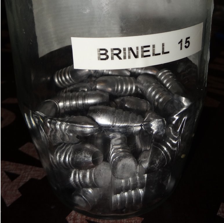

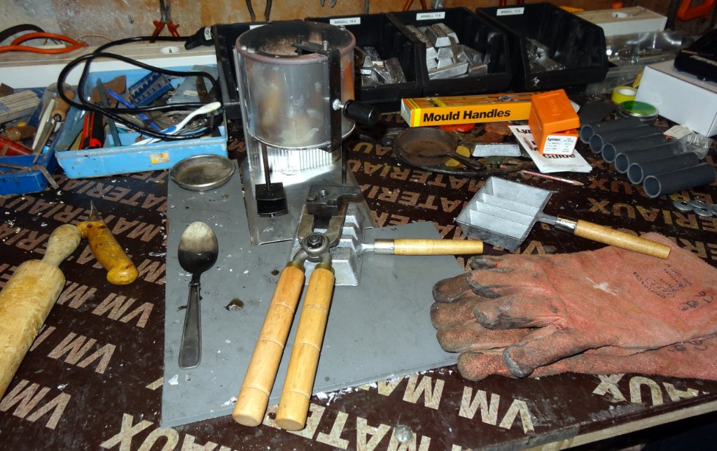

Today , casting 60 bullets in brinell 15.
I think that it is a medium hardness , it's probably good to shoot , i will verify later, when i receive carbine :D

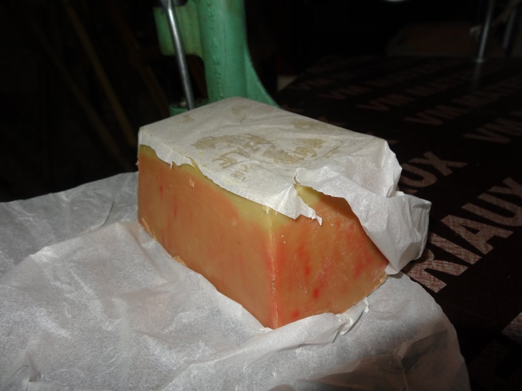

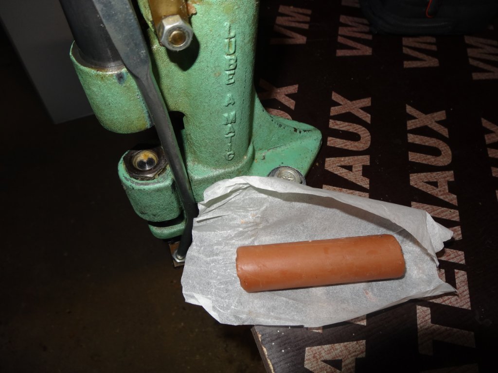

at the same time, the molding of a 10 sticks to feed the rcbs lube-a-matic,
and the molding of wax bars and grease for later use (15 pounds) ...

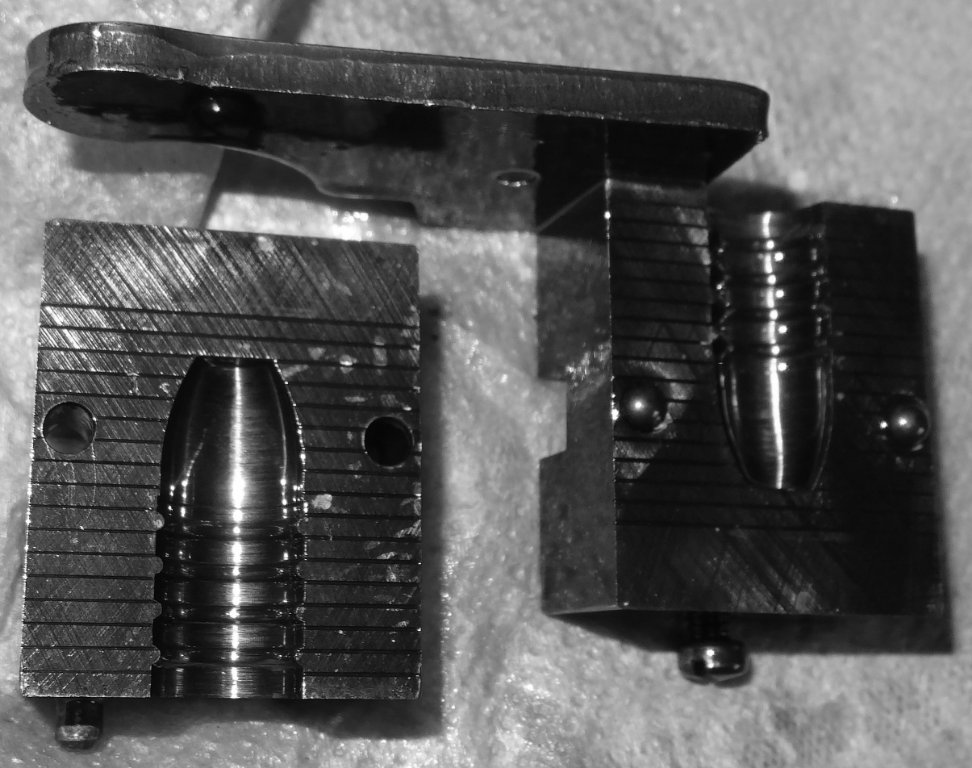

the modl is degrased before every use, and greased after ...

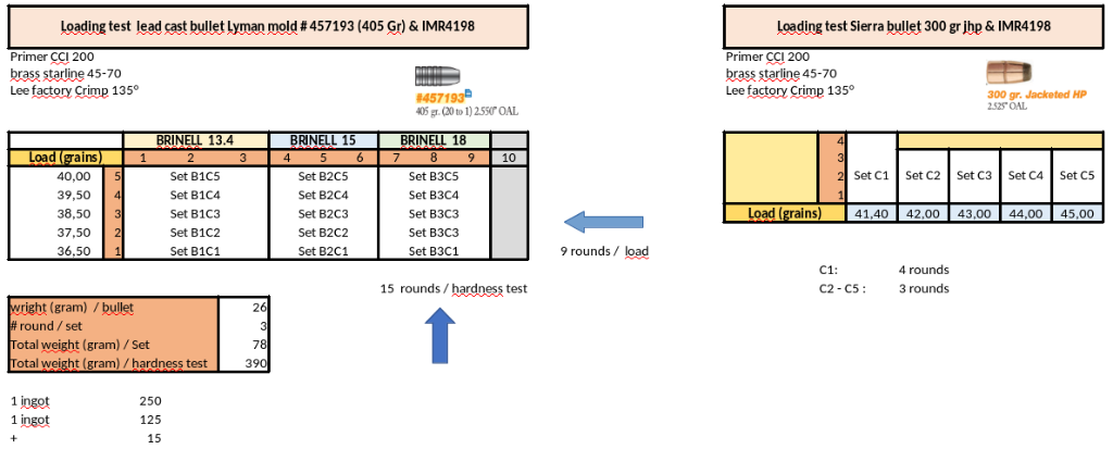

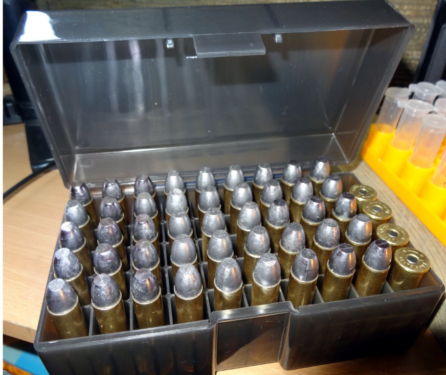

Two test set are finished, lead and jacketed
round set.JPG (140.28 KiB) Viewed 2739 times
reload data.png (111.04 KiB) Viewed 2739 times

when i have done the tests with the hardnesses and loads, then i will reload all the brass and bullets with the most suitable charge, and will cast all the lead alloy to the good hardness.
The idea is to have 50 rounds every week to shoot at the range, at en affordable cost (versus the caliber)
the casting bench
casting bench.JPG (189.86 KiB) Viewed 2739 times

looks good, hope you get the rifle in soon. I think you will be happy with the brass receiver, mighty classy looking rifle. those reloads look like they will do the job
Ramjet
Re: 45-70 cast lead bullet
Post by Ramjet » Mon Apr 08, 2019 3:40 pm
Those will be just perfect for the big 45-70 the hardness is good for the pressure you are shooting.
