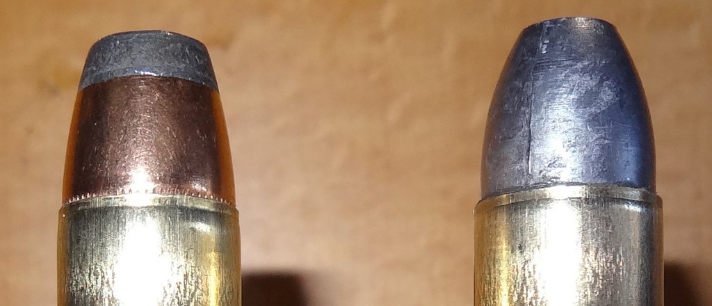

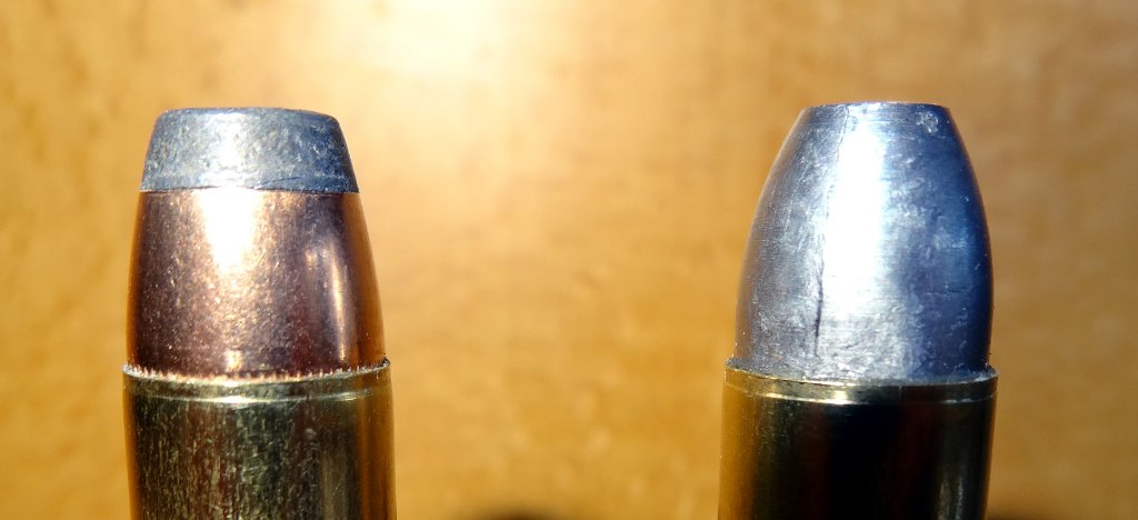

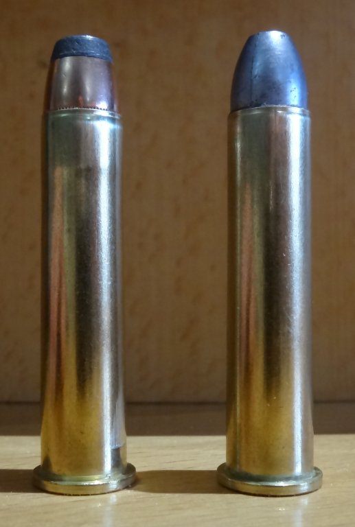

Post by BruniX » Tue Apr 02, 2019 2:27 pm
last step, i have crimped all round, jacketed or full lead.
I hope it's enough, i have done a light crimping to start .
(half turn on lee crimp factory tool)
what do you think of that ? (stress of beginner :mrgreen: )

Half a turn is plenty.
They look good to me.

Plenty of crimp on those

BigAl52 wrote:Plenty of crimp on those
too much , you think ?

I load at Trapdoor levels so a quarter turn is what I use.
I'm also all about 45-70 case life so I work the case as little as I can get away with.

that crimp looks good and should be fine for full power loads ..... it will most certainly work for lighter loads but you might be able to back off a bit for lighter loads

Im not sure what youre loads are there but like Jim says plenty if those are full power loads.

It's my understanding that lever gun bullets (hand gun also?)are crimped to prevent the bullet from being pushed further into the case from recoil. So getting the case below that front edge of the cannellure is the goal.
A half turn is not over doing it for heavier loads.

IMHO you should back off the crimp, especially with the cast bullet, just a very light is all that is needed. I usually do not use a heavy crimp in my 45-70 loads and agree with others, work the brass as little as possible.
