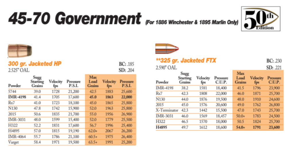

i can't tell you if is it sure, but sierre bullet seem's very similar, and it is 300gr jhp ....
i have bought 150 bullet like this and it was possible to me find 2 pound of imr 4198 in shop (now it is not possible in Europe , this powder is no more imported :x GRRRR !)
According to lyman, it is IMR 4198 that give better results with sierra 300gr ....
i have not tested yet, because waiting my henry 45-70 !
sierra 300 gr 45-70 reload data.png (290.16 KiB) Viewed 2300 times
see y soon...

Tad I used the Nosler bullet with the 4198 got great groups at the low end around 41 to 42 grains of it. Mine was out of the All Weather model. I know thats not the queston you asked but its a FYI comment.

H4198 works great with wide variety of .458 guns 45-70 Marlin Level loads the 458 SOCOM and the 450 Marlin very consistent low SD in velocity and one of the best I have used for the 300 grain HP bullets. Start with the low end work your way up and you will find the sweet spot for your COL and brass and primers.
