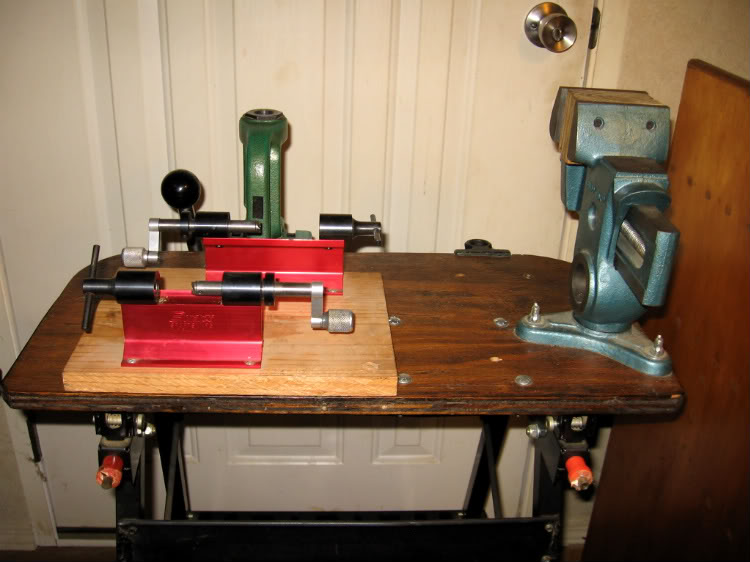

I put a top on a work mate and I been ammo on it for about 30 years . So I could watch TV in ac . My lube sizer for lube bullets and shotgun loader bolts on and off this table and it folds up . I have a big work bench in the garage I never use . I have more pic if you want to see them .

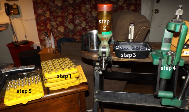

Here is more pics
