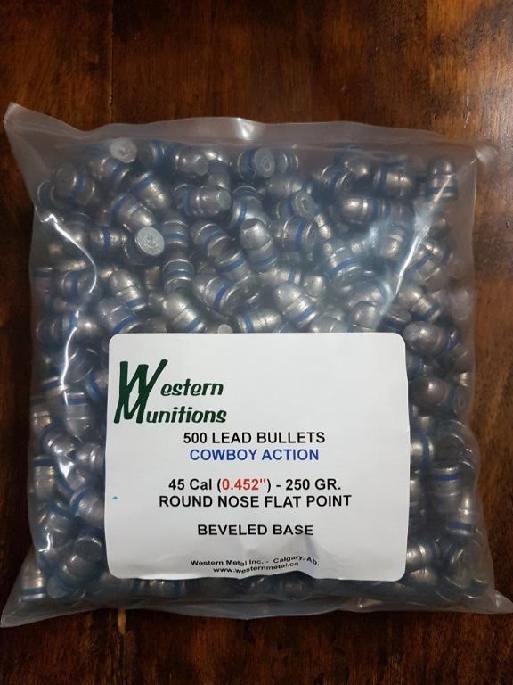

Those shooting lead bullets: do you lube them?
Mistered
Re: RanchRoper's Reloading Ruminations
If purchased they will be lubed.Those shooting lead bullets: do you lube them?
Avoid plain lead - go with plated.
I have 2 bags of these. Have not opened yet. But this is what I shoot with their reloads, and have shot several hundred with no issue in my barrel. So should be ok I guess.
- 1a.jpg (99.68 KiB) Viewed 2484 times
Mistered
Oh yea - see the blue line - thats the lube.So should be ok I guess.
Some guns shoot lead better than others. A lot can depend on the load as well.
