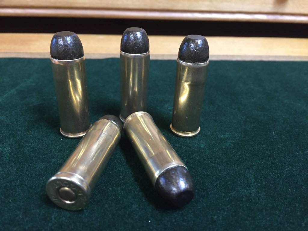

Rifletom and I have been comparing notes and sharing our progress as we sort of "parallel path" our way to our first 45 Colt reloads. We've both settled on 250 gr Missouri Bullet "Hy Tek" coated lead projectiles and Unique.
I followed Tom's lead and am starting with about 20 ea. @ 8.0 gr of Unique and 20 ea @ 9.0.
Here are 5 "warm-up" rounds that are somewhere in the middle (8.5-8.8), just to get the rifle sighted in (+/-).
Maybe later this week, depending on 1) when the Lyman globe sight shows up; and 2) how long it takes to get back in the saddle after Wednesday's cataract surgery.
45 Colt 1st reloads 1-27-19 002.JPG (125.38 KiB) Viewed 2122 times

Looks good to me. I can't get my head around reloading yet.

Well, as good as you are shooting factory ammo, it's hard to make an argument that you'd get more accurate results, but it took me a long time to get my head around it, too.
But, it's fun and interesting and just extends the hobby for me. Even though you have to stick to a "recipe" when it's all said and done, there is still an element of creativity to it, as well. Hard to describe that, but there's always the element of "let's try this" that doesn't have to be risky or dangerous.
The bug may never bite you, but it's been very fulfilling for me, thanks in large part to the advice I've received here!

Evan, I hadn't seen those pictures you posted Fri, as I was gone all day Fri and most of Sat. That is a splendid looking rifle! Very nice. I'm going to try and go to the range today or tomorrow for some Colt testing. Hopefully. Good luck on your surgery and take it easy. Your loads look good. Note comparison's coming up.

ESquared wrote:Rifletom and I have been comparing notes and sharing our progress as we sort of "parallel path" our way to our first 45 Colt reloads. We've both settled on 250 gr Missouri Bullet "Hy Tek" coated lead projectiles and Unique.
Those coated MB bullets work very well in my .44 Mag carbine...240 gr, with 9 gr. of Unique.
For .45 Colt in my 1873 Winchester rifle I load the 250 gr. hard cast with 8-9 gr. Unique.
