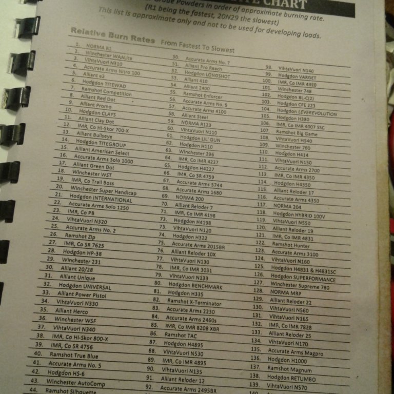

Unique gunpowder's burn rate may be too fast for jacketed bullets fired through a barrel longer than 8-3/8". I would try slower burning gun powder for loading .357 cartridges to be fired in a rifle.

ESquared, for powder recommendations, I'd stick to the manuals first from bullet manufacturers, then from powder manufacturers for reliable load data. However, this chart will give you some information about fastest to slowest burning powders that may or may not be helpful.ESquared wrote:Can anyone give me 2-3 examples of what specific powder would be in this "slower burning" category and might therefore be more suitable for these 110 gr XTPs?
https://www.bevfitchett.us/ballistics/t ... chart.html

Not the sharpest picture but it can be read.
Re: 110 Gr 357 "Plinkers" Just About to Give Up!
Thanks for both of those above. The Lyman manual point to Alliant 2400 as the most accurate, actually. Now I need to cross reference the other 357 loads, and the other calibers I'll be loading to see if there's any other call for 2400. Doesn't seem to make sense to buy powder to shoot a finite number of free bullets but then have no other use for it, huh?
