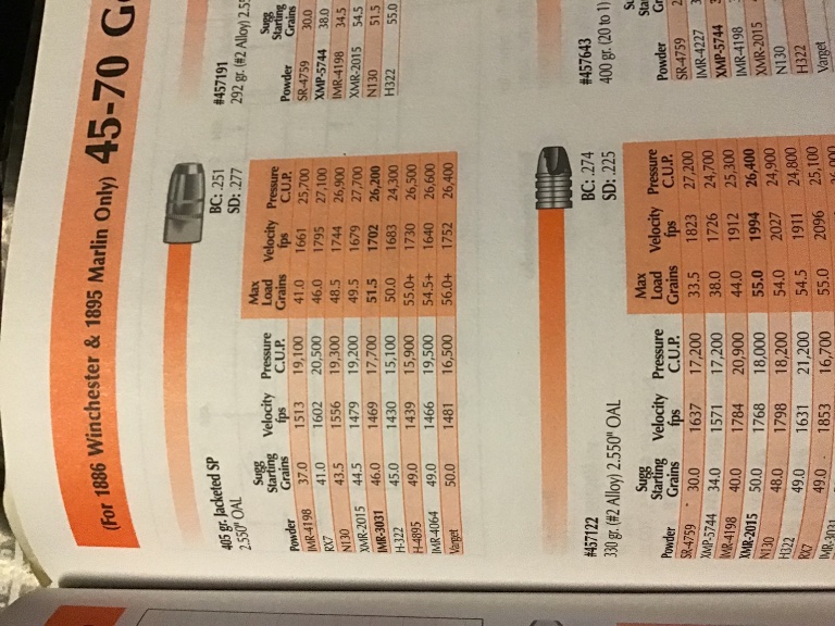

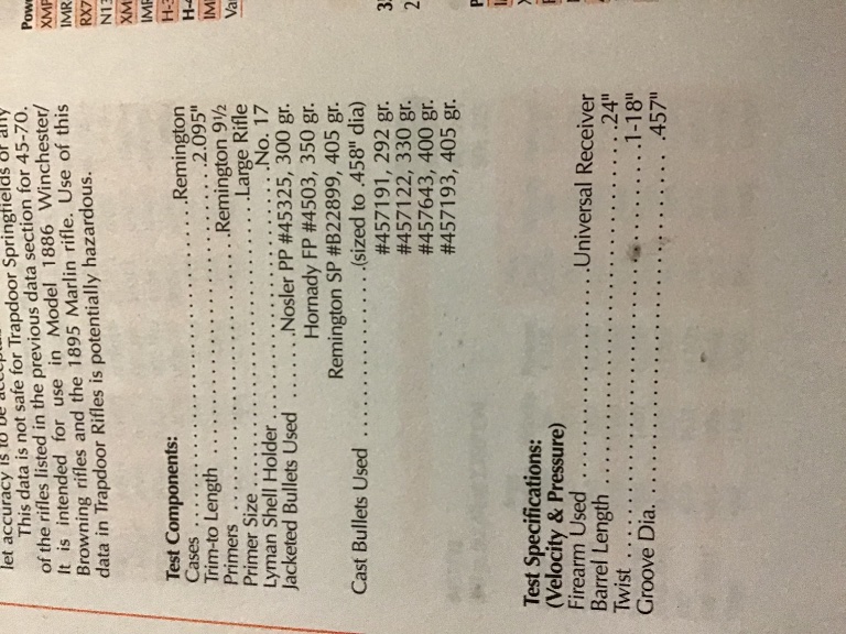

Re: Heavier bullet load and goal...
From the Lyman 49th

Jdl447 wrote:From the Lyman 49th /quote]
thanks , Lyman seems very intresting !

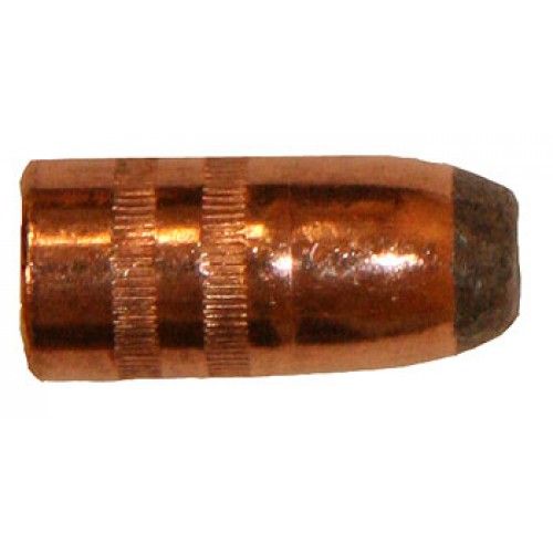

this is the bullet i have seen :
i think it"s the standard bullet of remington core lokt, or remington express riffle... ?
I am interested because for my first tests of reloading, these balls are among the cheapest and as it requires less powder, it also reduces the price of ammunition ...
