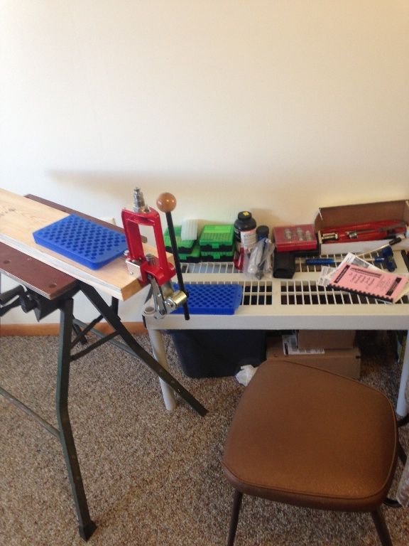

My new setup. I ordered the Lee single stage press. Still working with minimal space due to small apartment.
After about 500 rounds with the hand press, I decided to upgrade. The hand press is now set up for decapping. Latest batch of cleaned brass is drying.
My early loads were an assortment of loads using 2400. I will post the shooting results in the range reports.
I am now loading H110 with Zero 158 grn HP. I started medium high with this.
I hope to get out to try them soon.

Cofisher wrote:My new setup. I ordered the Lee single stage press. Still working with minimal space due to small apartment.
If you haven't done it already (I can't tell from the photo), you will find the quick change bushings for the Lee single stage will make a huge difference. They just pop in and out without the need for adjustments.

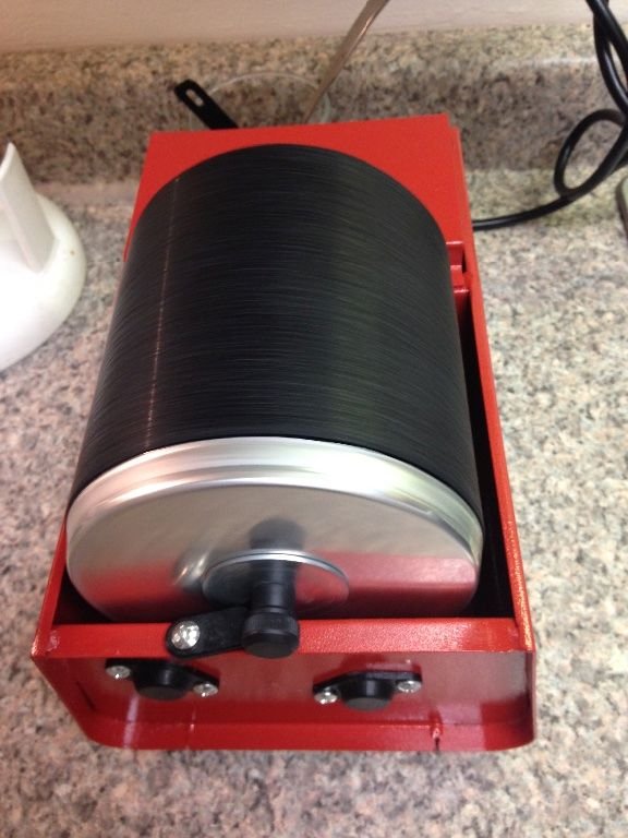

Great job getting it set up to your liking! It's fun diving into a new hobby like this. My Harbor Freight rock tumbler is churning away right now with my first load of 357 decapped, dirty cartridges.
The "recipe" is about a pound of brass, a pound of stainless steel tumbling pins and a pound of hot water with a squirt of Dawn and lemon juice.
Will give it a couple hours (+) and see how they look.
