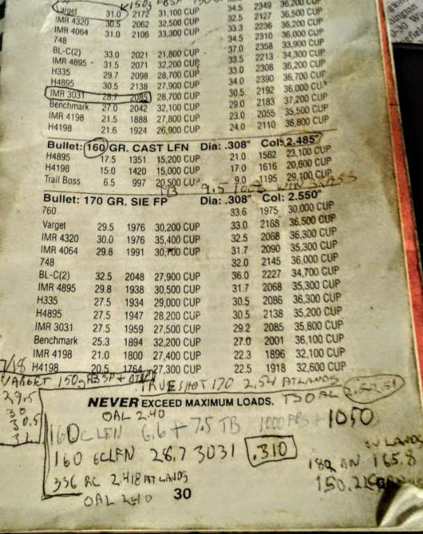

Just going through my load books. One thought leads to another and pretty soon I have most of them out.
Made me remember to say that keeping notes is important.
I write mine in my books.
