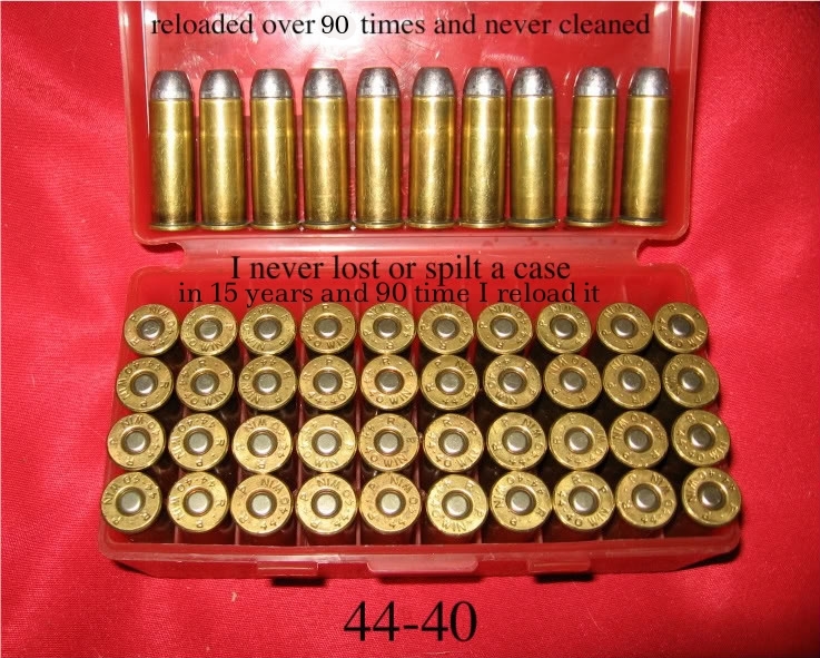

1st thing 1st you should never shoot cast bullet and jacket bullet in the same gun and expect it not to lead up the barrel . Lead sticks to copper fouling and that is a fact .... Brass thickness don't control the life of the brass , you do . No one make brass for jacket bullets and another for cast bullets .I've never seen a box marked lead bullets only . Check your brass length ... If one is too long the crimp will wrinkle the brass . If the brass is too short it will not flare brass correctly and the bullet will crush the brass when seating it . I use a Lyman M-die for all my cast bullet .
