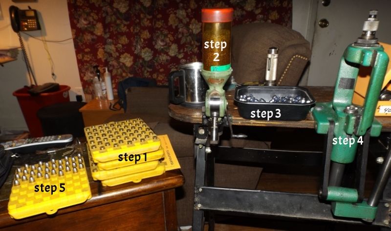

I prepare all my brass for powder . note step 1 the primers are up and brass is empty waiting for powder . I complete step 1 , 2 , 3 , 4 and 5 on each round before moving to the next round . After everything is load and complete . I taper or roll crimp by it self is my last step because I like to feel it , a lot of problems can be detected that you could have missed earlier .

Thanks, I'm trying to do the same. I do all cases in one step. Then move to the next step and do all cases and so on. I use different bins. I bought a bunch of those cheap little clear plastic replacements for tupperware that they make now. Take a case from one, prep it and place in another. I keep a note in each container saying what the status of the cases in that box are. As in: cleaned, decapped, sized and beburred, ready for expanding. i don't put cases in the loading block until they are primed.
tx gunrunner
Re: Found a problem.
You missed the point ........... you are putting the powder in all of them in the loading block before seating the bullet . I put powder , bullet and seat bullet in 1 operation .Squatch wrote:Thanks, I'm trying to do the same. I do all cases in one step. Then move to the next step and do all cases and so on. I use different bins. I bought a bunch of those cheap little clear plastic replacements for tupperware that they make now. Take a case from one, prep it and place in another. I keep a note in each container saying what the status of the cases in that box are. As in: cleaned, decapped, sized and beburred, ready for expanding. i don't put cases in the loading block until they are primed.

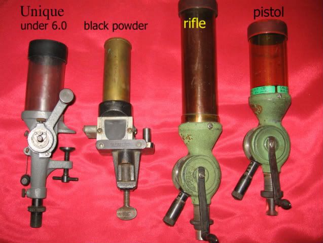

I only check the weight every once in a while and I'm a benchrest shooter and never check the weight . I have a 4 different powder measurer for different type of powder . I always charge straight into case but I've doing that since 1968 and know my powder and how each powder throw . Each powder measurer works better one powder then another one .eldermike wrote:I weigh every 10 or so thrown charges but almost never find anything to change. Powder throws are very accurate devices, so much so that bench rest rifle shooters use only thrown charges or at least they did back when I was competing in that sport.

I have several and I agree they each have their best use.tx gunrunner wrote:I only check the weight every once in a while and I'm a benchrest shooter and never check the weight . I have a 4 different powder measurer for different type of powder . I always charge straight into case but I've doing that since 1968 and know my powder and how each powder throw . Each powder measurer works better one powder then another one .eldermike wrote:I weigh every 10 or so thrown charges but almost never find anything to change. Powder throws are very accurate devices, so much so that bench rest rifle shooters use only thrown charges or at least they did back when I was competing in that sport.
