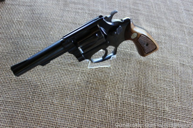

I sprung for a late 60's Model 31 revolver, 4 inch barrel. Looks nice in pictures but that's always a bit deceiving. I'll know when I get it in. The .32 has a good reputation for being an accurate target gun. I was looking around for a good load and kept coming up a bit stumped as I couldn't find anything without using XTP bullets which are a bit expensive for doing a lot of shooting. I do use them in my .327 Federal Mag BBS but I don't shoot it every week. If anyone could offer up some good advice on loads I'd appreciate it. I've ordered some brass and Berry's 71 grain .312 plated bullets and am going to start of with 2.0 grains of Bullseye and see how that works out unless I get other advice.
Re: .32 Smith and Wesson Long
Post by North Country Gal » Wed May 23, 2018 10:08 am
That's a prime vintage Smith, so even if it doesn't shoot for you, it's still prime trading material. Won't lose value unless you drop it or get it beat up, somehow. Nice find.

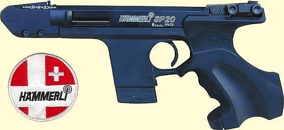

If your only paper punching there is lots of data for WC loads, it is after all the preferred chambering for ISSF.
Only 32swl I have is one of these
Wadcutter only
