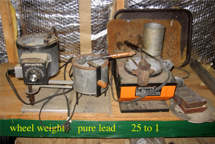

I've used wheel weights since 1970 with great success , if you don't drive them too fast around 1000 fps . . My serous target shooting I mix 20 or 25 to 1 and pure lead for black power . You can go to a tire shop and get 5 gal bucket for around $10

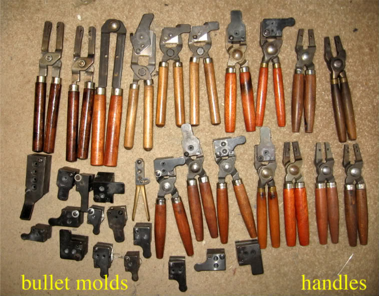

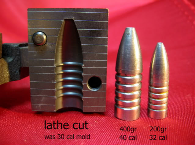

I sold most of my casting stuff and I made most of my target bullet molds like the 2 below . I only have my black powder stuff left . I have over 100 lbs of pure lead left and a few molds .

What were you shooting the 400 grain 40 caliber in? Notice you have or had a lot of 2 cavity molds. You prefer those over the six cavity. Just curious.

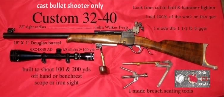

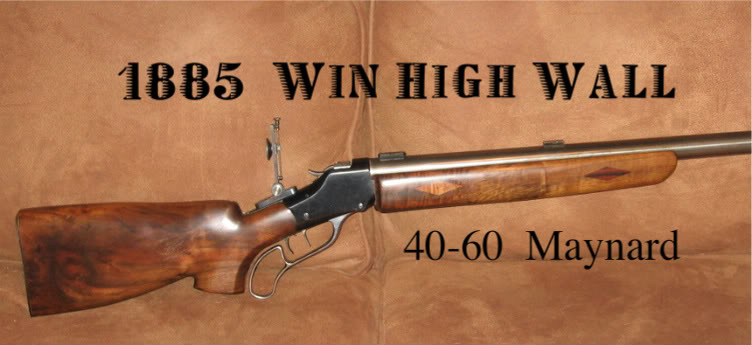

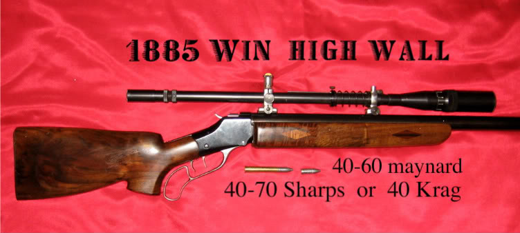

In pistols I prefer 2 cavity molds , 1 cavity I like in my target rifles . I only use 4 or 6 Cavity mold in full auto guns because you can't control the bullet and mold temp . I built both of these guns below2guns wrote:What were you shooting the 400 grain 40 caliber in? Notice you have or had a lot of 2 cavity molds. You prefer those over the six cavity. Just curious.
