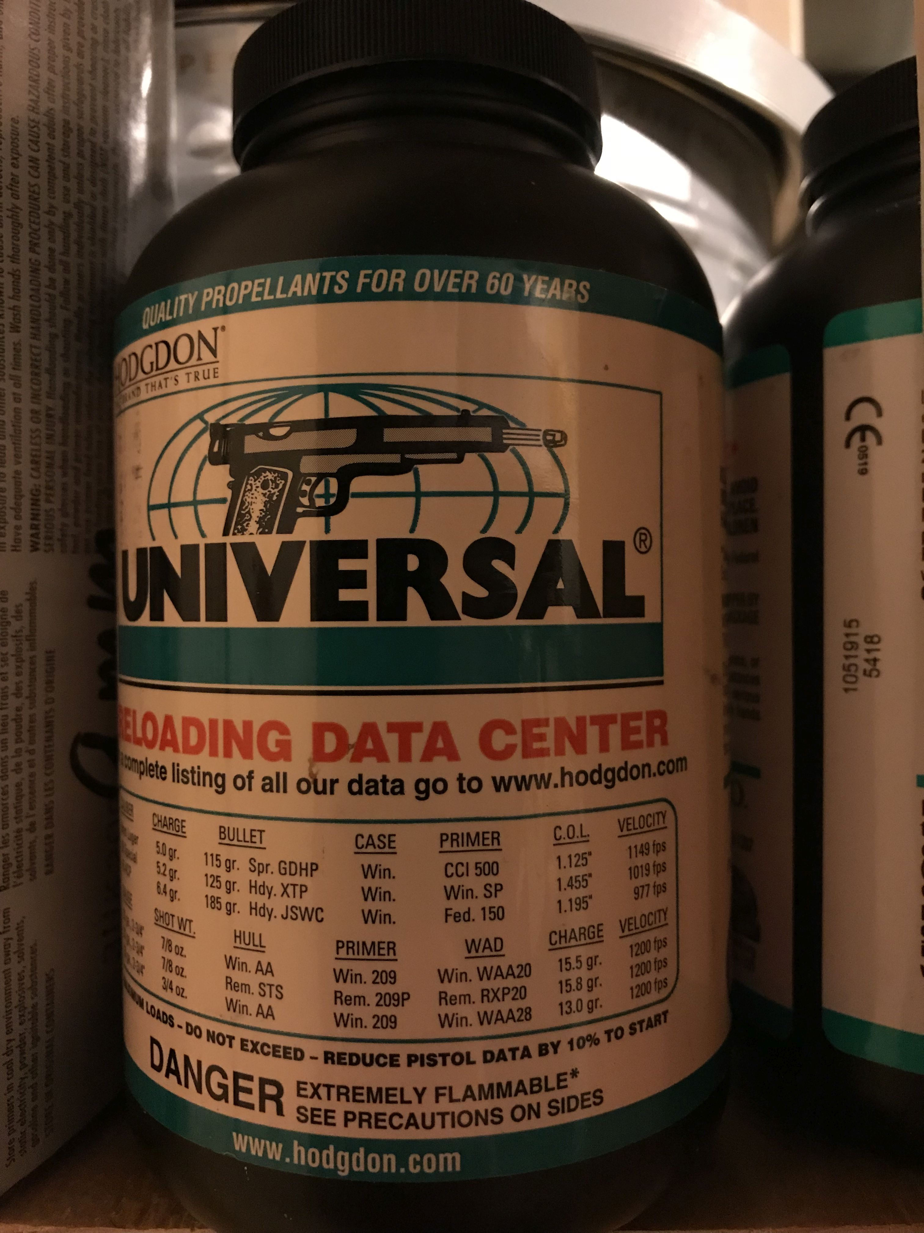

I keep reading Universal or Universal clays powder. I looked at lgs and couldn’t find either but they had some just named Clays. Any difference??

Post by Jrprock » Sun Mar 04, 2018 5:50 pm
Load data is basically a wash for Unique.
I’ve also used it in 9mm and 45-70. It’s a little dirty down low but meters nicely and is pretty fluffy.
