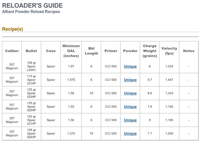

Unique .357 loading data... I've used 9 grains under ZERO 125 JHPs with good success in both my 5.5" SA revolver and my Henry BBB.
http://www.alliantpowder.com/
Alliant Unique Load Data
Alliant Unique.JPG (48.65 KiB) Viewed 1621 times
