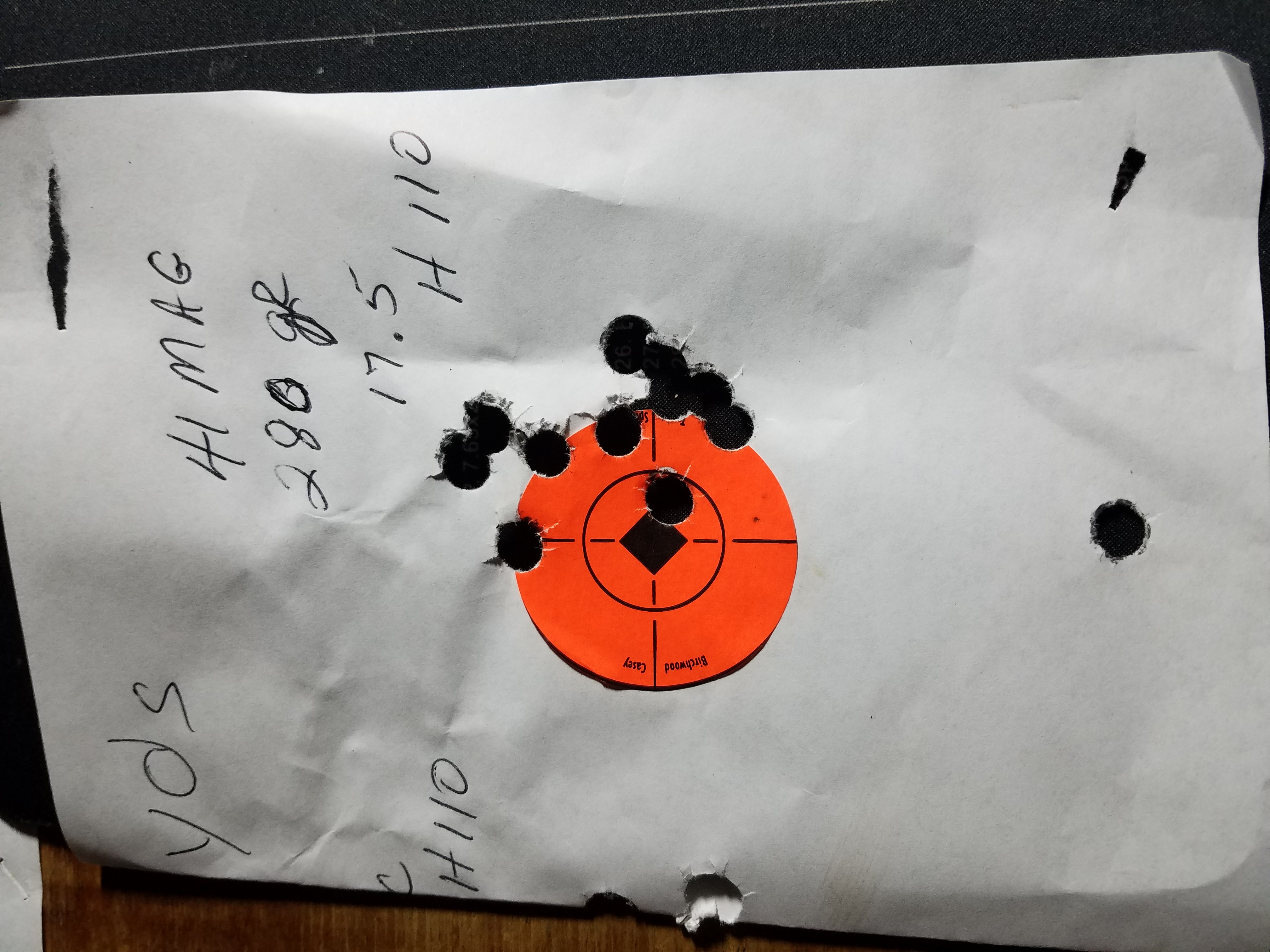

I picked up some 280 WLNGC they came from BTB.
Loaded over 17.5 gr of H 110.
Was 25º yesterday and felt a heck of a lot colder.
Well I did wander down to the barn, that's where I have a little test area.
Well shot stand was blown down and covered in snow.
So I drug some plywood over by a tree, about 40 yds.
Hope this pic thing works, if so the low shot was the first. Adjusted the sight a little.
Not to bad, want to get a little more distance, but that'll have to wait. It's showing promise anyway.
Well it's side ways so the hole at the right is actually the bottom.

showing promise indeed .. 8-)

Looking good. Would like to know what kind of velocity those are pushing. Bullet overall length? Did they all cycle well?

dmanwarren wrote:Looking good. Would like to know what kind of velocity those are pushing. Bullet overall length? Did they all cycle well?
Sorry, don't have a chrony any more.
OAL 1.68", and yes cycled and chambered with no hickups.
I made up a dummy round to start with and checked for cycling and chambering before I startred actually loading.
Thanks for the response, I should have put all that info in here in the beginning.

That's a pretty big chunk of lead for a 41 mag. Looks like you've got a good load in the making. Nice work.

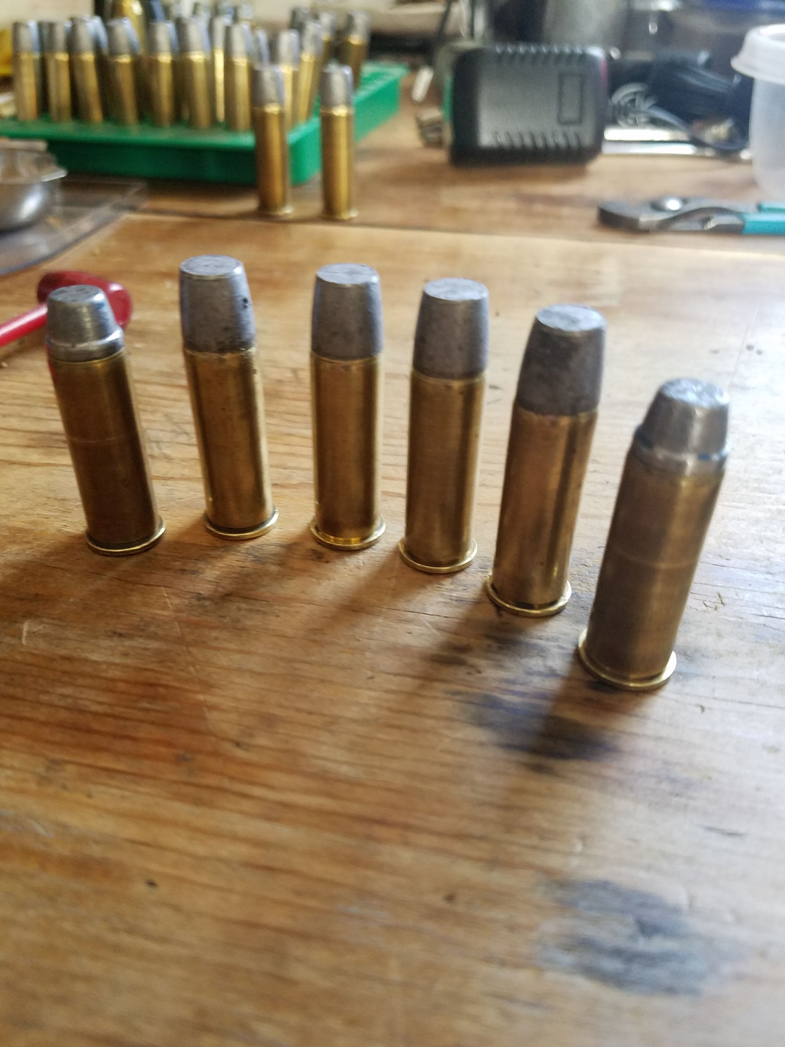

Here ya go a comparison between the 210's & the 280's.

If you get above the 1.590 overall saami length in mine it wont cycle. I had a guy from Oregon send me some of his 260 grain bullets to try and they would not cycle as the crimp groove made the oal to long.

Al, I just made a dummy round with one of those 280's, it was 1.704 and it still cycled right through smooth as butter.
Don't know if it makes a difference, and wouldn't think it would.
Mine is one of the first 250 made.
