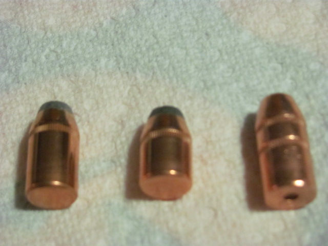

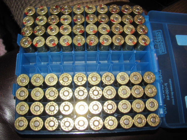

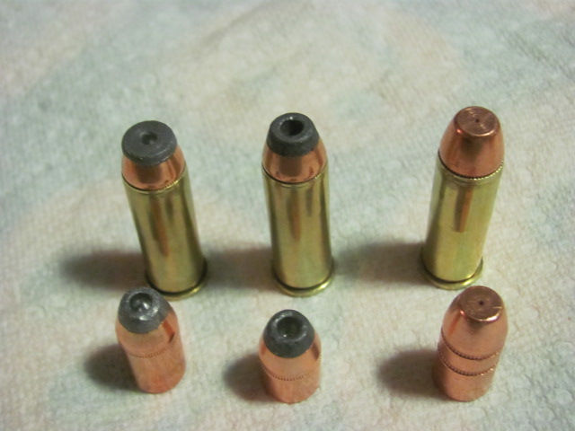

sometimes taking a second look allows someone to see something he overlooked the first time .. :roll: .. I've bee waiting until an order for Barns Buster 300 gr bullets arrived to build some test loads .... while moving some boxes on my storage shelf, I realized I have had 3 boxes (100 per box) of Nosler 300 gr JHP bullets for something over a year .... naturally, UPS arrived a short time later with a couple of boxes of the Barne's 300 gr'ers .... what to do :?: .... solution simple .. ;) .. load some of each .... the Nosler's are jacketed hollow points, all it takes is a glance for one to tell the 300 gr from the 240 gr .... we now have 50 240 Noslers ready to go along with 25 each 300 Noslers and 300 Barnes .... weather permitting a trip to a range is on tap for Wednesday .... the plan it to run them through a Chrony and to fire some to check group size .... Looking forward to it

earlier today I was able to use our Henry 44 Mag to test a variety of ammo .... 240 gr cast practice rounds generated very light recoil and were accurate out to 50 +/- yards .... well before we got back to a 75 yards, their drop was more than I'm happy with .... once the ones we have are gone, I don't anticipate loading any more 44 caliber cast bullets .... as it turns out, I have plenty of time to change my mind because we have hundreds of cast 240 gr'ners on hand .... no way I'm going to ignore them, the were bought to be burned and I fully anticipate doing so .... I also anticipate building our reserve of 240 gr Nosler JHP BLEMS (AKA seconds) to be used for practice .... I was impressed with the 300 gr Nosler JHP's pushed by 21 gr of W296, they hit hard and group nicely .... some will understand when I say the sound of the muzzle blast and the felt recoil were what I'd expect from a solid, big bore hunting round .... the 300 gr Barnes Busters pushed by 20.5 gr of H110 didn't do as well ... they showed a couple of signs of too much pressure .... the main one being the casing expanding to where they required noticeably more effort to eject the empty .... I plan to load the next bunch with W296 and see how they perform

the Oregon Trail 240 gr cast bullets were pushed by 7.2 g of Bullseye .... their average velocity (10' from the muzzle) averaged 1224 fps .... as noted above, their performance fell off rapidly after 50 yards or so ... I believe I could speed them up by a couple of hundred feet per second without a lead build up in the barrel .... it will be interesting to see ....
the 300 g Noslers and the 300 g Barnes were both powered by 20.5 g of H110 .... the Muzzle velocity of the Noslers averaged 1525 fps while the Barnes averaged 1453 fps .... given the equal weight of the bullets, I was surprised at the difference in average speeds .... I was also surprised at the a couple of the Barnes cases swelling so as to be noticeably harder to eject .... it will be interesting to load some with W296 and see what happens

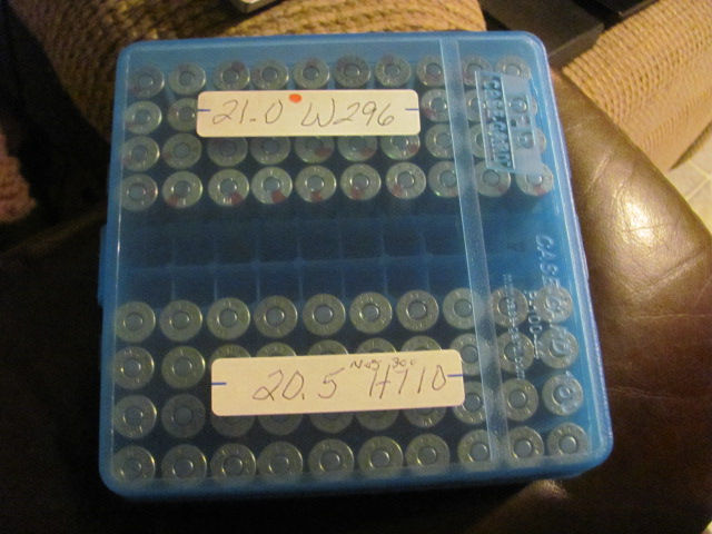

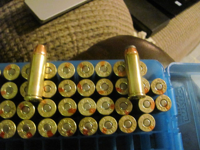

my quest continues .... today (still using Barnes and Nosler 300 gr bullets), I decided to assemble test loads using W296 and H110 powders .... a good while back they were reported to be identical but any more, different charges are recommended .... per Nosler, max charge for their 300 gr 44 cal bullet is 21.0 gr of W295 and 20.5 g of H110 .... I loaded 20 rounds of each bullet with each powder, to ensure there can be no confusion, the cases marked with a red dot containe W296 .... my plan is to run 3 or 4 of each load through a chrony, the remainder will be used to fire 4 round groups from a Lead Sled at 25, 50, 75, and 100 yards .... I'm looking forward to sending them down range

as a direct example : per Nosler's Reloading Guide No. 7 .... for Nosler's 44 caliber, 300 gr JHP used in a 44 Mag rifle .... using a Ruger 18.5" barrel, they recommend :
21.0 gr. of W296 (a 122% load) that resulted in a muzzle velocity of 1,507 fps
20.5 gr. of H110 (a 118% load) that resulted in a muzzle velocity of 1,580 fps
with .5 gr. lighter load H110 produced a 73 fps higher muzzle velocity .... from that it seems to me that they aren't identical
I too am curious .... that's the reason I have 40 of each to run in side by side test
