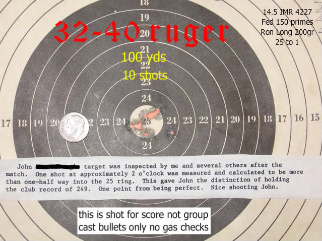

Gas checked bullets should NEVER lead unless it over 1800 FPS .
I drive plain base lead bullets in my 32-40 target rifle at 1400 FPS and NEVER leads up .
Picture049-1 (1).jpg (78.36 KiB) Viewed 1442 times
