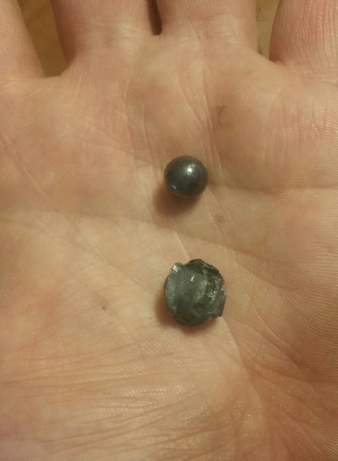

I've been playing around with 000 buckshot pellets as an economical plinking round. I picked up 10 pounds (approximately 1000) for $50 shipped. I'm pushing them around 700 fps with 1.5 grains of fast powder and they are accurate enough to bounce soup cans at 40 yards and my 2 inch spinners don't stand a chance at 25 yards. I seat them about halfway in the case with a medium crimp and they cycle fine in my BBS carbine. I'm attaching a picture of one I recovered from an old textbook at about 15 yards.

Have you seen this done elsewhere or did you just think that it might work, breathe deep, and give it a go?
As a hand loader, I would not be that adventurous. It's certainly an interesting experiment, though, as long as they clear the barrel.
Keep us posted.

Re: .38 special plinking load
Post by GaHenryFan » Wed Sep 27, 2017 6:23 pm
I did a lot of research, and did it incrementally until I got where I wanted to be. They hit hard even at this power level. There's very little bearing surface with the round projectile so it doesn't take high pressures to launch them at a respectable velocity.

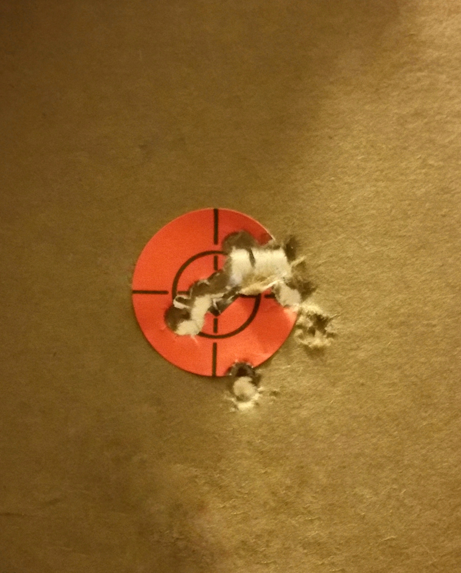

Post by GaHenryFan » Thu Sep 28, 2017 9:02 am
Clovishound- I hadn't heard of Summers before. I've been paying close to that for 500. I'll look there when I'm ready for more. Meanwhile, I'm pretty impressed with the accuracy of the round balls, and they're really easy to load. This was 10 rounds at 40 yards.
