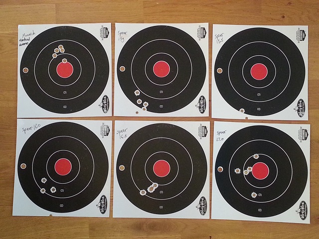

I just got started reloading and worked up a variety of loads as an experiment. I started with a box of Speer 158gr JSP (#4217) and IMR 4227 from the Speer #14 book. Who knew there are no more left in the world? There are a handful of online suppliers that have one box left and they don't come in bulk. Imagine ordering from a handful of people just to get a couple hundred! Anyway back to the topic. I picked up a box of Rainier 158gr JHP (they can go to 1500 FPS, Berry's is only 1200 FPS), and some generic 158gr SJSP from Everglades. I wanted to compare with my off the shelf Monarch 158gr SJHP ammo.
I worked up 5 rounds for each load and shot at 50 yards. The loads were Speer 158gr with IMR 4227, Rainier with Unique, Generic with Unique.
Here is the Henry with Speer/IMR - 15.0, 15.5, 16.0, 16.5 and max 17.0gr. I was disappointed that my velocities were nowhere close to the Monarch. The 15.5gr seemed to go berserk and the 17.0gr group was opening back up.
Speer loads.jpg (145.12 KiB) Viewed 2993 times

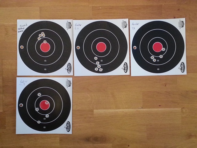

Here is the Rainier/Unique - 6.9, 7.3, 7.7gr. They were inaccurate at the higher velocity.
Rainier loads.jpg (119.28 KiB) Viewed 2993 times

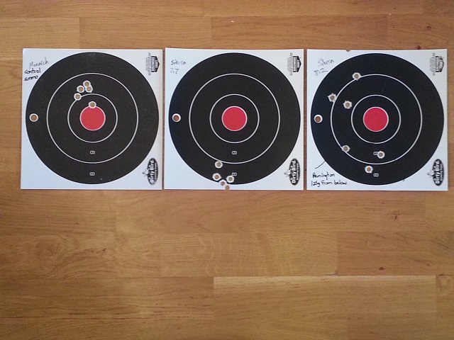

The generics that looked like Sierras - 7.7 and 8.2gr seemed to also lose accuracy at higher velocity. The group at the bottom of the right target were 125gr I mistakenly shot at a target below this one.
Generic loads.jpg (118.23 KiB) Viewed 2993 times
That Monarch must be screaming hot because these loads were probably in the 1400-1500 FPS range and came nowhere close to the same impact. I guess I need to load with something that can handle W296 or step down to 125gr to even reach out to 100yds. Anybody have a recommendation for a higher velocity load using IMR or Unique?
