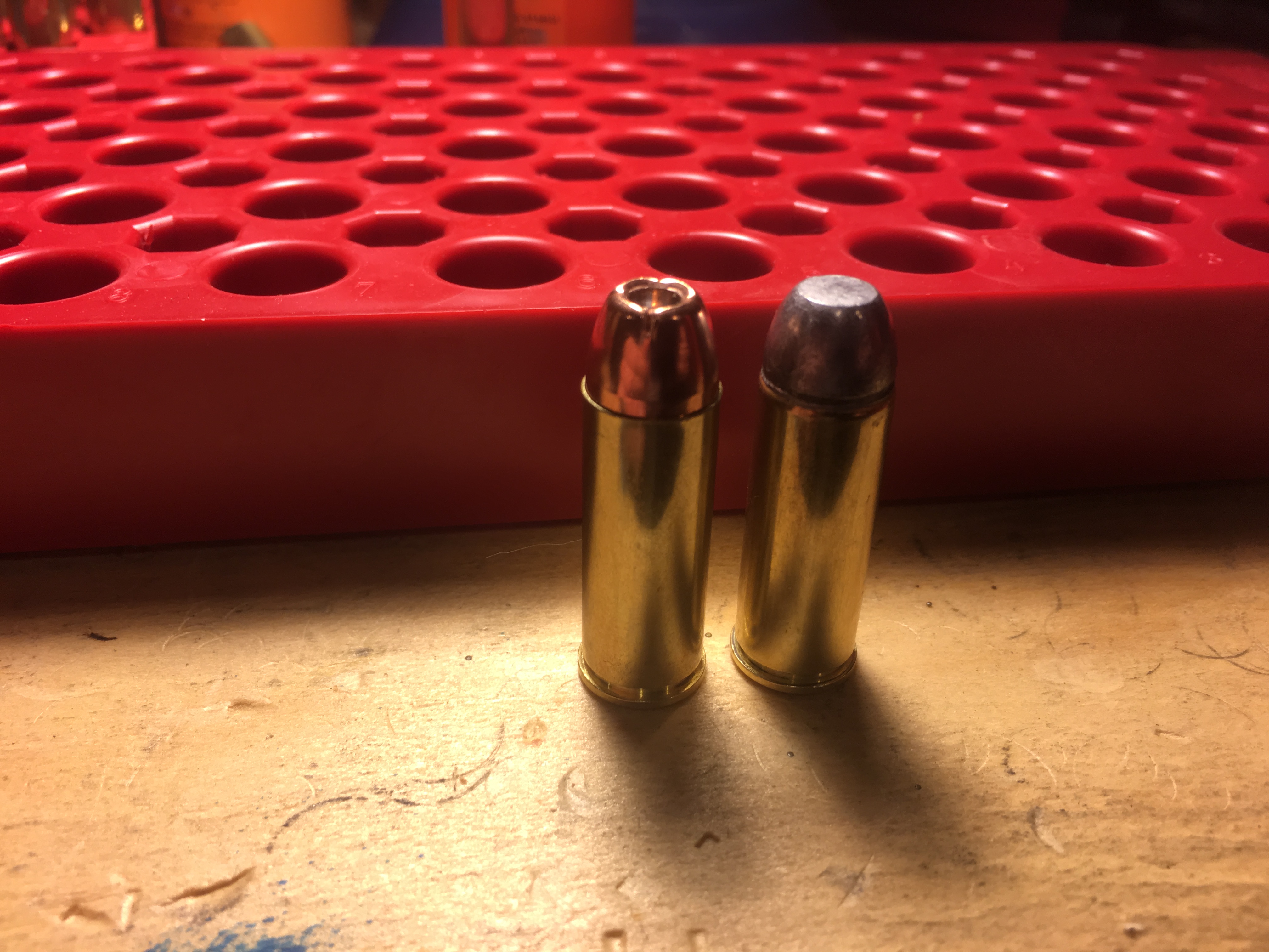

Howdy. New here. Thought I'd start by sharing my personal favorite loads for my Big Boy Steel carbine in 45 Colt.
I've tried a few different bullets and have settled on 250 gr Laser cast lead and the 240 gr Hornady XTP mag.
With the lead bullets I prefer either 7.5 gr of 231 or 10 gr of Universal. Both burn clean, are very accurate and easy to shoot all day. I also load the laser cast with up to 25 gr of H-110. These are at least as accurate and pack a punch!
With the 240 gr XTP mags I've gone way up there with H-110. Settled on 28 gr per John Linebaugh's data. I don't have a chrono so I slowly increased the charge watching for pressure signs. The gun has never balked and none of the brass(Hornady, Starline and Federal only at this level) has shown any indication of a problem. I use magnum primers with this and all my 45 Colt loads.
I'm thinking of trying some heavier ~280 gr Keith style bullets for deer next season. Any suggestions?
What loads do you guys like?
