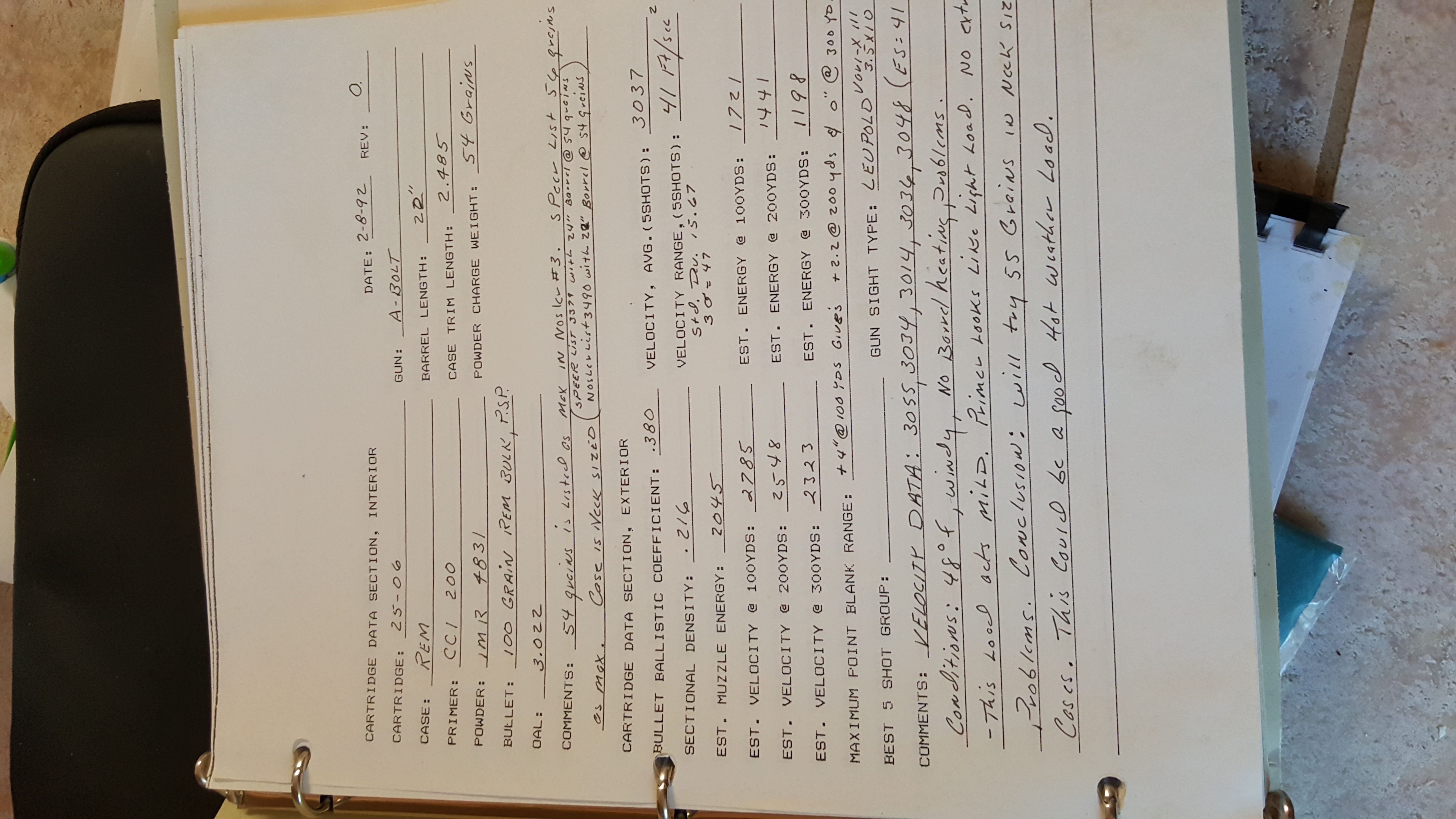

Sounds like a solid plan. Keep good notes. Many years ago I created a standard form for myself and made copies to create my own personal loading manual and keep a history of what I do at the loading bench. Here is an example:
