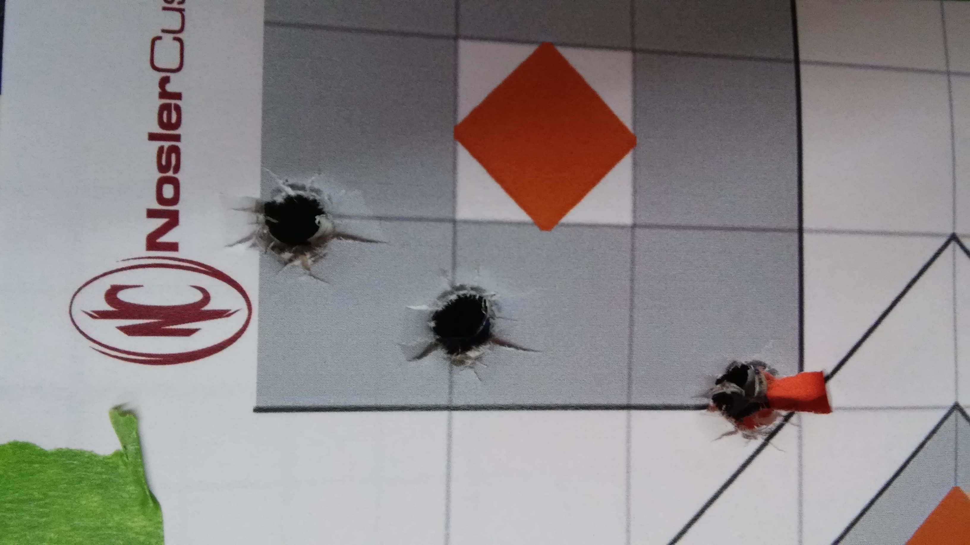

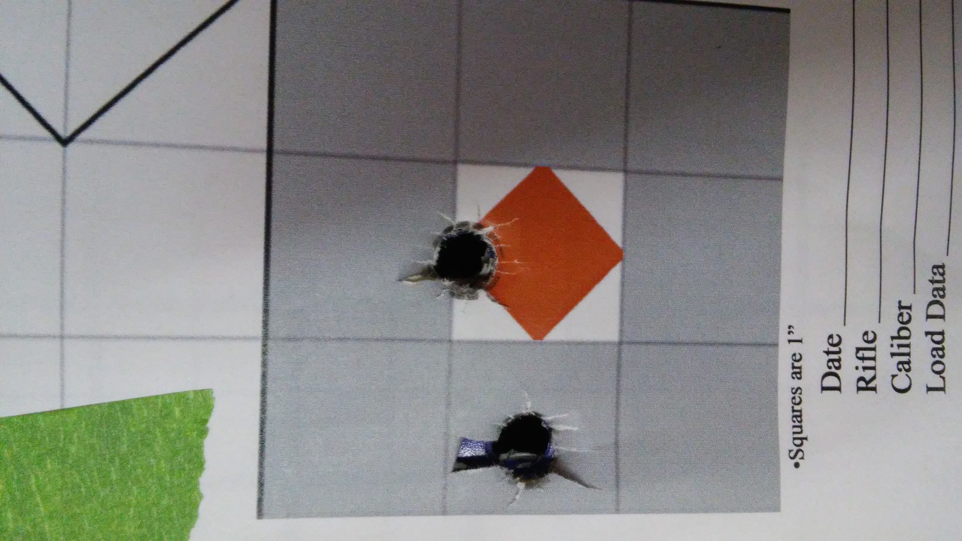

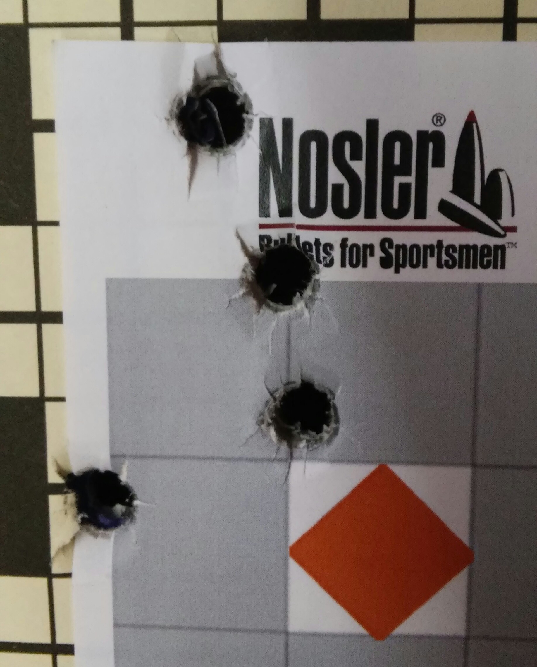

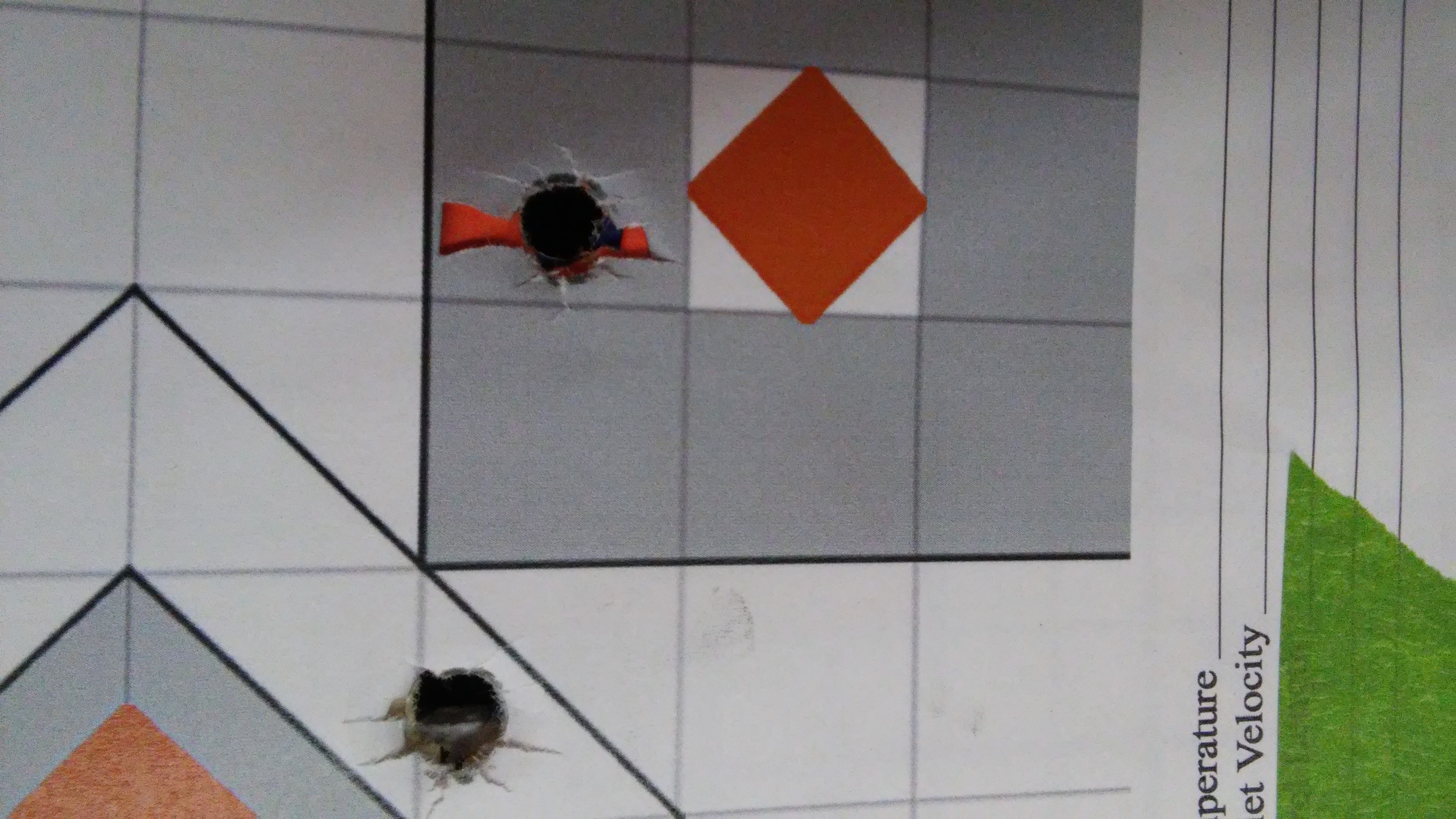

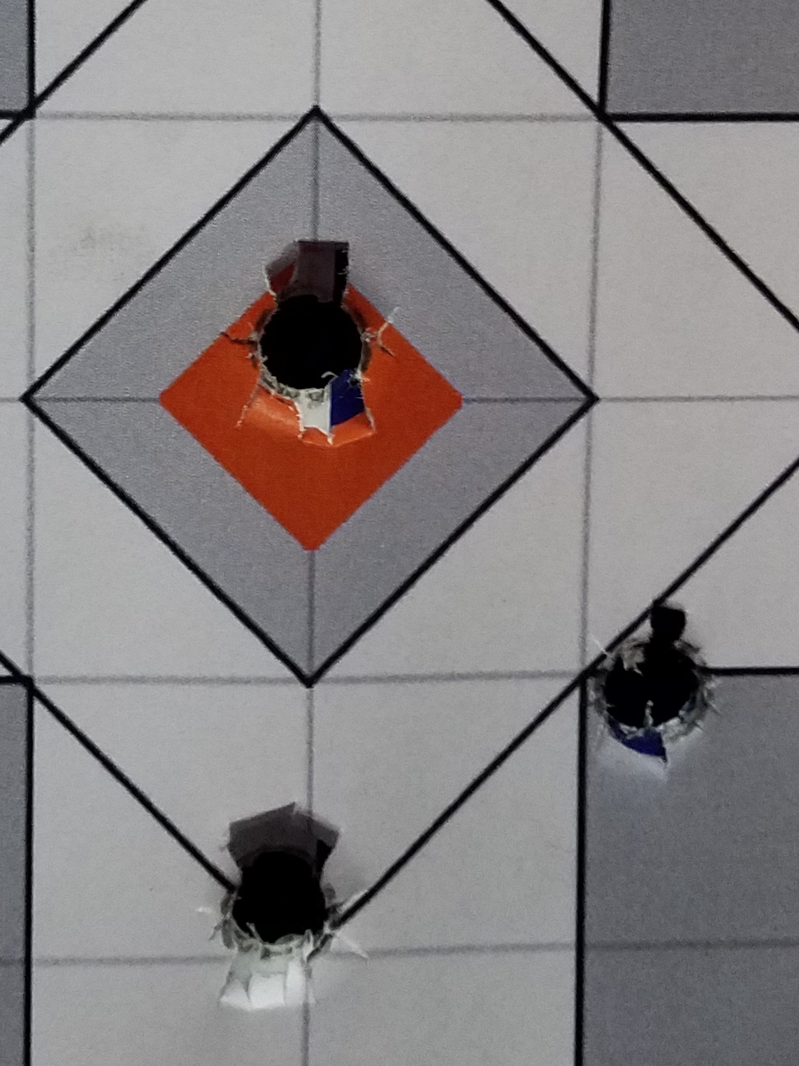

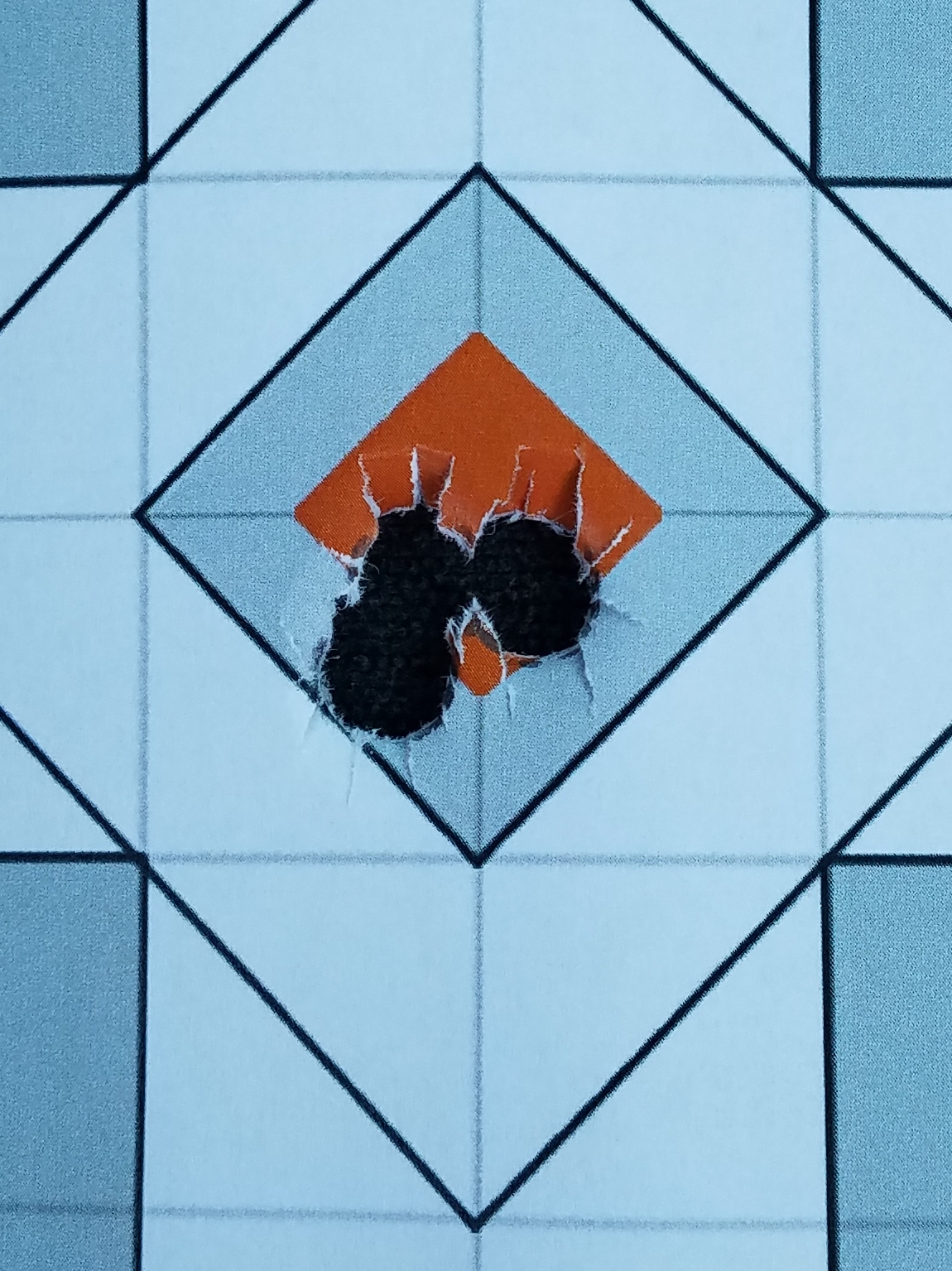

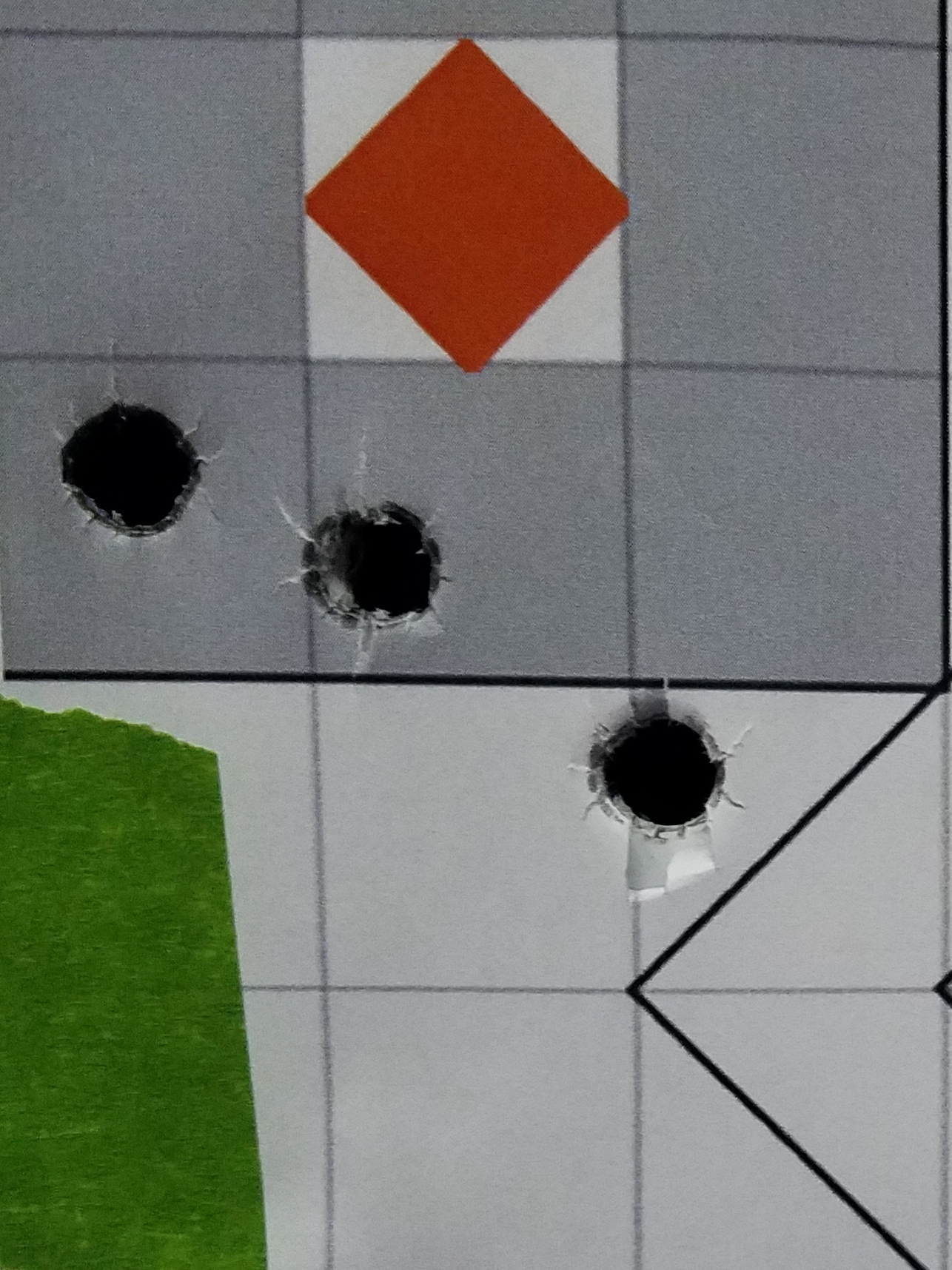

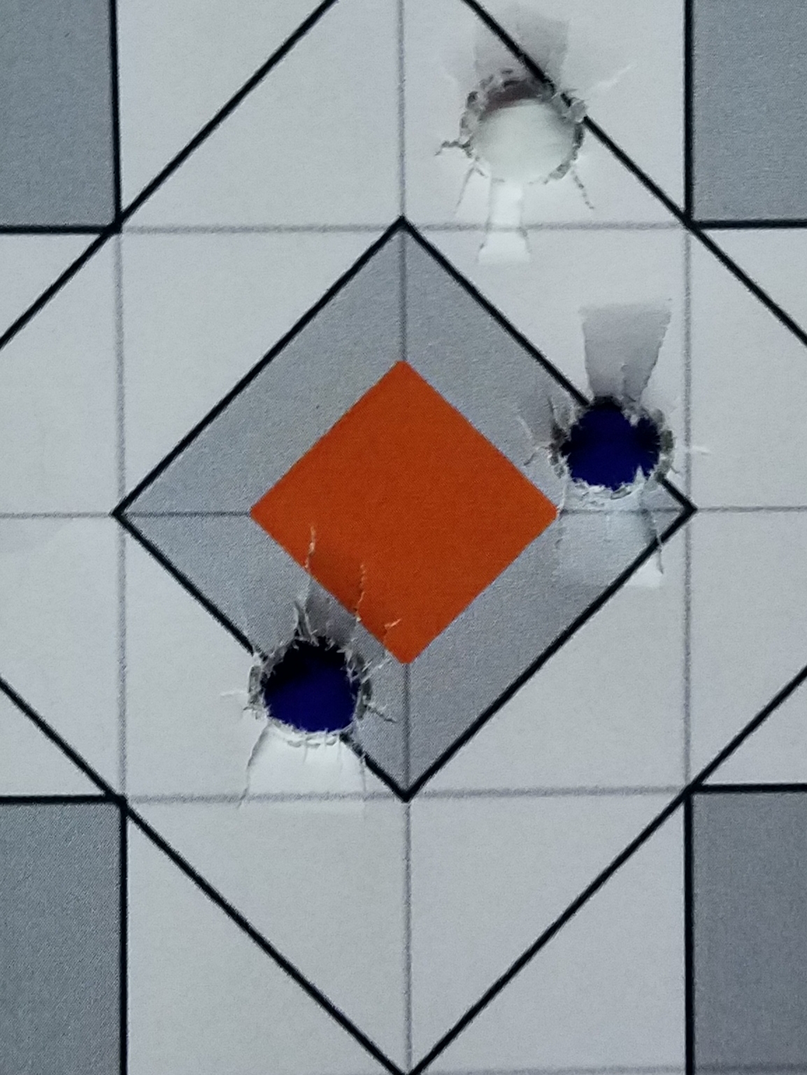

Ok, so I decided to follow up my previous test with the same load (54.0 IMR 4198, Nosler 300gr BT), only changing the primer. I wanted to see if using Remington, Winchester, and Federal primers shot any better or worse than the CCI's, and to the same POI. Obviously, if I really wanted to do a thorough test, I would set up a ladder with various loads for each one, but I didn't want to go that far at this point.
First of all, I only had about an hour to shoot this morning, and I think I was not taking my time as much as I normally do, and it showed. My groups were not as tight as they are normally, but I still got some info worth knowing.
Before starting my test, I fired two of the HSM cowboy loads to foul the barrel, as I had cleaned it recently. Then I fired 4 shots with the CCI primers.
The next three were with Remington 9 1/2 primers. One note: These primers are pretty ancient, so a fresh batch of Remington's may perform better. As it was, I don't think I'll do anything further with these fit now, at least not with this load.
The Winchester's were next. Only two of them, but they looked to be very good. I'll load a few more of these up for further testing.
Last came the Federal Gold Medal Match (not Magnum). Again, only two shots. They did OK, I think with just a little tweak they would be good, but I'll put them on the back burner for now.
It should be noted that none of these primers showed any signs of excessive pressure with this load.

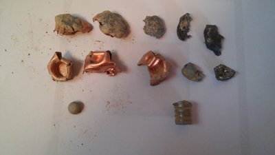

Also, here are some of the bullets that I dug out of the dirt behind my target. At the lower right is one of the HSM 405gr lead bullets. At lower left is one of the little plastic Ballistic Tips that are used to improve aerodynamics and initiate expansion. Based on what I see here, I would anticipate some pretty dramatic shock and damage on deer-sized game.
That's all for today. Keep shooting.
