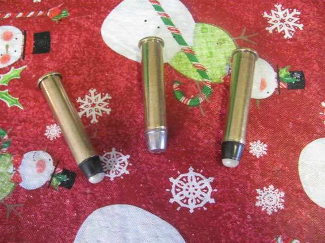

earlier today I took the first step toward developing deer/big game hunting load for our 45-70 .... we will us we have a long standing preference for using Nosler bullets in our hunting level ammo .... the only bullet Nosler offers for use in a 45-70 is their Combined Technology 300 grain Ballistic Silver Tip ===> http://www.shootersproshop.com/nosler-4 ... -50ct.html .... earlier today I loaded our first 10 rounds of 45-70 ammo with the Noslers .... the picture below is of a Nosler with 51.5 grains of IMR4198, the one in the center is a factory HSM Dangerous Game bullet, the one on the right is a Nosler with 49.5 grains of IMR4198 .... sometime after Christmas I hope to get to a range where we can run them through a Chrony and see which one groups the best ....

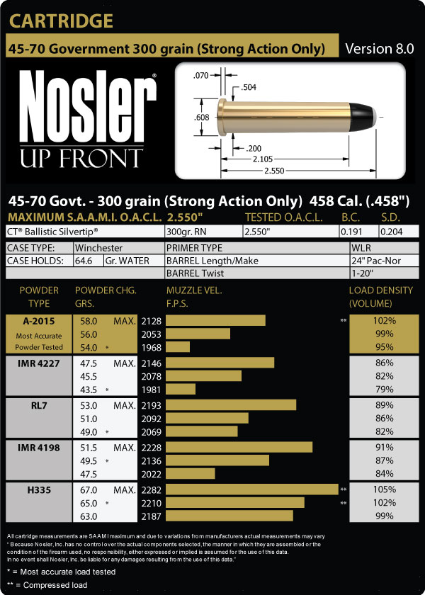

I'm a little disappointed in Noslers load data. Looks like there lawyers made them go with powder puff load data cause of max saami spec for COAL and the low case volume pressure....which I got from the powder manufactures website.JEBar wrote:earlier today I took the first step toward developing deer/big game hunting load for our 45-70 .... we will us we have a long standing preference for using Nosler bullets in our hunting level ammo .... the only bullet Nosler offers for use in a 45-70 is their Combined Technology 300 grain Ballistic Silver Tip ===> http://www.shootersproshop.com/nosler-4 ... -50ct.html .... earlier today I loaded our first 10 rounds of 45-70 ammo with the Noslers .... the picture below is of a Nosler with 51.5 grains of IMR4198, the one in the center is a factory HSM Dangerous Game bullet, the one on the right is a Nosler with 49.5 grains of IMR4198 .... sometime after Christmas I hope to get to a range where we can run them through a Chrony and see which one groups the best ....

interesting info and it is appreciated .... there are 3 levels of 45-70 loads ... the old Trap Door rifles, new generation Winchester/Marlin/Henry lever actions and for rifles like the Ruger #1 .... the loads in that chart seem to be closer to the top level

The trap door rifle with it's hinged breech block and the Roger #1, with it's falling block....are "very strong actions". The bolt action would be the next in line for strength for the action. Lever action would come next. Not saying it's the weakest action by any means. Anything chambered in 45/70 is gonna have a strong action. That is not a caliber that one wants to mess with if they are recoil sensitive. I'm just very surprised Nosler downloaded the load data for the 45/70 caliber for the lever rifles.JEBar wrote:interesting info and it is appreciated .... there are 3 levels of 45-70 loads ... the old Trap Door rifles, new generation Winchester/Marlin/Henry lever actions and for rifles like the Ruger #1 .... the loads in that chart seem to be closer to the top level
The bullet is one of the components of ammunition. But, in my opinion, it's not the component that controls the load data for the handloader. It does play a role, not just the leading role. It's first and main role is COAL (cartridge over all length) for reliable feeding. Ladder testing with a chronograph will show what the barrel likes in regards to the amount of powder used in the cartridge case. The wrong powder burn rate will yield crappy accuracy. Low powder charge will yield unburnt powder residue resulting in low cartridge case pressure, again bad accuracy. So on and so on....you get or know my point.

in checking, IMR4198 powder recommendations vary widely from source to source .... numbers below are for 300 grain jacketed bullets :
Lyman's 49th edition reloading manual :
for 1873 (type) Springfield --- 31 - 36 grains
for for 1886 Winchester, 1895 Marlin, and Henry --- 36 - 41 grains
for Rugers #1 & #3 ---- 49 -55 grains
Nosler Volume 8 :
for newly manufactured Marlin 1895, Browning 1886/1886, new generation (not originals) replica Sharps 1874, Winchester 1885/1886, Ruger #1 & #3, Mauser M98 converted for 45-70 ---- 47.5 - 51.5 grains
Hornady Vol 1 :
for Springfield 1873 Trap Door, H&R Shikari,1886 Winchester, Rolling Block 45-70's ---- 32.2 - 42.2 grains
for Marlin 1895, Henry --- 48.0 - 51.2 grains
for Ruger 1 & 3 --- smallest bullet info for 350 grains
Nosler Volume 8 :
Hornady Vol 1 :
