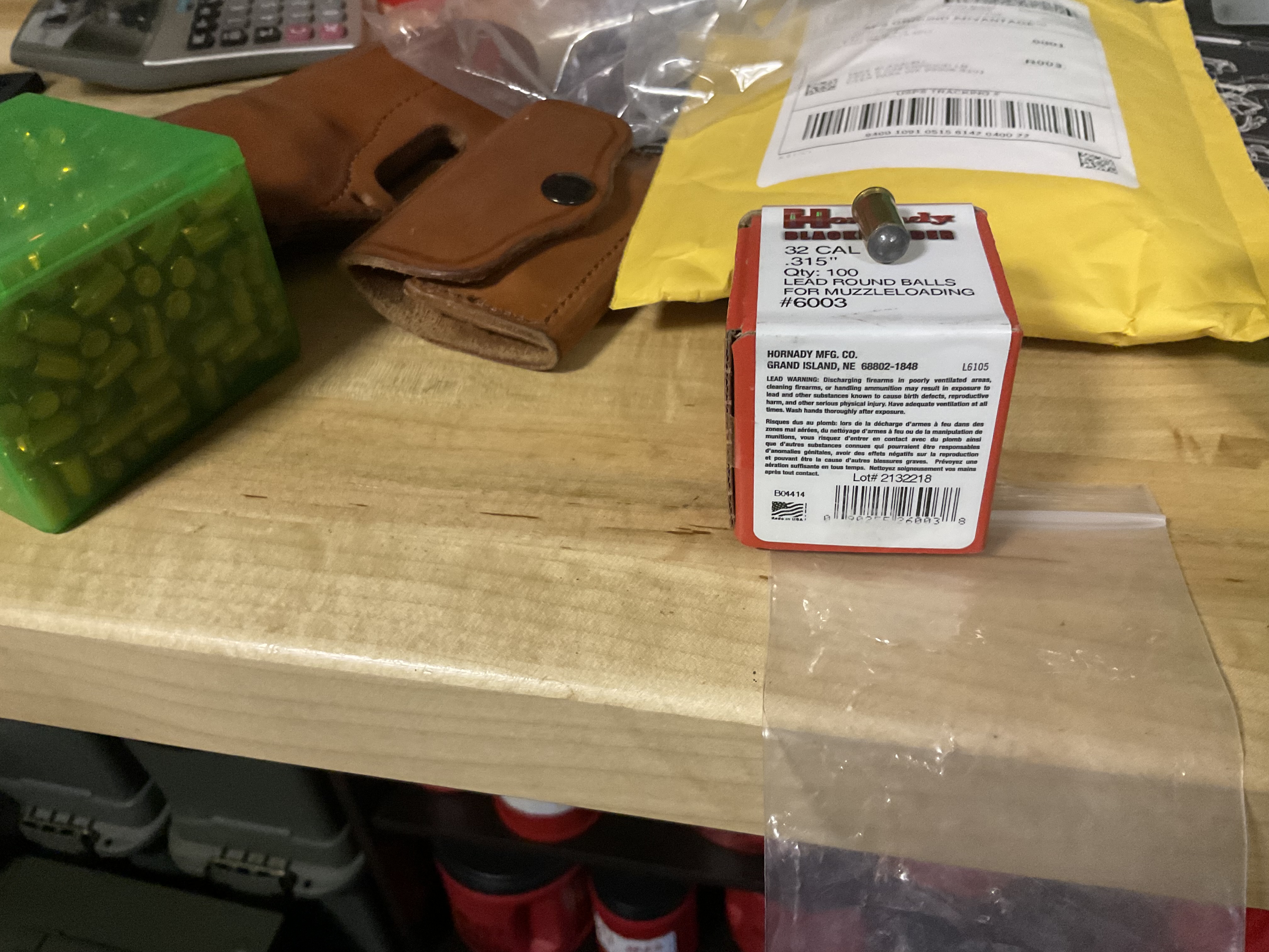

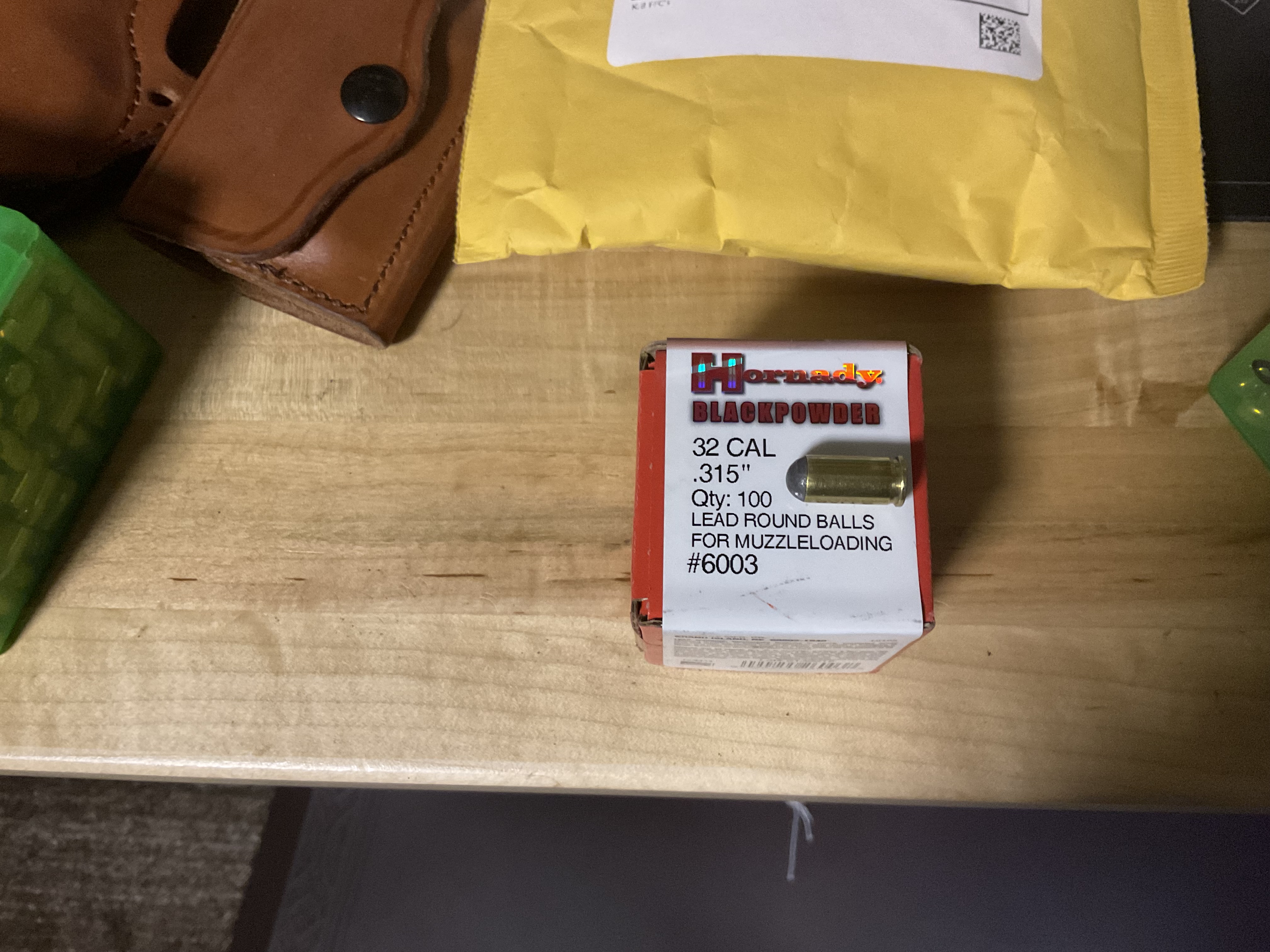

Gallery loads are low velocity quiet loads that shooting gallery’s in the past used. Also they were used quite a bit in shooting demonstrations such as Annie Oakley did in the past. There’s not a whole lot of info out there but I understand that I can use only a primer to shoot these but they may be better with a pinch of powder such as Bullseye or Trail Boss. Here’s a picture of a dummy round that John Davies gave me.
