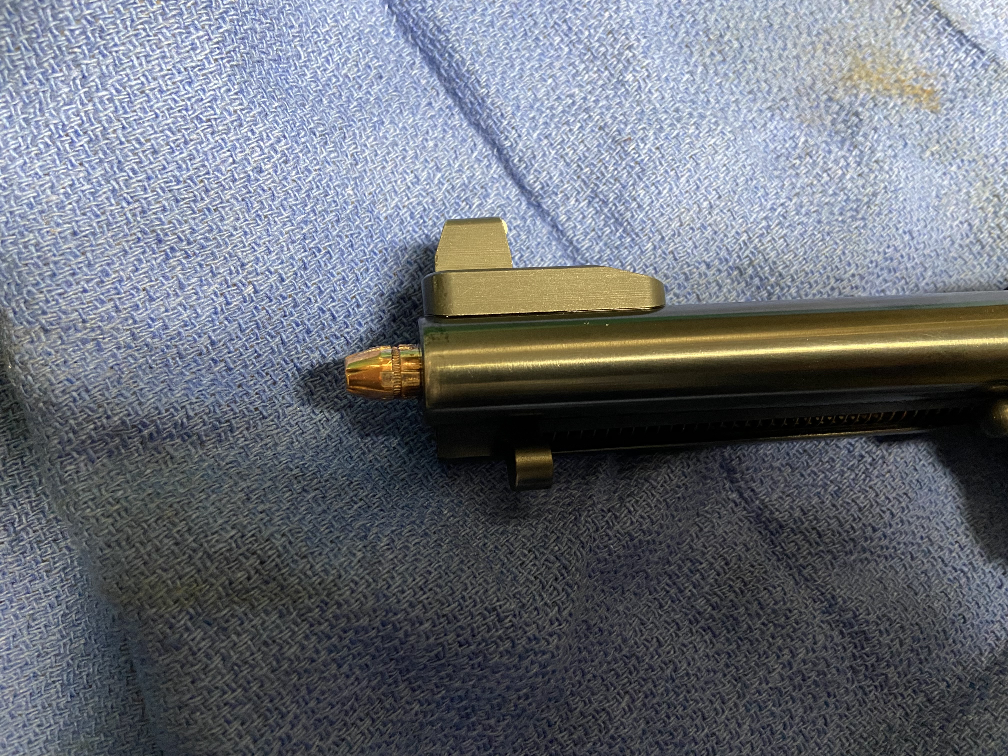

Like you Bill I had my first and only so far squib load a few years ago. Shooting a Ruger Single Seven in 327 fed mag at the range I had a shot that just didn’t sound right. Looked at my target and it was missing one hole per number of shots I had fired. Took a look at my revolver and bingo, there was the bullet sticking out of the muzzle. Due to the location of the bullet I think that had I fired another shot I probably would have been okay but I’m glad I’ll never know. Stuck the bullet in my bench vise and it pulled right out. It now sits front and center on the shelf above my loading bench as a reminder.

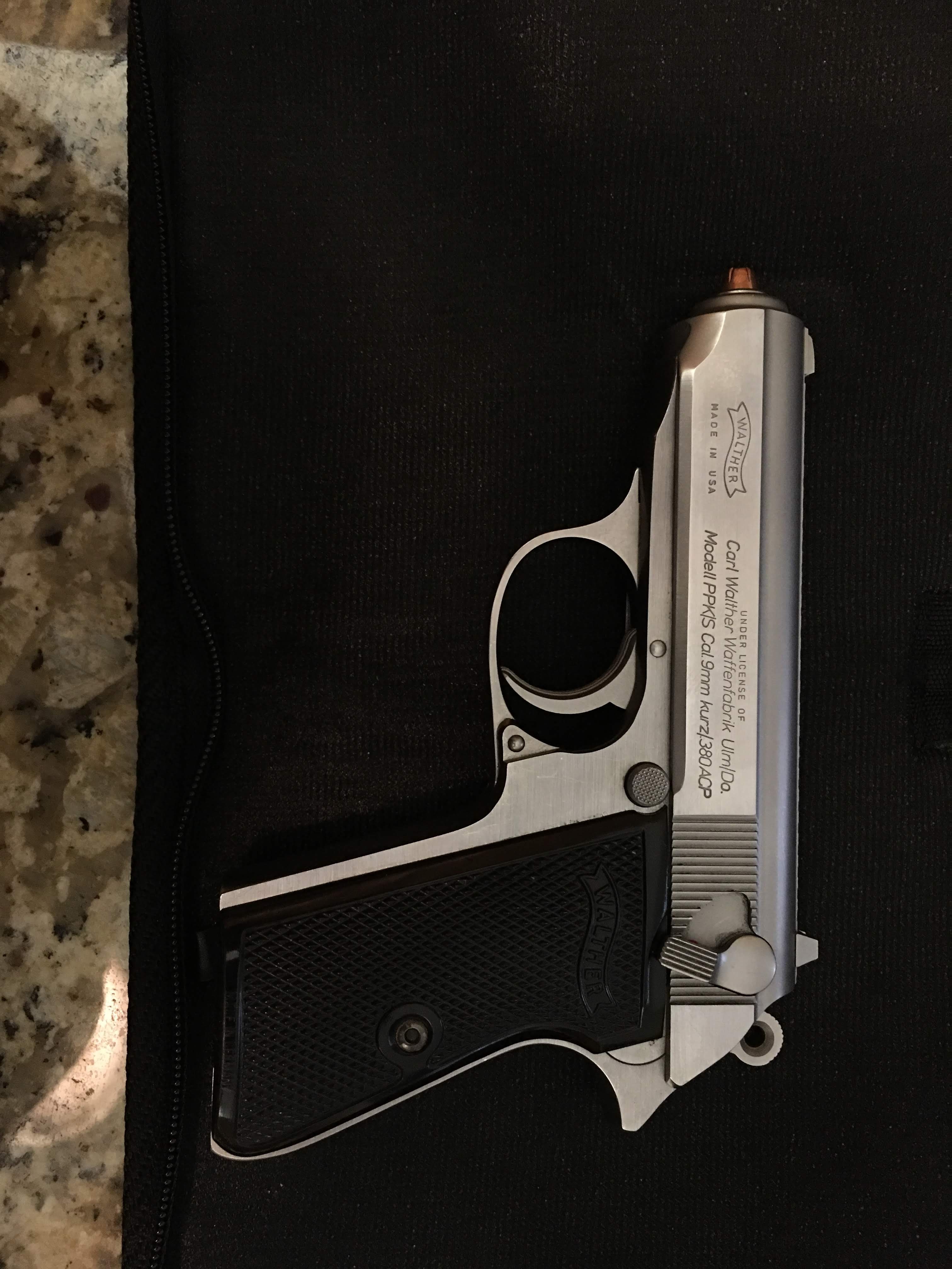

I have had one squib with my Walther PPKS using Fiocchi factory ammo. Startled the snot out of me as the blast from the cartridge blew out through the ejection port. Big ball of fire from the wrong place got my attention. The gun is a solid little beast with no harm to it and I have shot it with other brands of ammunition since. But I have three boxes of the Fiocchi still sitting on the shelf not willing to see if there are any more surprise rounds in the batch.
This reminds me that it is way past time to take that pretty little gun back to the range for some gunpowder therapy.

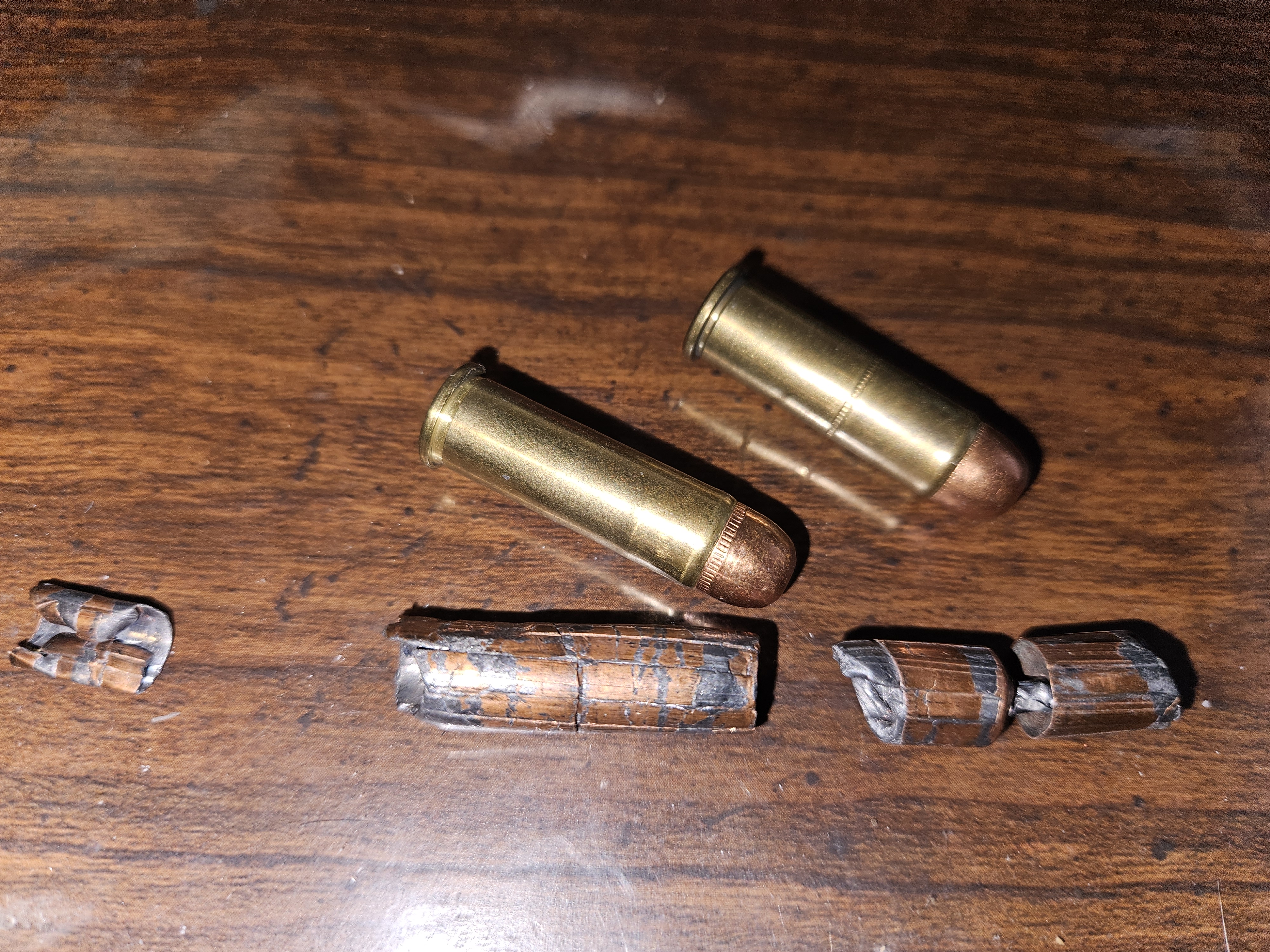

I was shooting a Ruger Blackhawk Convertible 45 with the .45 ACP cylinder in it, and was shooting wadcutter rounds. From my perspective, I didn't hear anything different, just the normal bang. And shooting at bowling pins, not paper, I could only tell that I hadn't hit a pin with that shot. I had actually cocked the gun for the next shot when a friend stopped me before I could shoot the next round. From behind and off to the side, the shot had sounded differently to him. Sure enough, when we pulled the cylinder the back of the wadcutter was a quarter inch from the back of the barrel. Somehow managed to miss powder on that one. Added a powder cop die to the Dillon after that.
Regarding the DW barrels, many years ago on a rock quarry plinking trip, my barber was shooting my S&W Model 66-2. The rounds were some plated 158gr round nose bullets, over a slightly more than minimum charge. We'd been shooting a bit already, and when I loaded the cylinder I had to push most of them in the last eighth inch or so. I assumed it was because the cylinder was getting dirty. Nope.
The first round missed the tin can, and I saw it hit the dirt. The next five I didn't see where they hit. Fortunately we were done after that, so put everything away and went home.
The next day, I pulled the 66 out to clean it and "Whoa! There's a bullet stuck at the end of the barrel." I knocked it back a little bit, then pulled out a 1/8" drill bit and tried to drill it out. Nah. By hand, wasn't happening. After a half hour of trying I quit. Decided to take it to a pro. When I turned it around to close the cylinder I saw a glint of copper. Plated bullets, remember? There was another bullet stuck just past the forcing cone!!
Short story already too long, there were five bullets stuck in the barrel. All had had powder behind them, but that tightness in the cylinder was due to oversize bullets. Combined with the slightly more than minimum powder charges, bullet #2 stuck at the end, and the other four stacked behind it. In the picture, that's the jacket only from one of them, the next two stuck together with a 1/4" hole through them, and the last two which have the remnants of a 1/8" drill broken off. I don't remember doing that, but it was 35+ years ago. The barrel does have a slight gouge in the rifling from the 1/8" bit (and I DO remember doing that), but it still shoots as accurate as it always did.
I do always plunk every round I create now. If it doesn't drop in and out, it gets pulled apart and redone.

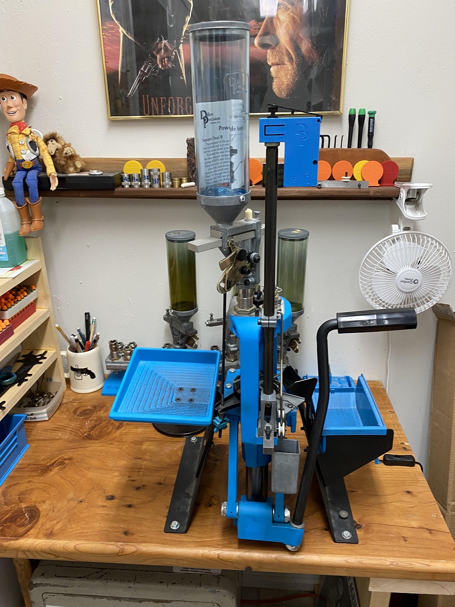

I reload on a Dillon 550B these days, but when a new company came out with a light years ago with a little light that fit the hole in the center of the tool head that shined right down onto the brass, I bought one. I had been using a clamp on light to allow me to look down into the brass to insure the powder dropped and nearly filled the case.

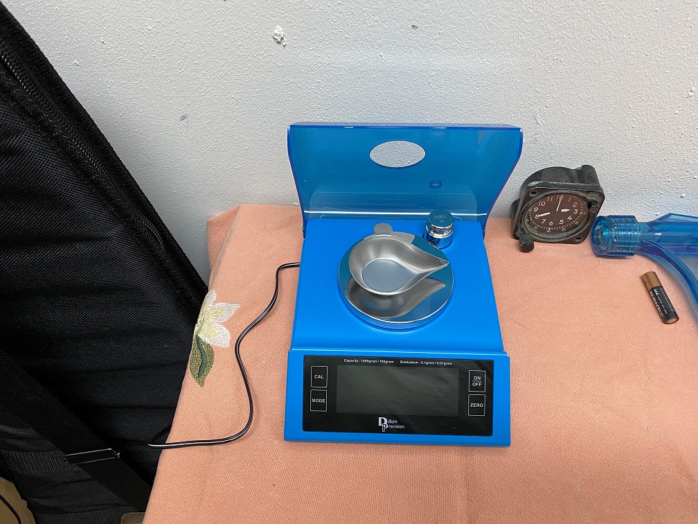

In addition, every fifteen rounds or so, I'll pull the powder filled case and weigh the powder on the scale and then pour it back in the case, replace the case in it's slot in the rotation, and then continue to load. Slows down the process, but I'm not in a race. (My Dillon Scale died after about fifteen years of use. I knew it was WAY out of warranty... but I called Dillon to see if they could repair it. They said no, but they would sell me a replacement at Cost.)

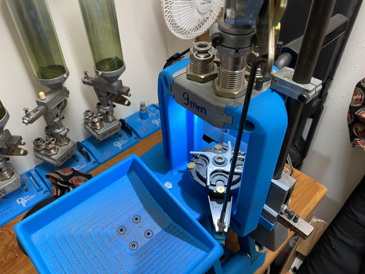

I take my time, insure all the settings are correct, and load in a small isolated location so it's quiet and I'm not interrupted. I don't take calls, Miss T takes a message. :twisted:
press ready for calibration.jpg (428.46 KiB) Viewed 4952 times
