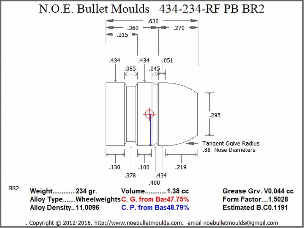

Thanx, Mags. I'll only be using bullets I've cast, mostly 1:20 tin:lead. Some will get dip lubed and others will get powder coated and an ice water bath to greatly increase hardness. All for load development testing. I'll be loading some BP PPB cartridges as well, though they'll only be for single feed loading as they'll be bore riders. For their loading, I've annealed new Startline brass so that hopefully I'll get a good chamber seal on ignition to help keep the BP residue out of most of the action. All part of seeing how the different loads work and selecting the best loads for tasks at hand. Interesting stuff at least.
I have some NOE molds (432-224 SWC ad 434-258 SWC) and clearly SWC bullets have rifle lifter issues, even when the cartridge COAL is at or well under SAAMI COAL. I can turn the rifle on its side and jiggle the lever to get the cartridge up and worked into the chamber, as a work-around. I have an NOE 434-234-RF-BR2 mold coming and I think the RF nose will work with the lifter ... if not, I'll ring up Henry.
