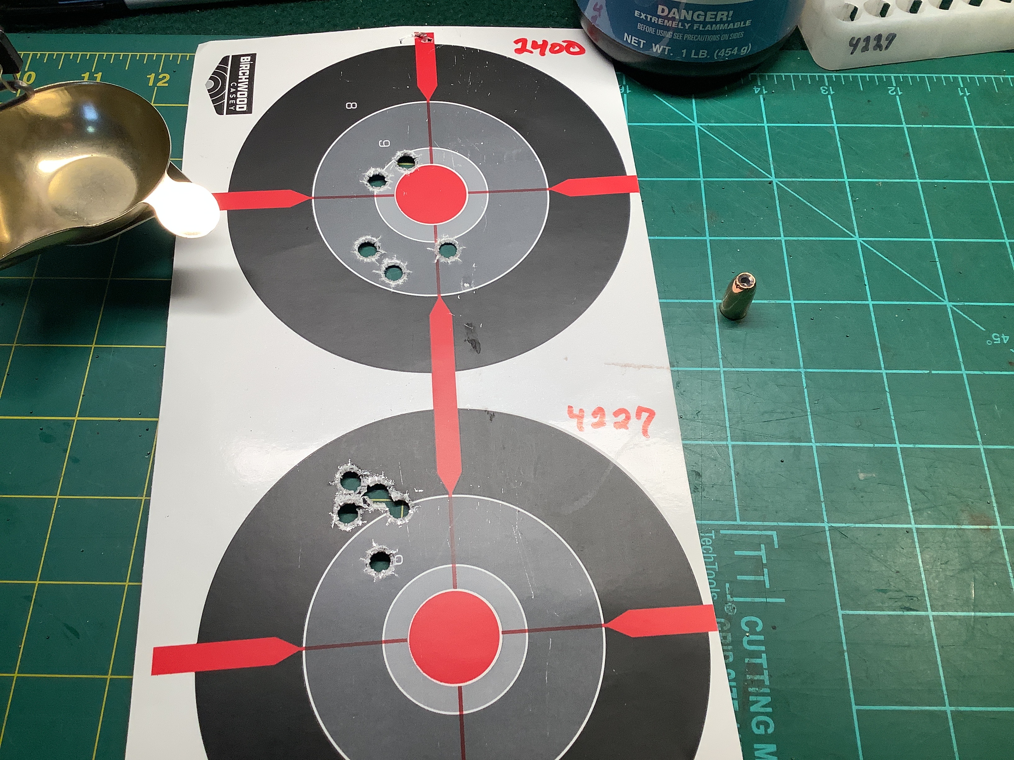

I went two the range today to try a couple of powders, IMR 4227 and H2400. I used 15gr 2400, and 14.5 gr 4227. New star line cases, std primers and 158 gr jacketed hollow point bullet. Red dot sights at 25 yards, the 4227 shot much tighter, and I will need to experiment with bigger charges .
. Any suggestions, if not I will probably go up one 1/2 grain till I hit 16 grains, although I believe Hornaday gives 17 gr as max.

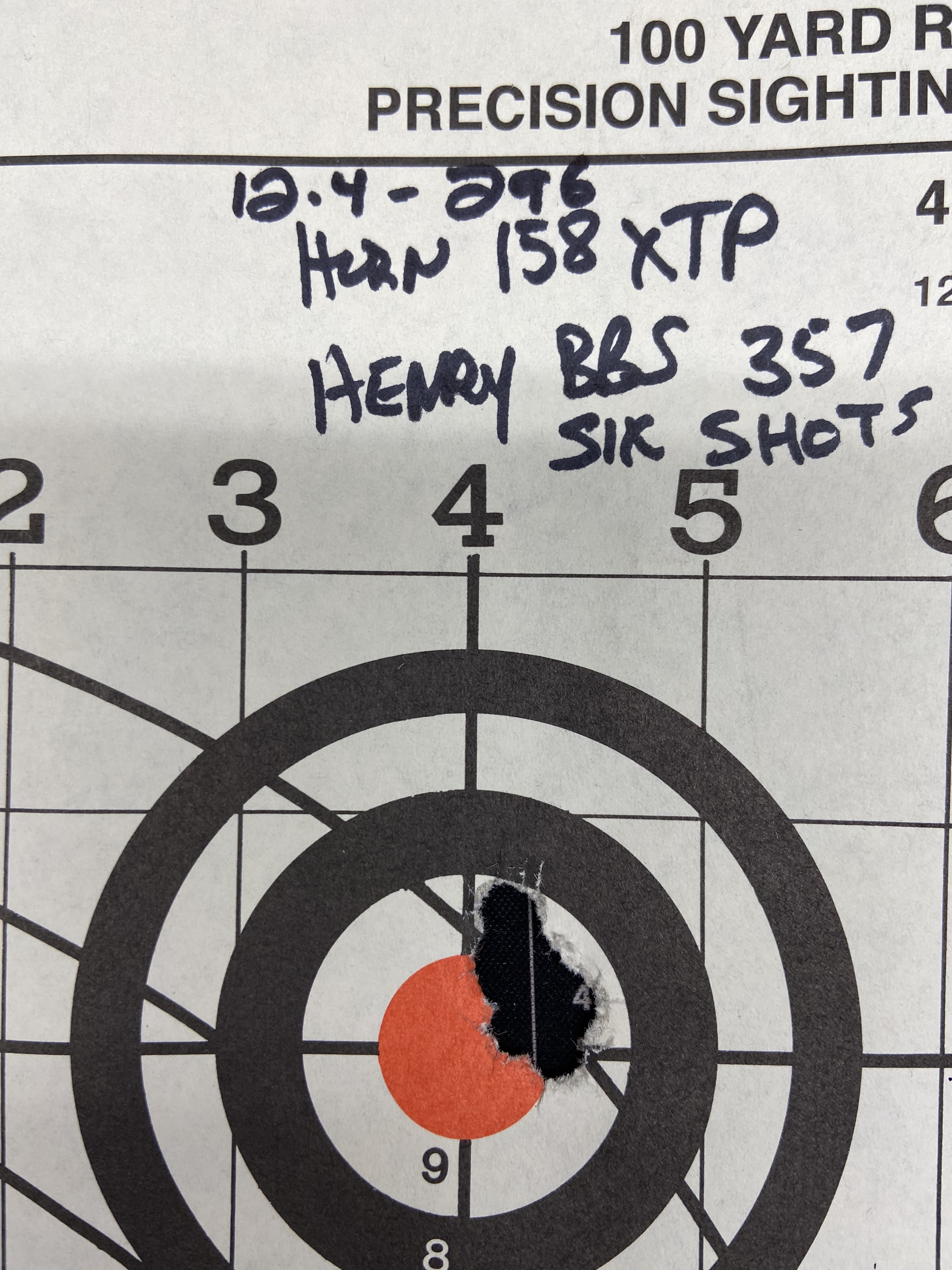

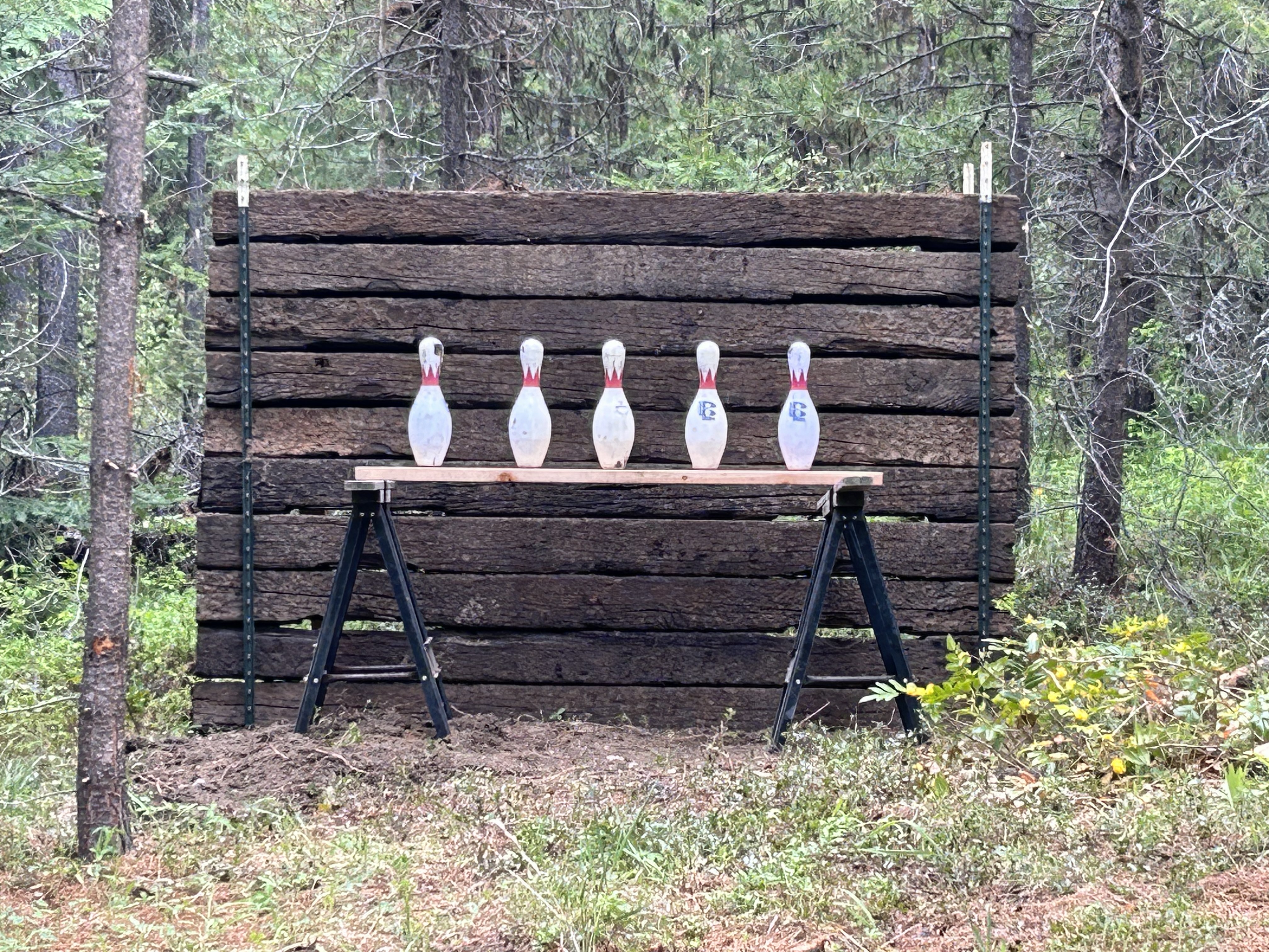

I have had great success for accuracy with W296 and Hornady XTP HP 158 in my Big Boy. No experience on effectiveness on deer but sure is accurate. This is 50 yards with a 7x scope from a bench. I also shoot it offhand at bowling pins and it mows them down.

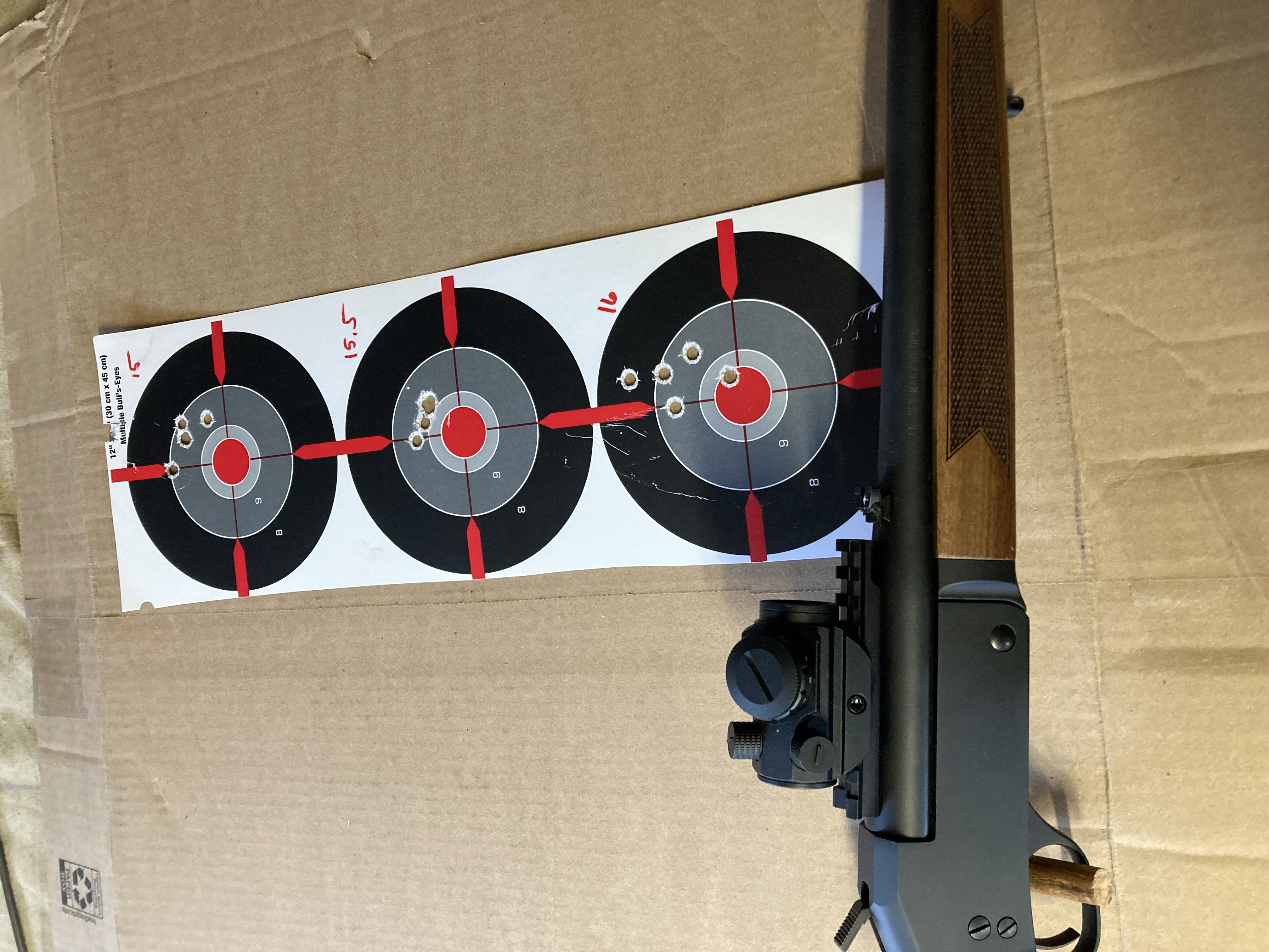

ImageWent to the range today, with three loads of 4227, I loaded 15gr, 15.5 gr, and 16gr. From the bench, with a red dot. Looks like 15.5 is the winner. I am not happy with a red dot on a rifle, I have scopes on all my other rifles, I think that helps accuracy.
I will load up a bunch, and look for a low power, maybe 2-3 power scope.

Post by BigAl52 » Fri Feb 28, 2025 3:25 pm
Rusticbob
I agree precision work isnt for a red dot. The magnification with a scope helps for shooting groups. To me red dots or( green dots )which is what I like are just something that eliminates the need for lining up a front sight in a rear sight. The size of the dot can hinder when trying to pinpoint the same aimpoint

Post by rickhem » Sat Mar 01, 2025 9:11 am
I am with BigAl on the limitations of a red dot. There are things that you can do to aid precision, but those are very "paper target centric" and probably not a good way to use the dots for other purposes. The real strength of a dot is in rapid target acquisition, and not needing to have that floating dot centered in the lens. Neither are important for shooting from a bench.
Try turning down the intensity of the dot to where you can barely see it. That forces your focus on that dot, and sometimes makes it easier to position the dot reproducibly. Another trick is to size your target based upon how big the dot is, so if you can place your dot over a circle that is just slightly larger than the dot, it can be used similar to an aperture sight.
