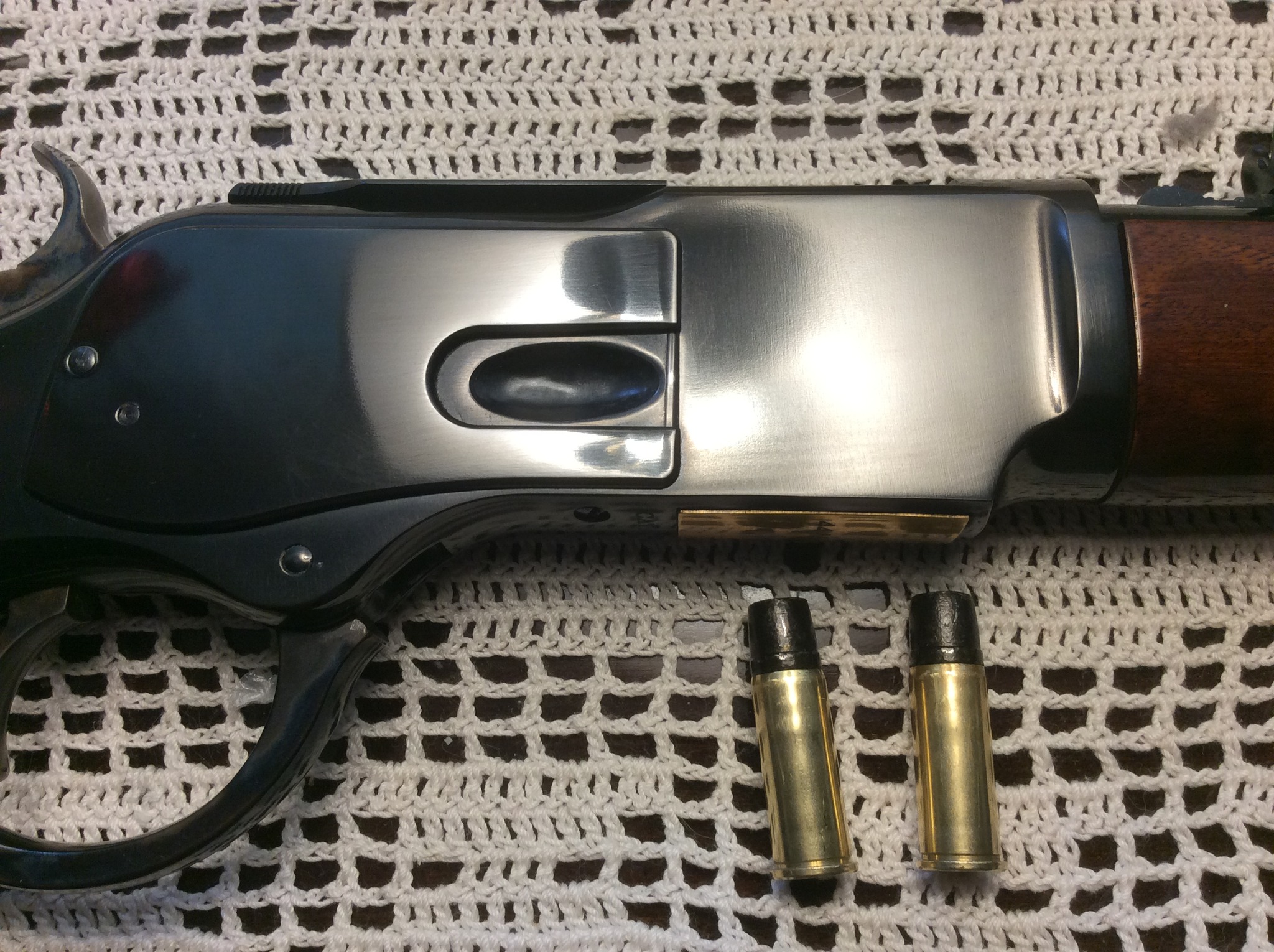

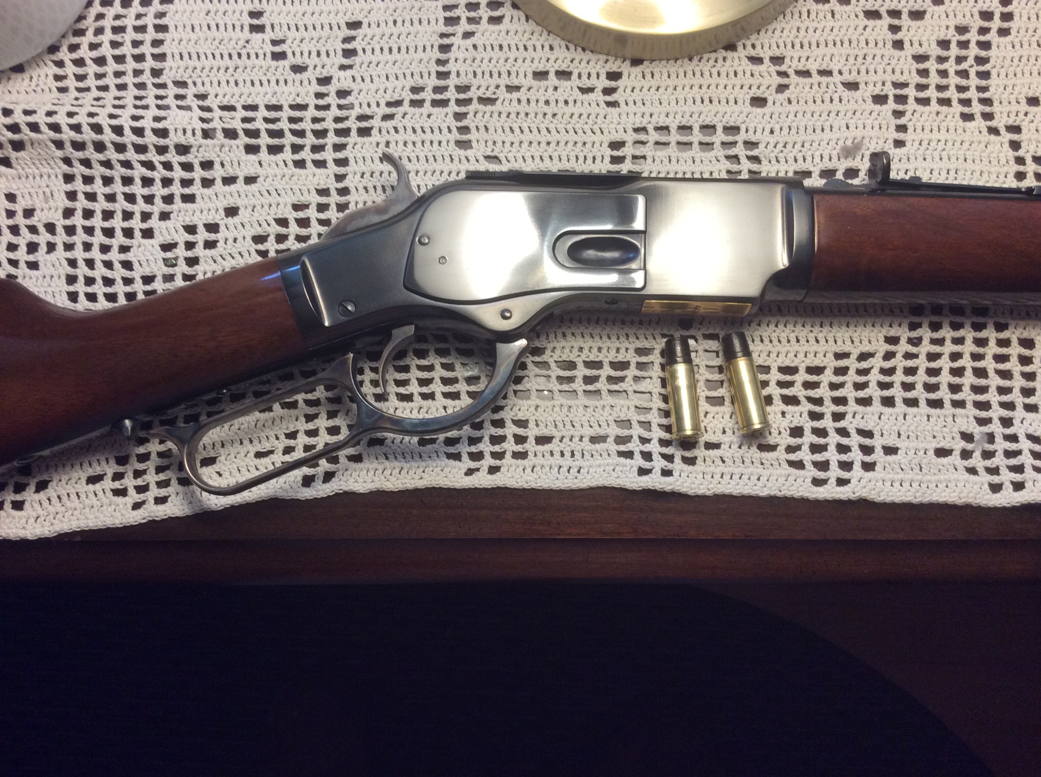

Post by fortyshooter » Sun Apr 30, 2023 3:40 pm
If you have 300 gr. 44 Mag bullets that have the crimp groove in the standard 240 gr. location this will give you a 1.700+ COL which may be to long for
some lever rifles to chamber. I load these in Starline 44 Special brass to get a nice 1.580 COL. This worked fine in my old 44 Mag Henry but was having bullet stability issues I thought was the load. This was later proven to be due to my Henry's over sized bore and slow twist rate which standard weight bullets had trouble also.
So I will try them again in my 1873 Uberti/Winchester .44 Mag carbine andat same load to start with at 11 gr. of Alliant 2400. I was getting 1160 to 1220
FPS using this load out of my Henry with 17 inch barrel and the 1873 has a 19 incher.
The couple of dummy loads I made cycle like hot butter even with that wide flat nose bullet....sweet! So more range fun/testing coming with this setup! Might even try some Unique powder and at a lighter than Magnum cased load of course.
That blue on the 1873 sure looks good!
1873 uberti winchester 44 mag.jpg (777.42 KiB) Viewed 1554 times
44 magnum 300 gr load in 44 special case for a 1.580 COL.jpg (786.32 KiB) Viewed 1554 times

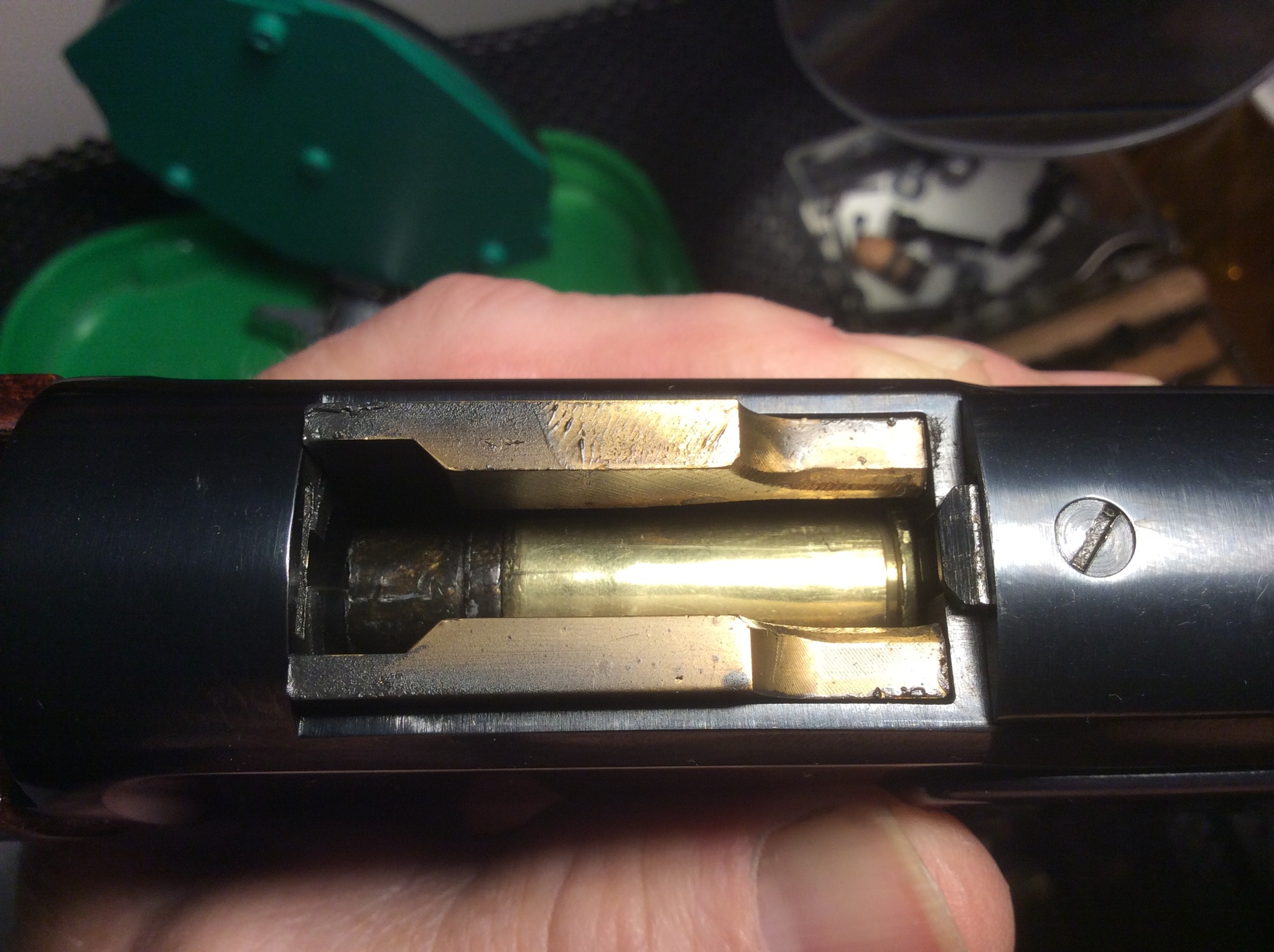

Took a picture of the 300 gr. load in the 44 Special case ready to chamber in my Uberti 1873. Not much room left at 1.580 COL.
no room for a 1.700  length   this a 1.580 44 special case with  MB 300 gr bullet.jpg
no room for a 1.700 length this a 1.580 44 special case with MB 300 gr bullet.jpg (545.57 KiB) Viewed 1548 times

Did it have any trouble ejecting that unfired round?

Post by fortyshooter » Sun Apr 30, 2023 7:25 pm
Sun Apr 30, 2023 5:42 pm
Haven't fired any of these yet but it ejects the loaded round fine.
