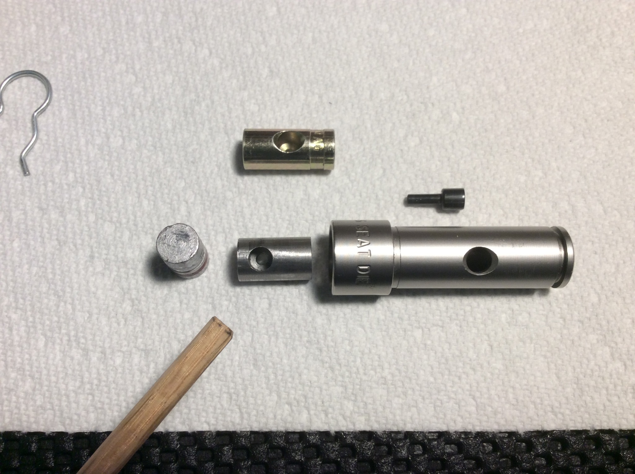

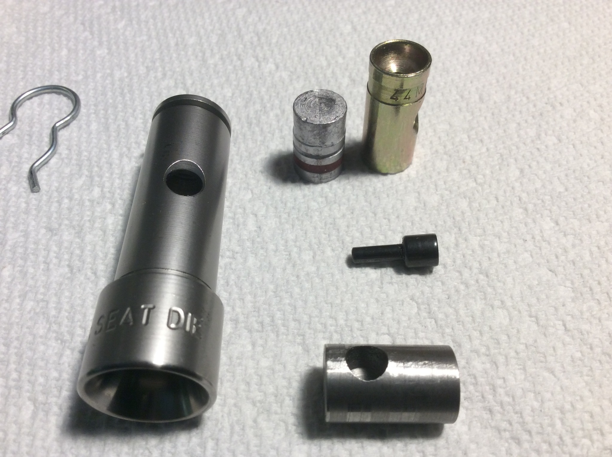

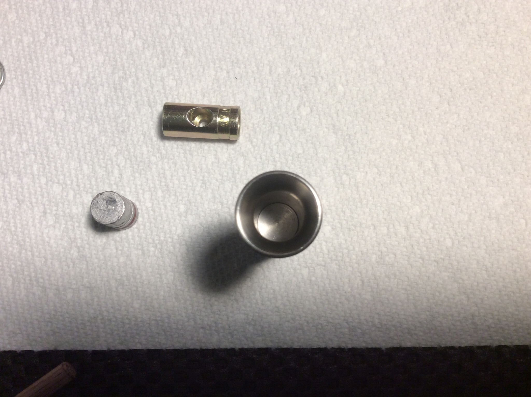

So the Dillon seating die plug for .44 caliber which is double ended would not work for a full wad cutter bullet as you would only have a very thin edge
in contact with bullet head. This would let the bullet cock around when seating so I machined up a full face one to use for these style bullets.
Sometime you have to make stuff!
had to make new seating plug for full wadcutter .44 bullets.jpg (525.81 KiB) Viewed 1278 times
dillon 44 seating die plug up top and mine for full wadcutter 44  at bottom.jpg
dillon 44 seating die plug up top and mine for full wadcutter 44 at bottom.jpg (547.83 KiB) Viewed 1278 times
die plug installed.jpg (534.6 KiB) Viewed 1278 times

You have great skill and I admire your ability to see a fix and make it happen.

Excellent work there forty. Problem solved.

As soon as I saw the post title I knew you didn’t send away for one. :lol:
Well done sir!
