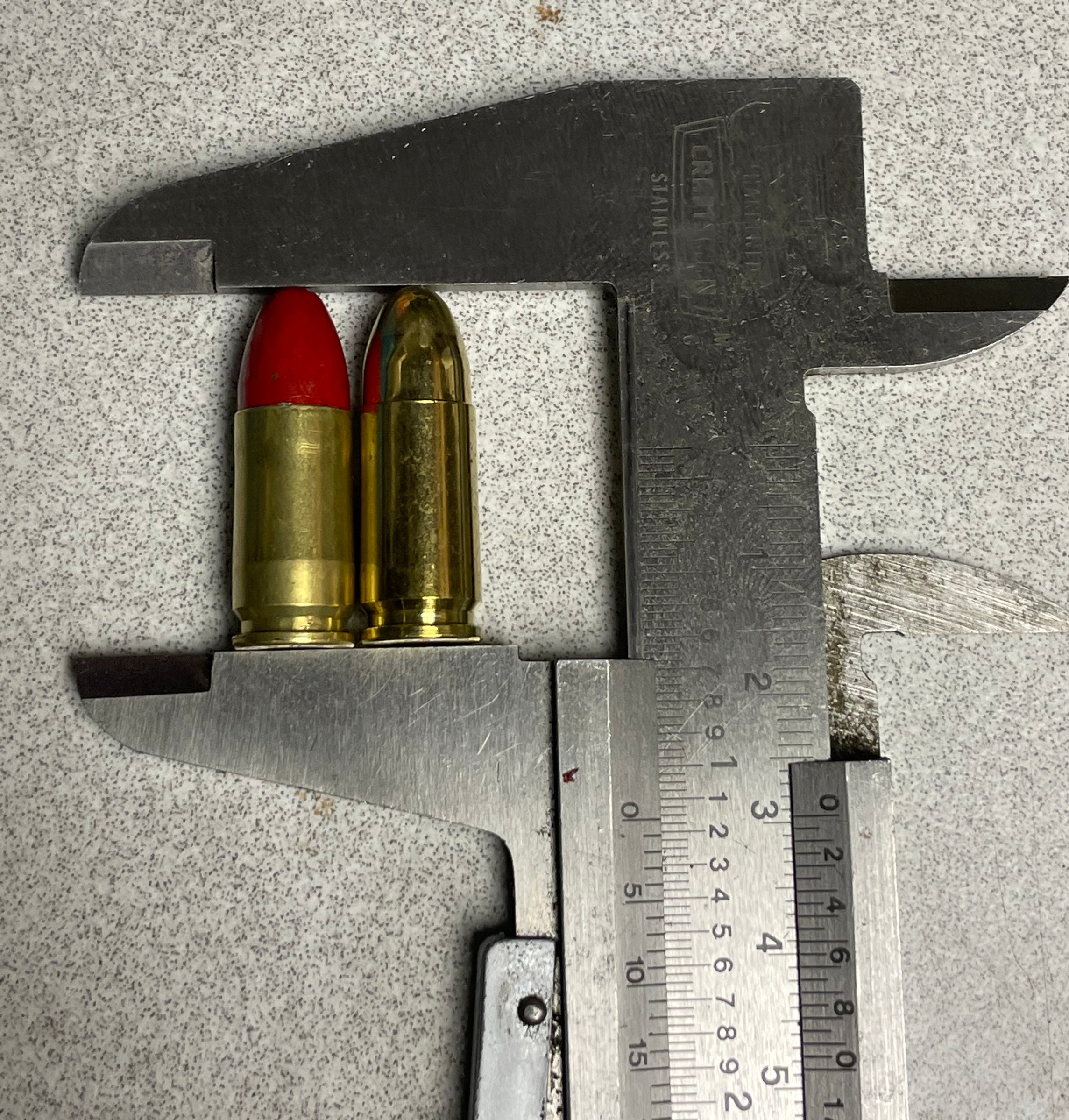

The first picture below shows the two rounds in a caliper showing their length. They both are at 1.158", which is well within the SAAMI spec. of 1.00"-1.169".

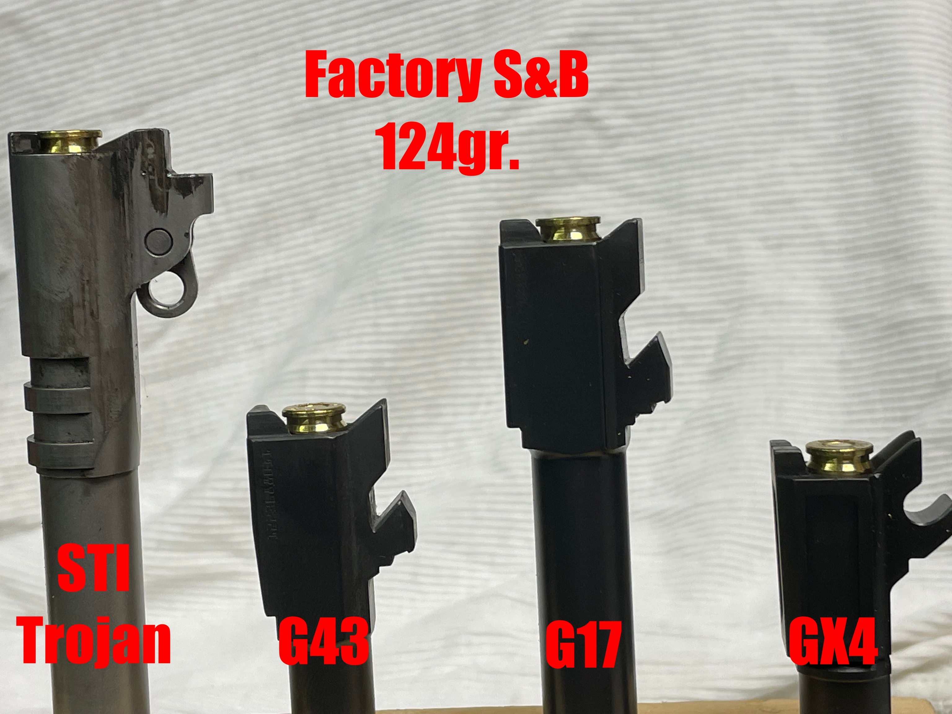

So I decided to show how these fit into the chambers of several 9mm pistol barrels. Below are 4 of my 9mm pistol barrels each with a round in the chamber. From left to right are my STI-Trojan (1911 9mm), Glock 43, Glock 17 and the Taurus GX4. This first picture has the S&B round in each barrel.

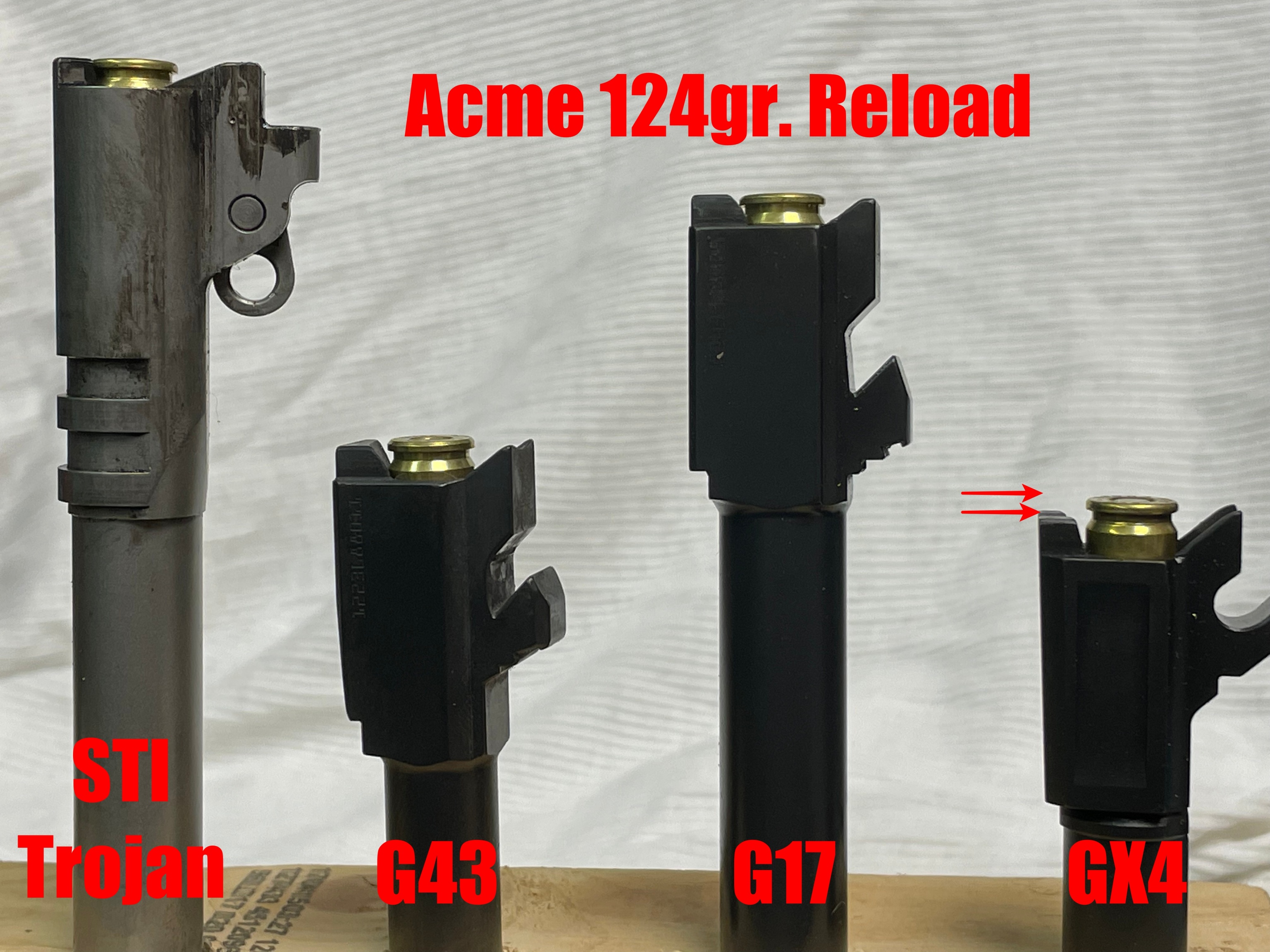

This last pictures shows the fit of my reload with the Acme bullet. You can clearly see how my reload sits proud of the chamber hood in the GX4 barrel.
What I wanted to show here is how important it is to make sure our reloads fit and function in our firearms. Even thought my reload is a time and function tested round, it's not good for the GX4. Is the GX4 a problem? Is it chambered wrong? I don't think so, since I also tried some Hornady Critical Defense rounds that functioned perfectly in the GX4. It's just that when reloading some component selections don't work in all firearms.
So what are my options. These Acme bullets are one of my all time favorite bullets. Over the last 5 years I've fired close to 9,000 rounds of these reloads. I use them for everyday range shooting and competition. Since I don't plan to change bullets, anytime soon, I'll have to experiment with seating these bullets deeper. My hope is that in seating the bullets deeper these reloads will continue to function as flawlessly, in all my 9mm pistols, as the do at the 1.158" length. I don't want to keep different reloads for different firearms. I want one size that fits all.

In your first picture showing OAL, I see more case swelling in your reload below the case mouth than in the factory ammo. Something to consider.
Re: Reloads and Chamber Fit
Good to consider all possibilities, but this is only a product of poor lighting for the photo. One overhead light can produce strange glare and shadows in strange places. Just in case this might be the problem, I pulled a dozen of the offending reloads and checked the cases with a caliper. Measured at the case mouth and just below where the bullet base would be, they measure within SAAMI specs.
The other consideration is that I use a carbide sizing die in a progressive press. Carbide dies tend to make cases like 9mm take on an hour glass contour. Wider near the case mouth to bullet base and then taper in below the bullet base. This effect may also be what you are seeing in the first photo.

This morning I put together some new reloads to test out the performance of the GX4. I shortened up my reloads to 1.115" so that the rounds would drop into the barrel chamber and fit flush with the barrel hood.
At the range loaded up the magazines fully with 11 rounds. Running the first 2 magazine through I experienced a few failures of the slide to return completely to battery. A slight tap on the back of the slide and the GX4 was ready to go. After 5 magazines this problem disappeared. I attribute this to break-in of a new gun and magazines.

Yeah, i saw that also, that's carbide creep. I'll bet dollars to donuts that is what is actually causing the case to stick in the gx4. I'd see if that load works when using a steel die.
