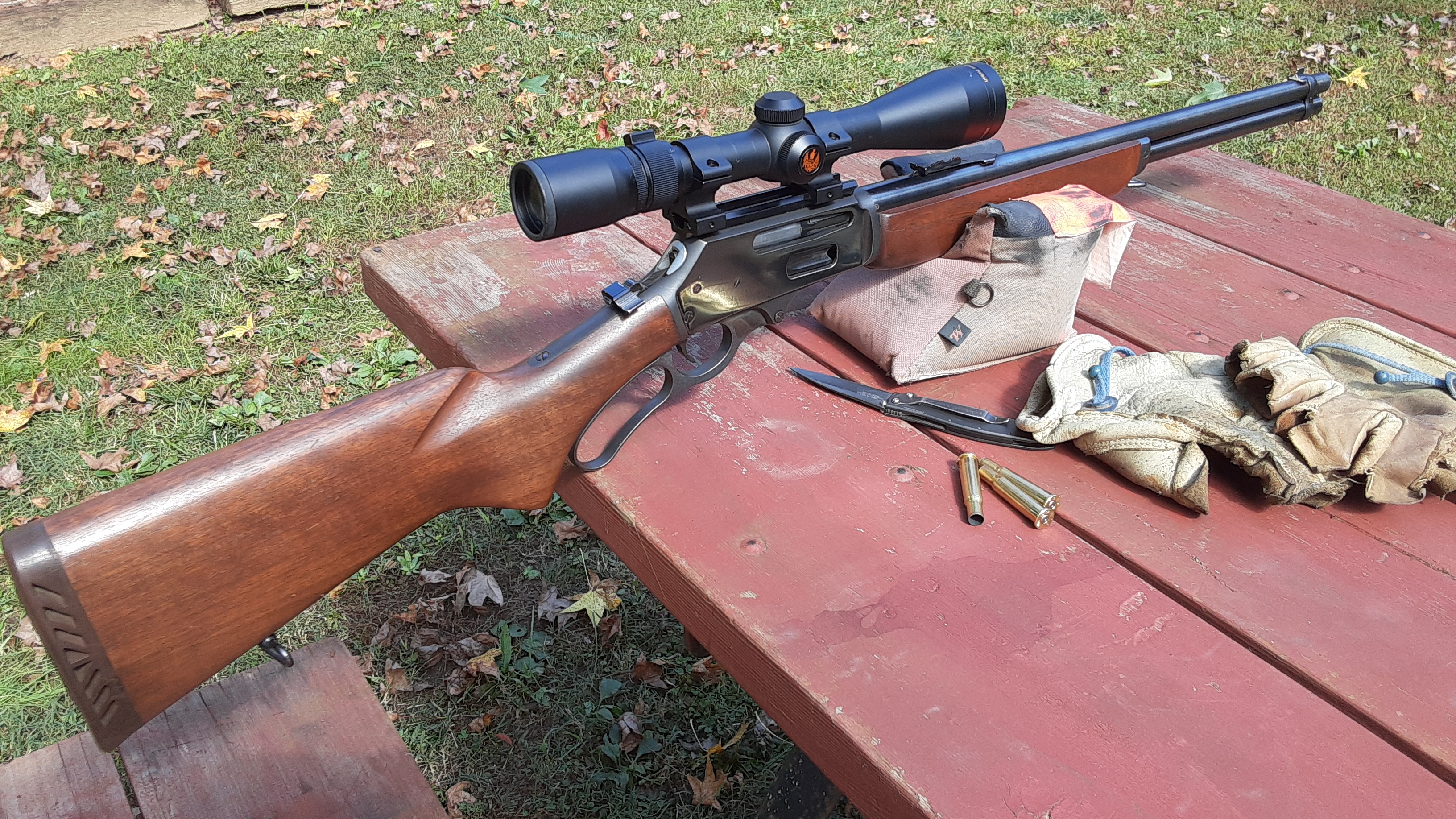

Jimmie, I don't chase velocity either, don't even own a chrony. :shock: :lol:
I load and shoot for accuracy. I shoot quite a bit of those 170 gr Sierra bullets in the 30-30's and my Marlin 308 MX.
In the mx with those I use that LVR loaded to a very near max load with some good results.
Can cover a 3 shot group at 75 yds. with a quarter.
I generally use the same bullet in the 30-30's but with IMR3031, which shows a tad better than IMR4198. ;)
I've tested the LVR in it also, seems like the best was around 34.7, but don't hold me to that. as
I'm out of town at the moment so can't get to my notes.
Believe it or not it performs well in the 223 as well.
No published data to support it, but have found it is similar to CFE223.
I tested the CFE in the MX with similar results to the LVR, and why I tried it in the 223's.
That and the fact that I have several lbs. of the LVR on hand.

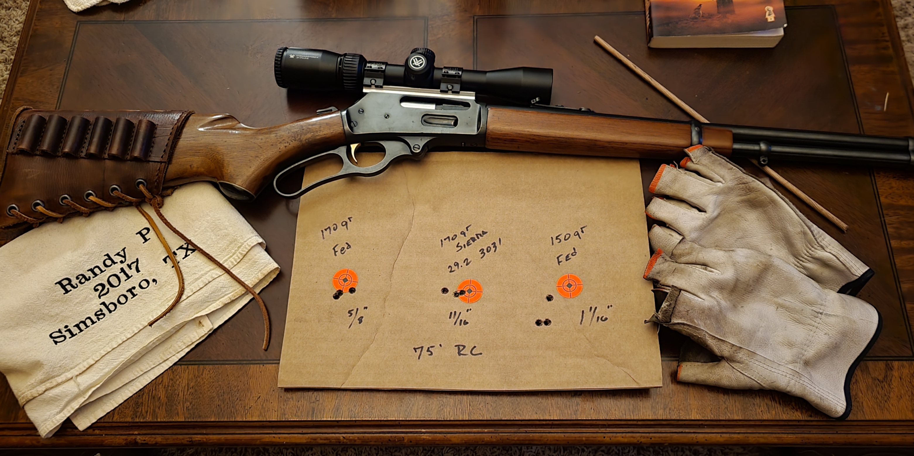

Lol, Randy or RP is just fine.
And yes some prefer one over the other, I like that 748 also.
I was given some some years back and it works well in the 30-30, and surprisingly good in the 6.5 Creed that I picked up earlier this year.
This was back in the summer I believe, a little comparison I did.

Nice shootin' there, RP!!!! 8-) 8-)
Nice groups all over. Because of the "75' RC" written on the target, were those at 75 yards, or at 75 feet? Really good groups at any distance.....
I'm thinkin' that Marlin likes 170 grainers the best? Have you by any chance tried any of the Hornadys 170s, and if so, how did they group for ya?

:lol: The '75 is the year of the Marlin, RC is regular carbine.
The distance that day was around 55 yds. as I was shooting from the picnic table in the side yard to the berm in the backyard.
Never tried Hornady's 170's as I have like 4= boxes of the Sierra's, and another 100+ Speer hot cor's that print the same and are very effective on the deer. Not knowing for sure but would think that would perform similar.
I have a store brand Marlin (Westernfield) from the mid 60's that shoots my hand loads just as accurately as that Marlin.

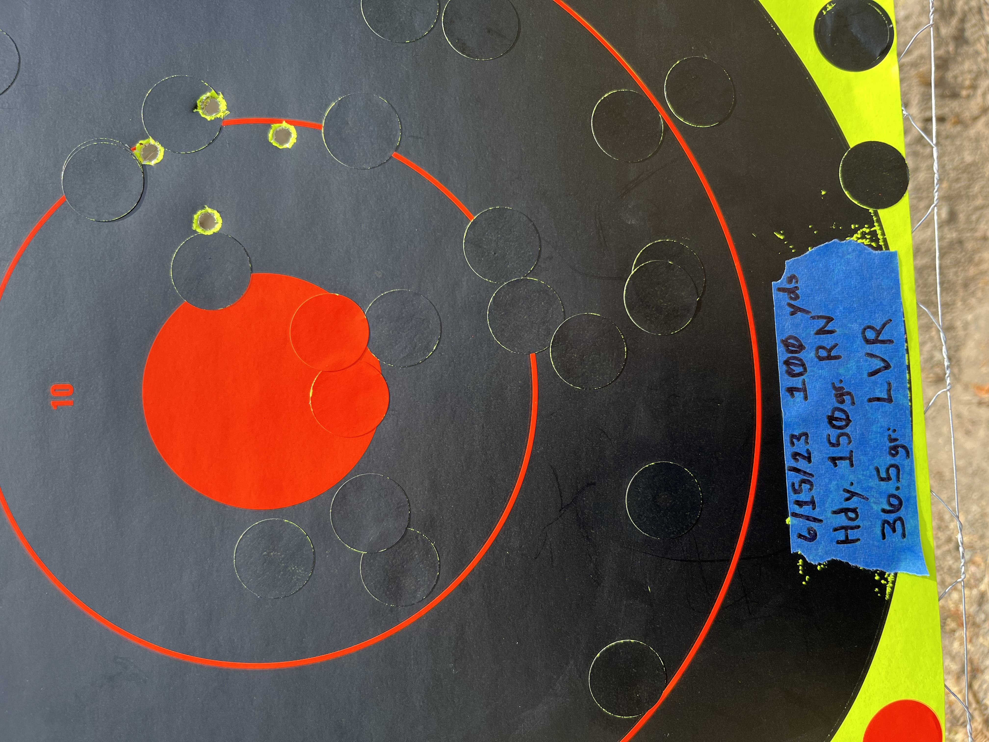

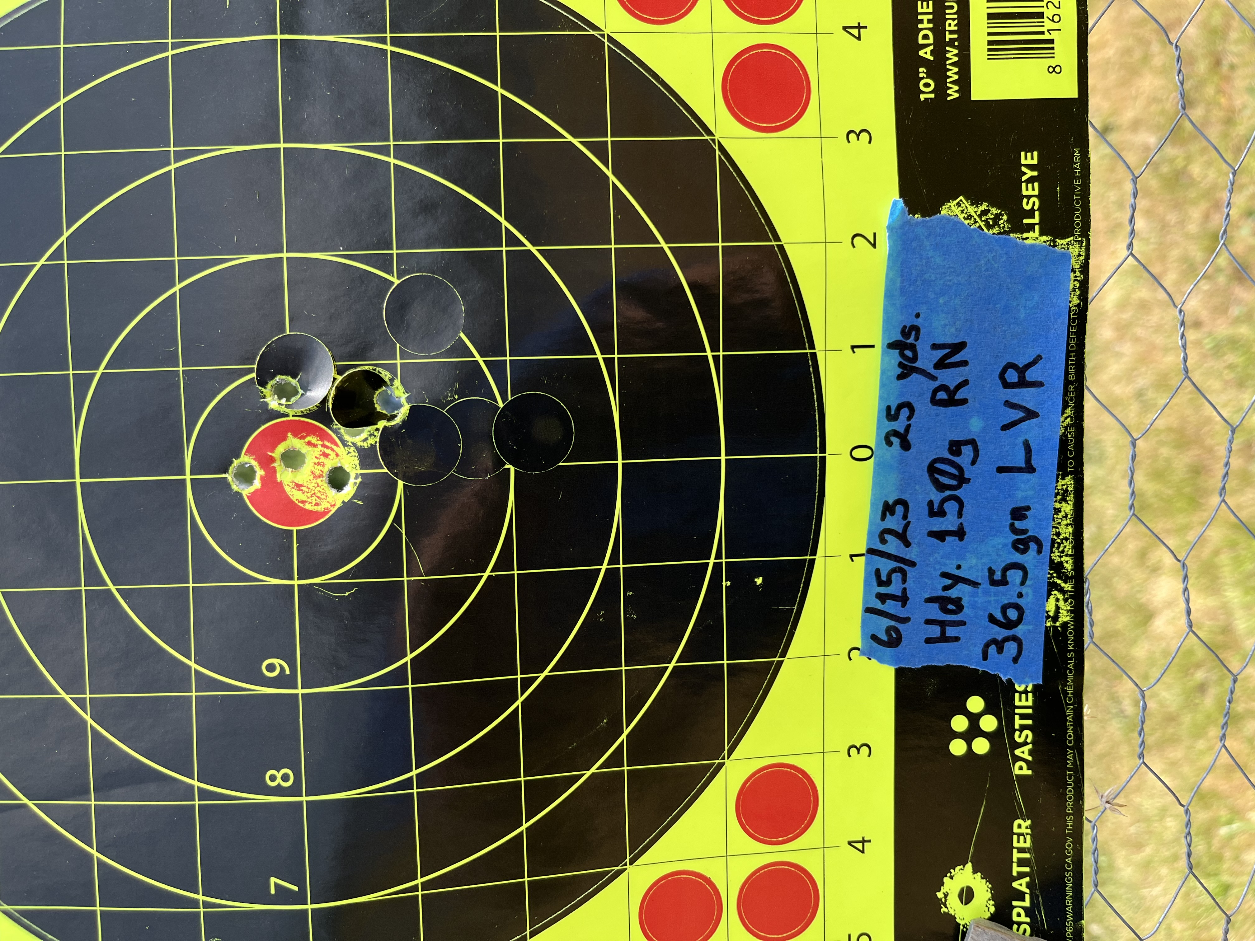

I had kinda decided I wouldn't shoot reloads for awhile in the interest of not wanting to "waste" reloading components until after I got my cataracts fixed. But the way the Dr. has the surgeries and 2 post-op appointments for each eye, the last eye won't be done until just a few days before hunting season. I dunno why I worry about this, because both of my eyes are usually shut when I shoot, but...... :geek: :shock: I couldn't keep myself away from my messy loading bench, so I broke my promise to myself to not shoot reloads for awhile. I've been playing with different powders (Win. 748 and LEVERevolution), different charges of those, and 2 different Hornady .30-30 bullets (170gr FP & 150gr RN). Hornadys are not a bad bullet at all, and they're basically all I've been able to find locally. I'd love to try some Sierra 30-30 bullets, or Speer, or maybe even Nosler. But I simply can't find any on a shelf close to home. So, Hornadys are it for now..... ;)
Short version is this:
With the bullets, powders, and components I have to work with, my "new" H009BG rifle seems to do okay with 150 grain bullets, and LVR powder. My steel H009 seems like it prefers 170s, with Win 748 at a 32 gr. charge weight.
Today's range trip netted these groups with a Hornady #3035 150gr bullet, a LVR charge of 36.5 grains, and a Remington 9 & 1/2 Large Rifle Magnum Primer. Even though I've been taught NOT to mix brands of cases, they were mixed bunch anyway, using Hornady, Federal, & Remington brass. It's all a big experiment....... :shock:
At 25 yards:
There are actually only 4 shots from this group; one of the target pasters at 5 o'clock fell off, making it look as if I fired 5 shots. I guess this about a one inch group???? :?
And then at 100 yards:
I was really happy with this group. I have never shot a better group at 100 yds. with open sights (Skinner peep in back, and a Skinner brass Patridge post up front). It measured around 1.7" with my calipers. It's a few inches to the conservative right of center at a hunnert, but that's just my political leaning there, I think. :lol:
I'm planning on loading up some more of these and hopeful it can be duplicated, or somewhat close. If so, this will likely be the recipe I settle on. And if I can duplicate these groups again, as friends and family, I want y'all to call BS on me if/when I pull the "Old Cataract Eyes/Iron Sights" card again. :mrgreen: :geek: :ugeek: :shock:

... Hornady #3035 150gr bullet, a LVR charge of 36.5 grains, ... Even though I've been taught NOT to mix brands of cases, they were mixed bunch anyway,
Same recipe here. Though I'm not real happy with the amount of copper build up from the #3035 bullets. I have a bunch of reloads with CFE223 (36.5gr) ready to test to see if that reduces copper build up. My .30-30 brass is mixed brands as well.
Good shooting results there. So no more excuses on the eyes.
