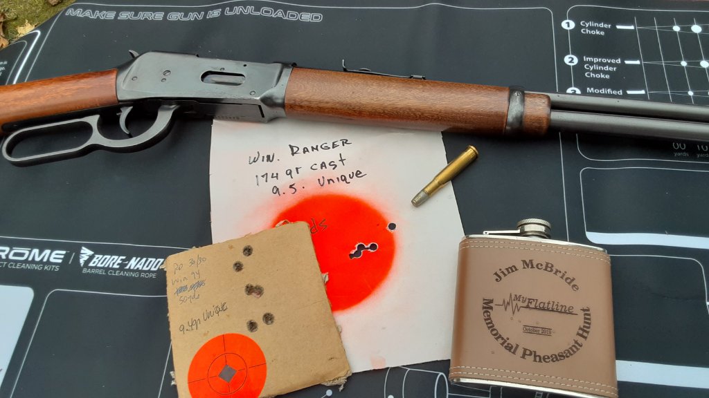

No Henry 30-30, but I do own 5 30-30's, I shoot 170-174 gr cast sized at .310.
Around 9.4, 9.5 grs. of Unique shoots really well in on Winchester and a couple of the Marlins.
But to really know what any particular will shoot well, you need to slug the barrel to know for sure.
Both targets were 50 yds. Tha cardboard target was down in Fla in 2018, the other was last Fall here at home.

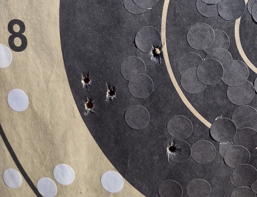

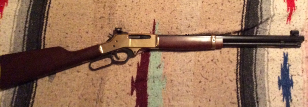

This is the last group I shot off a bench with my brass Henry 30-30. Lee 170 fp, gas checked and tumble lubed with liquid alox. Sized .309 over 26 gr. 748. 200 yards. The whole group fit under my fist, and the 3 shot cluster is about the size of a quarter.
