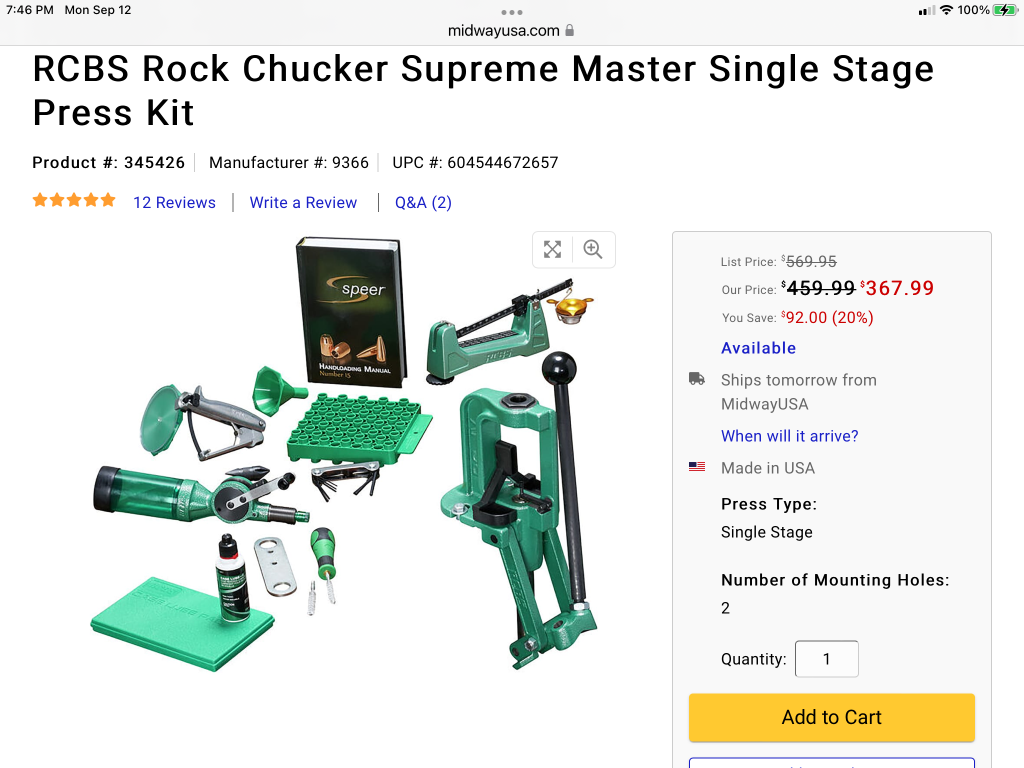

Start with 1 caliber, that sounds like the best advise I’ve been given to date! I’m thinking for safety 38’s because I know the H012 is chambered for 357 mag. Starting with pistol caliber, learn how to reload them take on trimming once I feel more comfortable.
I’m not looking to churn out thousands of rounds so I’m thinking a single stage is a great starting point and why not a used one.
Thank you all for the comments, I read all the posts here and see there are many reloading.

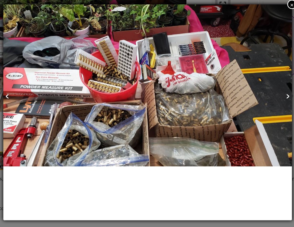

I actually have this one saved, planning on heading to a friends to do some reloading with him at the end of the week to make the decision to jump in or not. Dies, kits, tools, material and time all add up. As long as I can get the materials there is never a shortage of ammo.John E Davies wrote: ↑Mon Sep 12, 2022 10:44 pmeBay has reloading stuff, but you have to watch out for shipping, presses especially are heavy. This comes with.38 Spl and 9 mm dies: I really like the Lee dies.
https://www.ebay.com/itm/295211780979? ... ondition=4

Re: What exactly is step 1?
Not sure if its good or bad but we are in now. Found a Lee Progressive press blemished on a nationally reputable website and ordered it. Digital caliper, digital scale, bullet puller, stand, lube/wax and a set of dies for 357/38 special. I'm not looking to make that much, maybe went to cheap on the press but didn't really find any terrible reviews. Loaded 9 on a progressive last night and felt slightly overwhelmed but regrouped this morning and started looking high and low tools to start. Updates to follow, and I'll be on the "reloading bench" thread soon!
Before I bought a powder measure, I would buy a set of the Lee powder dippers. I started loading in 1969 and my powder measure sits unused in a drawer. I use the dippers after checking them with a scale and they are a lot easier and quicker than loading a powder measure and then emptying it when I am done. Also I can switch powders easily.
