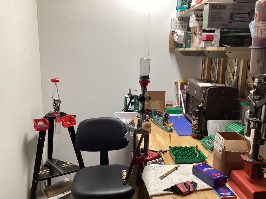

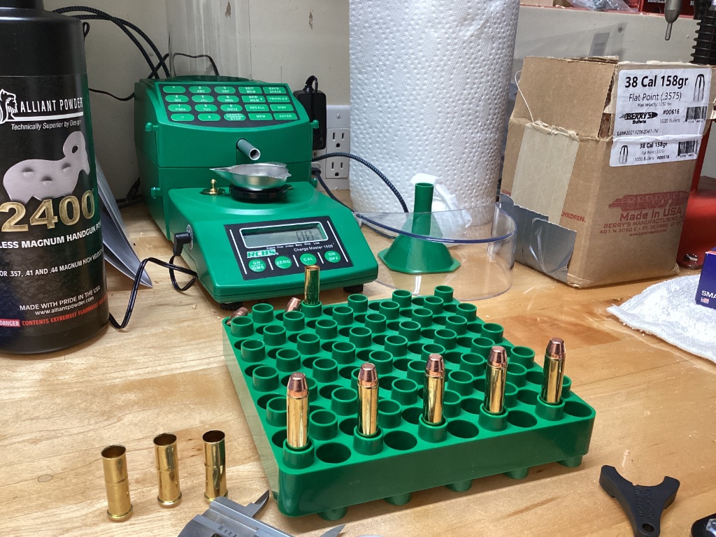

Got my things together to load some 357. Set my dies according to lee instructions, set up the powder measure and double checked the drop on digital and beam scale.

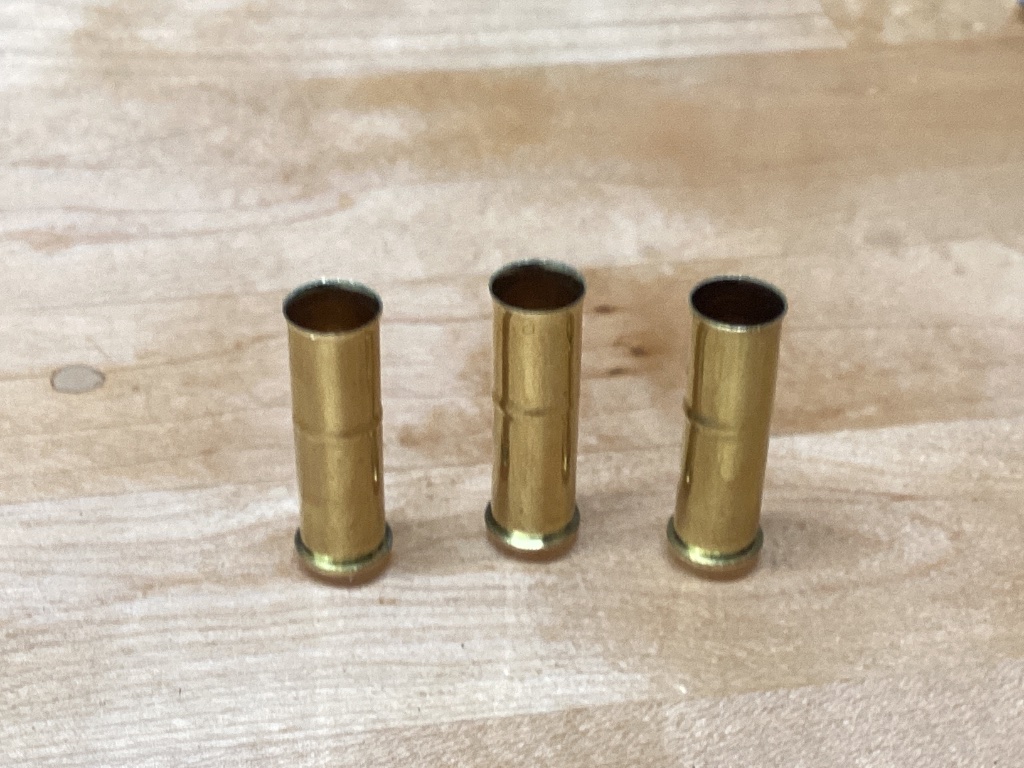

Sized casing, installed primer then flared casing and dropped powder. Mangled case,
too much flair so I raised die and tried again. Set bullet, checked COL (1.588) then crimped.
Guess I am set to try these 5 out. :D My big question is what do I do with the 2 cases that are damaged and have a primer installed?
Thanks in advance for your help.

Put a drop or two of oil in the case then squish case with pliers, toss. From what I can see Ernie, things are looking good. Whats the powder charge?
You have a lot of very good equipment there on your bench. Well done!

11.4 gn 2400.
I have been gathering stuff for a couple years (so it wouldn't hurt too much), until I had the time and space to use it.

Ernie, where did you get your load info from? And what bullet maker?

Nice setup Ernie especially that Kennedy Toolmaker/Machinist box! I have one just like it....and almost 50 yrs. old!
Do you have a chrono to check bullet speeds? I have a nice collection of loading boo boos too!

Got the load information from Lyman as a starting charge and I am using bullets from Berry's.
