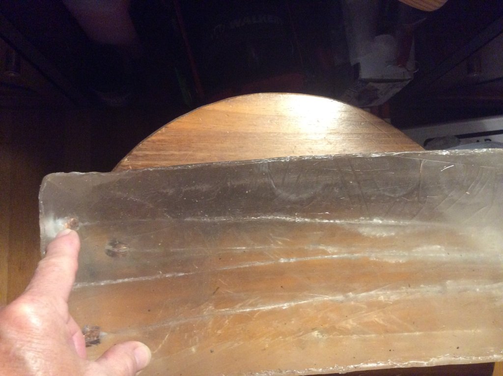

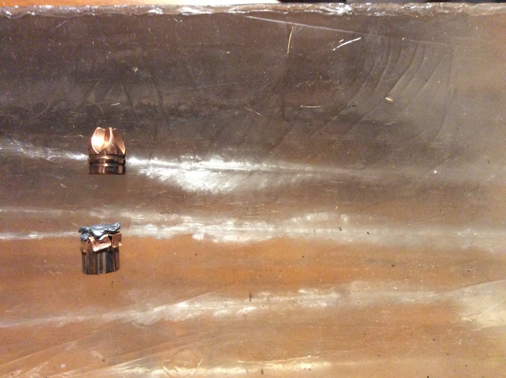

I tried those in the lighter weight for speed increase at near max load and the gel block did not show any massive wound channel. The 230 gr. XTP bullet did just as well and cheaper to buy. You really need some speed behind those trick bullets for them to work.
I figured in a very short barrel application like my 3 inch Bond Arms derringer the Lehigh bullet would do more damage at 1100 FPS compared to the slower 230 XTP bullet. Well as you can see not much difference at all in the gel block. I will stick with the 230 XTP bullet in this application.
Now in a rifle the 120 gr. Lehigh might show more damage at higher speed. Might try that test next time.
