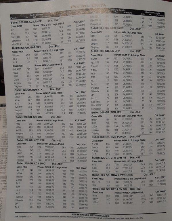

No help here either, I've never used it period.
Looking in a new Hodgdon manual, the only mention of Longshot is in the Ruger only section that I'm seeing.
Re: 45 c and Longshot subsonic load data suggestions
Posted: Mon Apr 25, 2022 6:19 pm
by Vaquero
Here is what I found.

Remember, your Rossi is somewhat stronger than a Colt S/A which is the standard for published data. I personally think that LongShot will likely give you near transonic velocities. Hodgdon published data (Ruger/TC data) shows a 300gr Speer JFN from a 7.5"bbl with 11.2gr LongShot giving 1,005fps. Max is 12.5 for 1,136 which is well above supersonic. Too fast for your purposes. But it gives you the picture of how much leeway you have.
My favorite in a 45C BBS (20 inch bbl) is a 405 grain .458 coated lead flat nose sized (via a Lee sizing die) to .452 loaded with 9.6g TrailBoss with an OAL of 1.645" and a firm crimp for about 1010 FPS.
